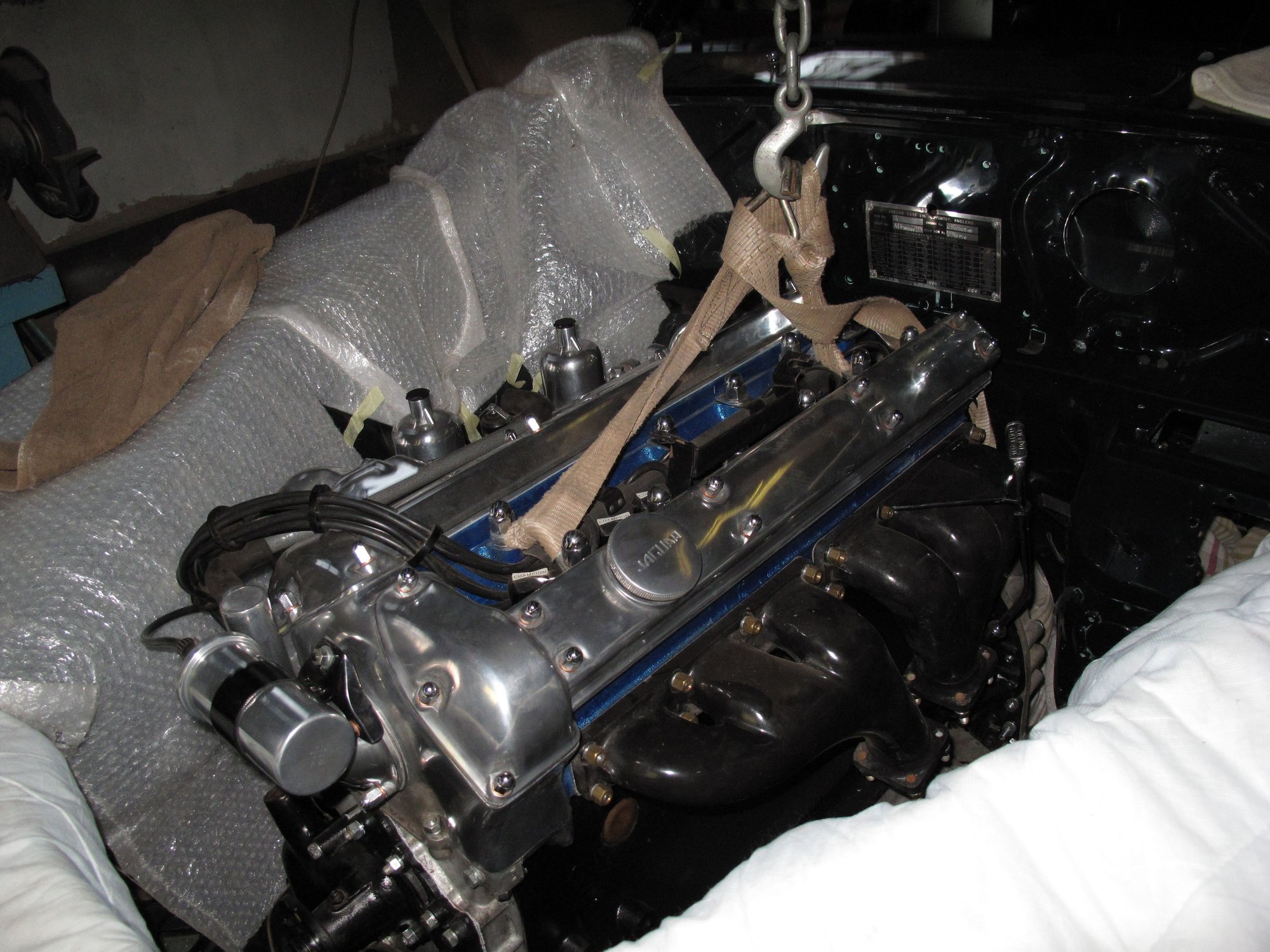

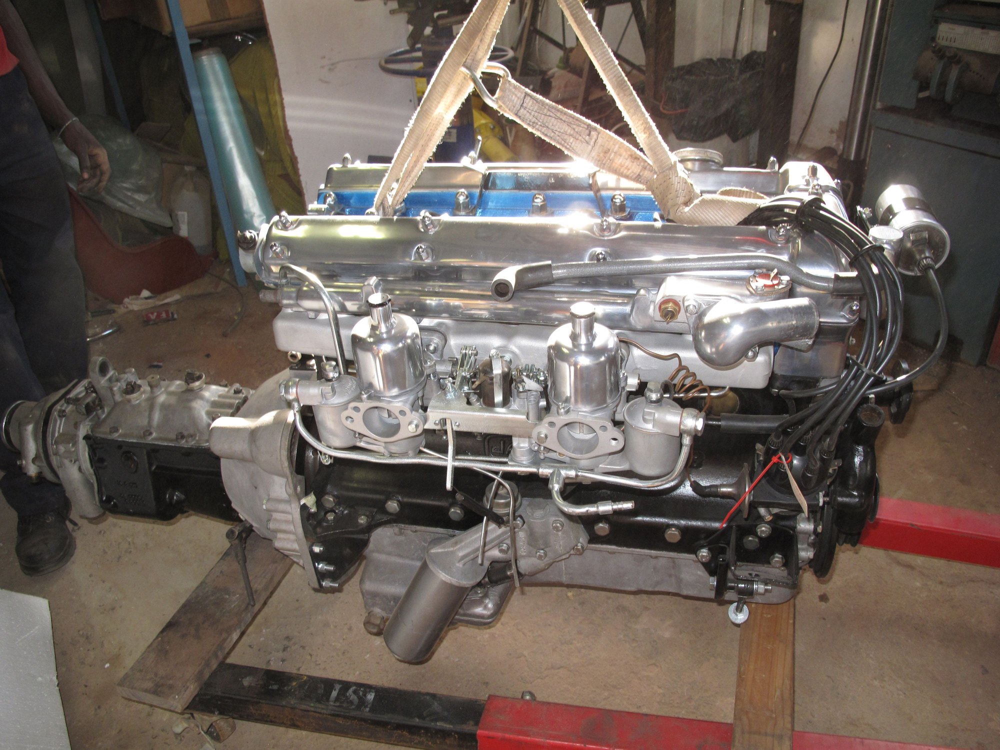

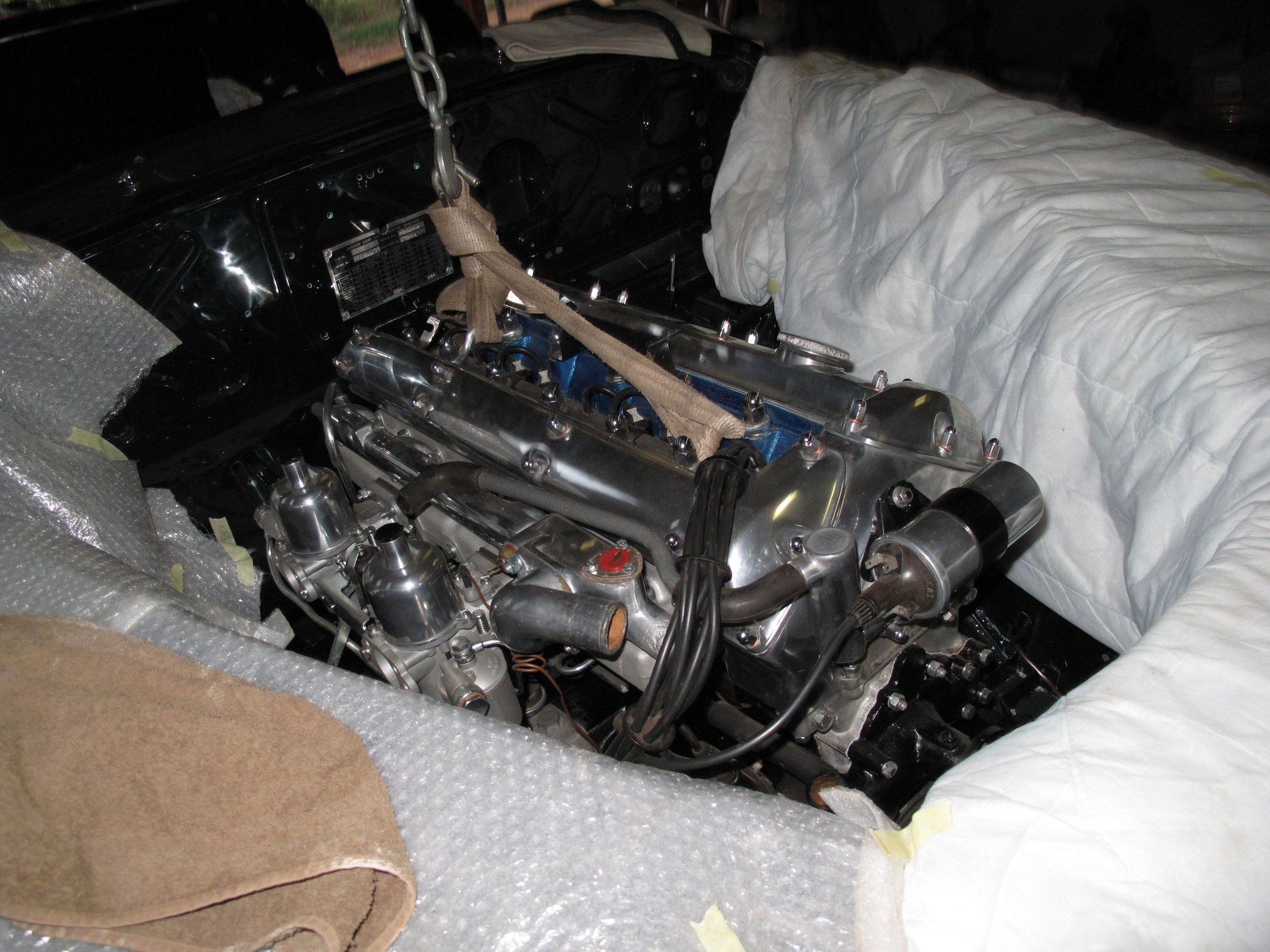

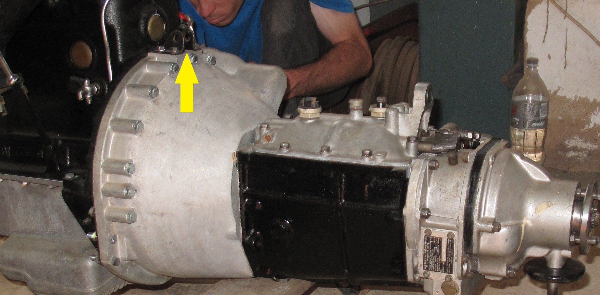

This is how we put the engine in. And then popped the vertical stabaliser rod in afterward with the one horizontal bolt at the bellhousing brackets & all the top bits required to attach to the scuttle/firewall bracket ~ both below it & above it. We had no difficulty other than working in the confined space. It was certainly not a major problem.
We had one under the car controlling the tail shaft from bashing the newly painted scuttle ~ one driving the hoist & me acting as ballast on the hoist to ensure no tipping. We were at the hoist's limit. No pictures at 45 degrees. We were all busy.
BTW ~ The car was standing raised on jack-stands & not it's wheels. Extra space under the vehicle is a big help coming in from the top. We had a full hoist available but no engine crane that would work with it.

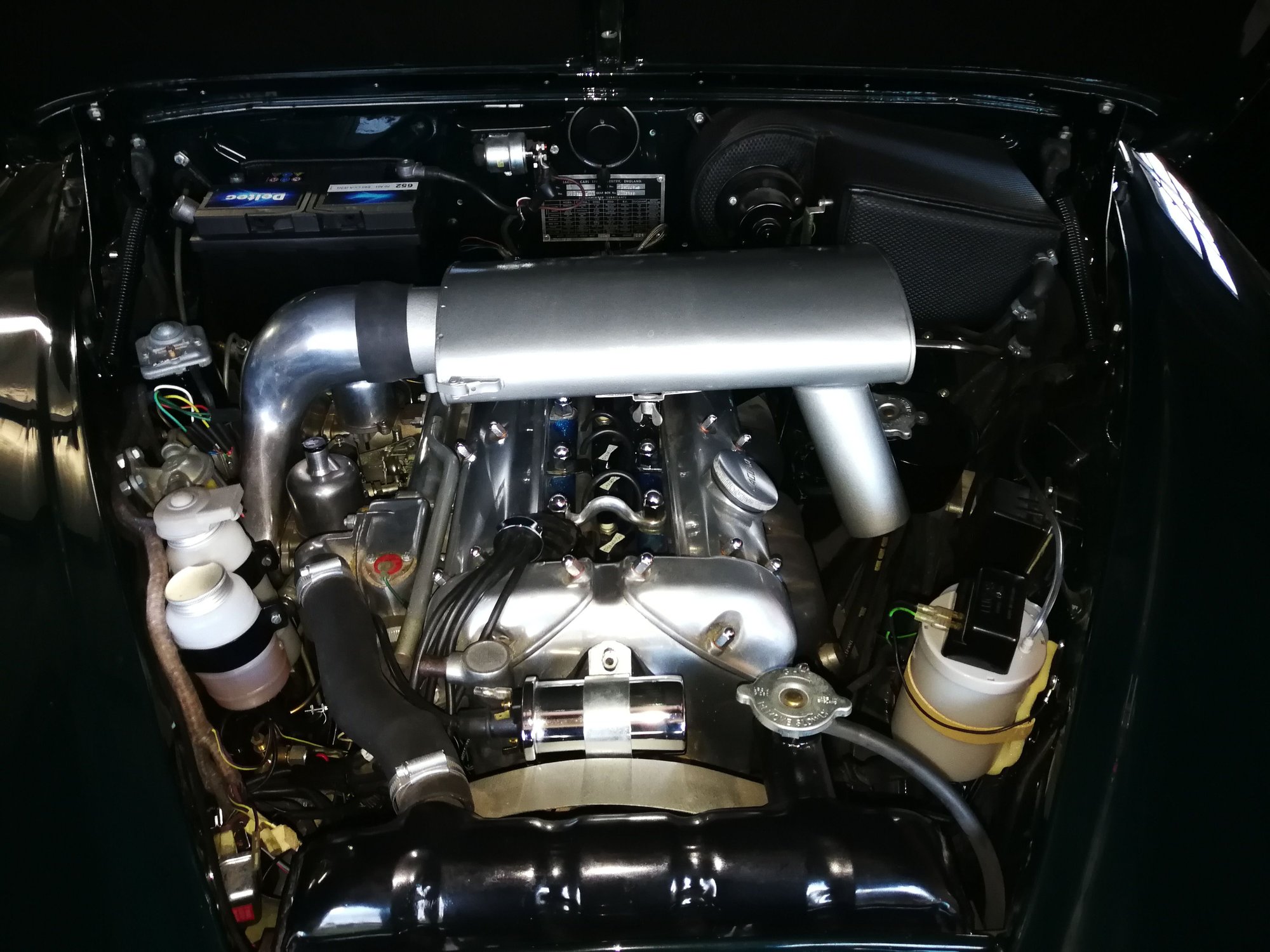

During assembly. Many things still to do & coil changed etc, (Don't consider all correct yet. It's not) Stickers still to be attached. Wiper bottle orientation wrong, breather still to be attached with rubber elbows & correct clamps etc. Excuse dust everywhere. This is Africa.
