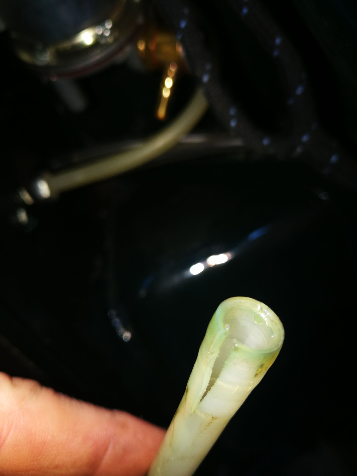

Jagman, Somerset West, Cape Town (Gerald Williams) imports his SU Rebuild kits (jets, diaphragms & all) from Australia at a price more reasonable than Burlen. Everybody here uses them and he has not had a single complaint. I turfed the boxes in the trash and don't remember the Brand. It's a while back now. They tolerate the 10% Sasol fuel alcohol in our highvelt fuel with no issues. I'm now out of the alcohol fuel area. We have our own refinery in Cape Town from crude & not coal gasification based fuel from the Sasol process.
What doesn't tolerate the alcohol is the pipework sold as "the right stuff" by many (which I suspect is PVC as Peter has mentioned). The genuine original Nylon tubing used by Jaguar tolerates alcohols very well.
My car after 2 weeks of Sasol fuel alcohol.
