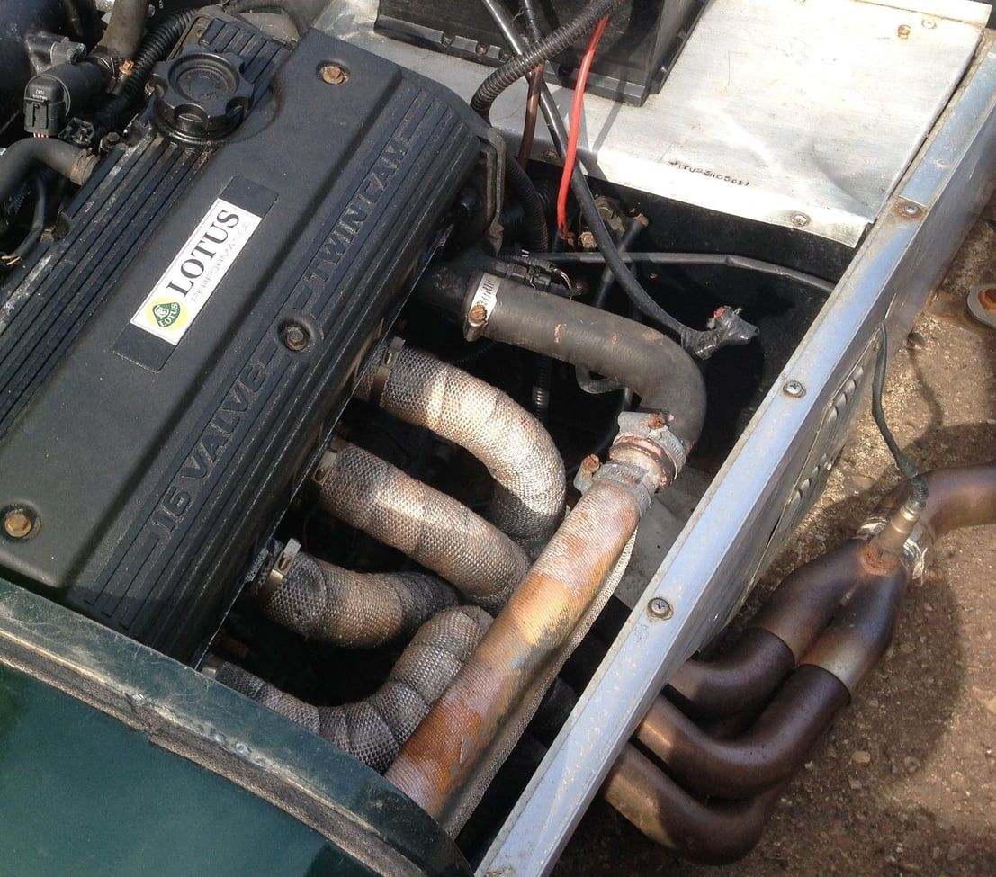

This is what Cass did to his Lotus & it made a big difference. We use rope heat wrapping in SA.
