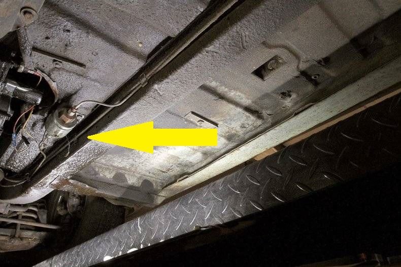

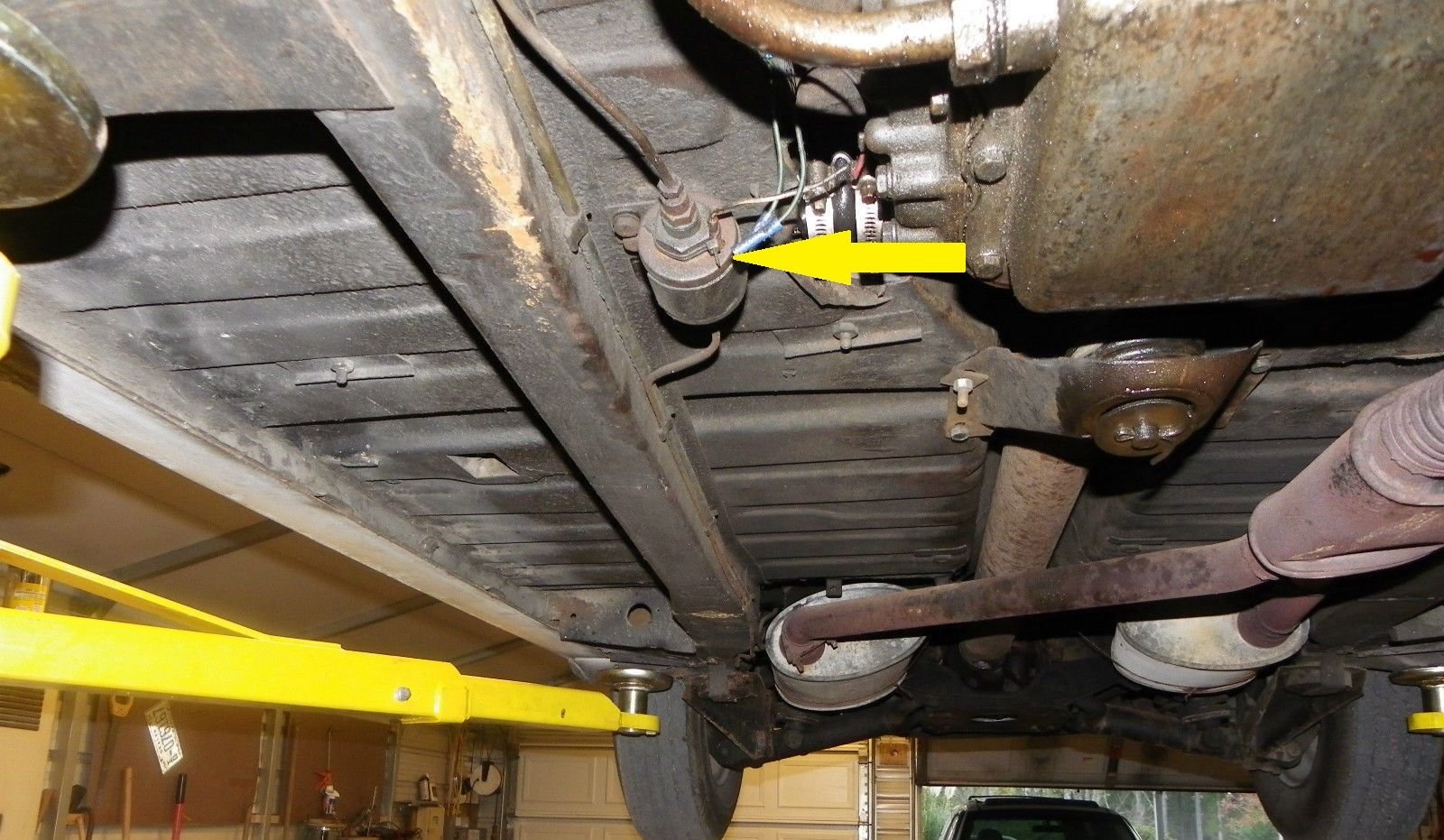

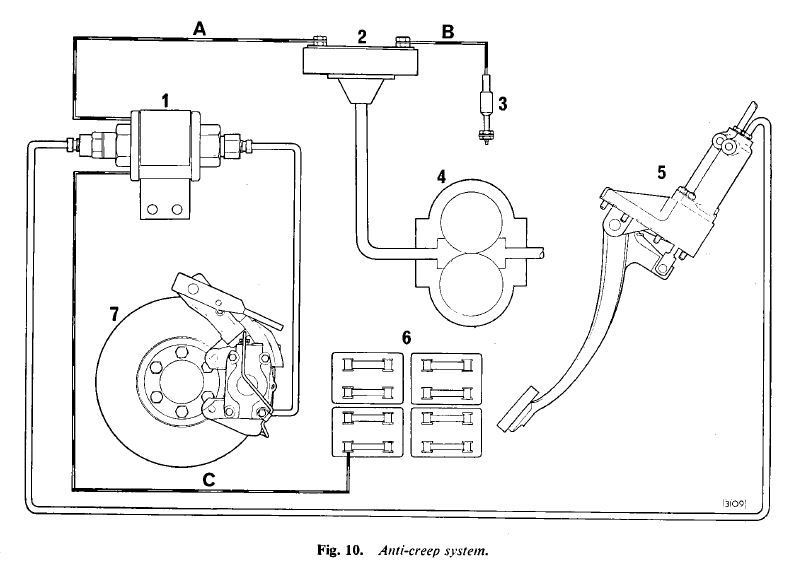

You might have a duff inline anti creep brake solenoid or circuit that is fitted to all automatic S Types (DG, 35 etc.). At idle in drive the car applies the rear brakes until you push the throttle. You will find a throttle switch on the carbs, The solenoid is supposed to release the rear brakes as you pull away. Also acts as a hill holder. They don't hold full pressure forever which might be why the rear brakes finally release. I would check out the entire circuit & the solenoid/valve.
Anti Creep Solenoid on rear brake line.

Glyn my September 1967 built S Type with a BW35 Auto box does not have the anti creep. Not sure when it was deleted possibly with the fitting of the BW35 box. As Lyonsfin's car is stated as a 1967 S Type so it might be an early 67 or a 66 built car with the DG250 box which was fitted with the Anti creep so you could have hit the nail on the head. Good shout.
Old Aug 2, 2020 | 07:36 PM
Glyn M Ruck's Avatar
Posts: 5,546
Likes: 1,495
I'm sure I've seen a car with a 35 with the anti creep. But the transmission could have been a later fitment by the owner. Also strange things happened with late cars as they did with 420s/Sovereigns. It's all I could think of with an auto that would display those symptoms. I'm used to Manual OD's
I've also seen a US JCNA Concours winner Manual OD with an anti creep valve fitted. Go figure.

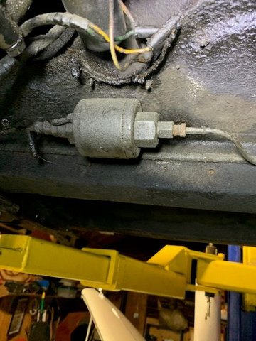

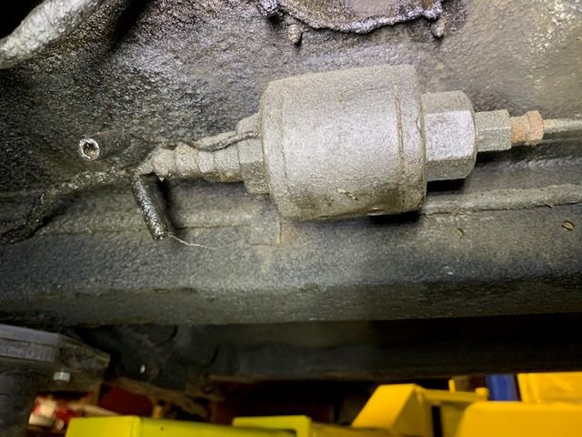

Default Solenoid there
Solenoid is present but the wires are NOT connected. Does this mean it is "bypassed" or might the issue be with the valve itself? I did not check for switch, but my guess is that the switch wasn't working properly and that is why it was disconnected.

If the valve is electrically disconnected then it shouldn't be doing anything but its possible that its faulty internally and jamming the brakes up.
The first thing is when the car has the problem to investigate where the problem lies, the issue is that if you just start altering things then you won't know if the problem was actually fixed or whether it just went away to come back at a more awkward time.

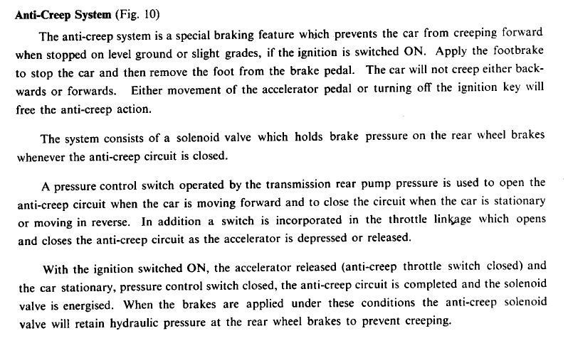

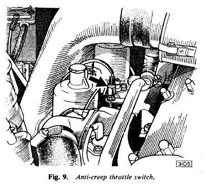

If you have no intention of restoring the anti creep system to good health I would remove the solenoid valve from the circuit & replace it with a solid pipe. We have no idea how it is reacting to fluid movement/pressure at this time. While about it I would also replace the flexible jumper hose from the car body to the rear axle assembly. As I understand it in it's present state the solenoid valve should not operate & impede the brakes but we don't know what is happening if the valve is faulty internally. I can find no diagram of the valve internally.
Download & blow up if necessary. All can be found in Section FF of the workshop manual under Automatic Transmission ~ NOT Brakes.
Another thing that comes to mind is that the auto adjusters in the rear caliper pistons might be damaged. But if so I don't know why the rear brakes would ever release.
