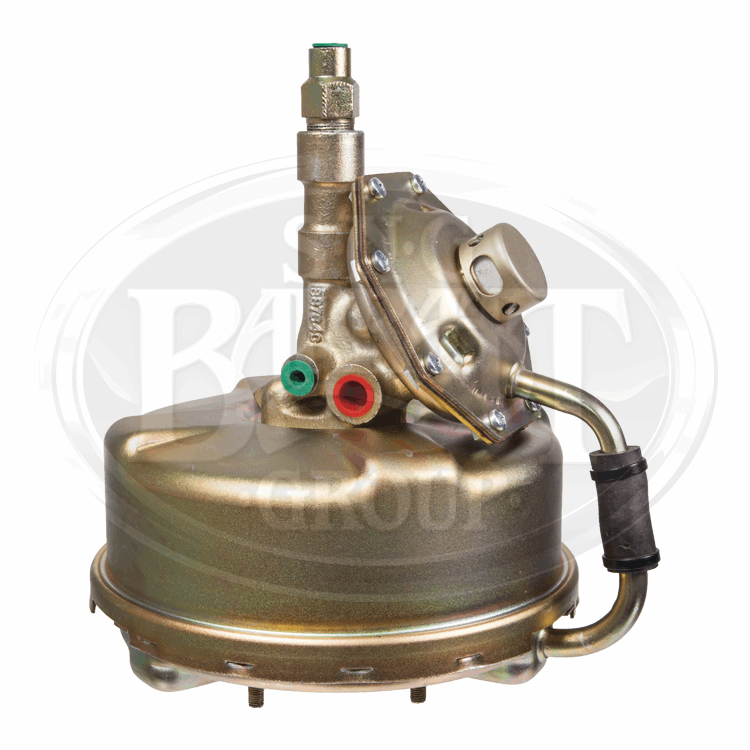

Then lastly the servo, you can rebuild it yourself, or there is a new unit that is available, but it just doesn't bolt in, plus they have had problem with it, it has a tendency to hold the brakes on just like what's happening to you now, even on new units.

I appreciate everyone's ideas and suggestions. Thank you. I am pretty good with brakes, but not so much experience with the vacuum servos. I have examined the barking system and I don't think it is the flexible hoses or the MC or calipers. Issues with those items are relatively straight forward and not related to heat. So, I am going to focus on 3 things:
1) Brake fluid is hygroscopic. If there is excess moisture, perhaps it is vaporizing with the heat and creating excess pressure locking the brakes on til it cools. Kinda like a brake system vapor lock
2) The brake servo or check valve is faulty and the excess heat create excess pressure on the system.
3) There is actually vapor lock and it is creating an over vacuum situation with the b=rake servo/booster causing the brake locking.

Sorry. We posted over one another. Yes brake fluid is hygroscopic & high H2O levels will reduce the boiling point of the fluid until it boils at the calipers & you loose braking efficiency or total brakes.
I would do a full rebuild of the brake servo. Don't mess around with brakes on a car that has single circuit brakes. At least with dual circuit you don't lose total braking & don't rely on Jaguar handbrakes in an emergency.
Barratts offers a rebuild service at a price which is what I did & it came back looking as new. They also offer cheaper replacements at lower cost but require some minor re-jigging of the pipework. Otherwise you can do your own rebuild. Well described in the service manual. Rebuild kits come and go. Sometimes available. Sometimes not.
I find rebuilding brake boosters/servos a PIA if you don't have all the gear. e.g. if you have to re-sleeve the cylinder.

It looks like you are in the US, so you might want to contact "White Post Restorations" for a quote as well. Servo rebuilding is listed as one of the services performed. Back when I was "in the business" our shop used them quite a bit on caliper rebuilds for classic Jaguars and their work is outstanding:
