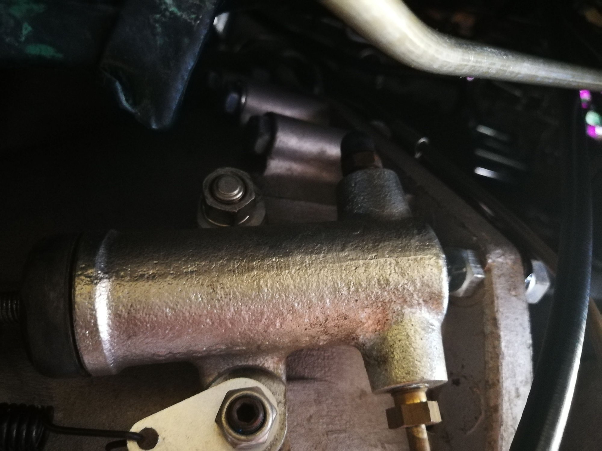

2) Will the flywheel be drilled for both clutches? ~~~~ MANY FLYWHEELS ARE DRILLED TO ACCEPT BOTH BUT NOT GUARANTEED (mine is)
4) Should the 3.8L short or long slave cylinder be used with the 10" clutch kit? ~~~~ THERE WERE 3 SLAVE CYLINDERS P/Ns FITTED ~ I"M USING THE LONG (95mm) HYDROSTATIC CYLINDER PLUS THE EXTERNAL SPRING AND ADJUSTING TO PREFERRED TAKE POINT WITH ZERO ISSUES ON MY DIAPHRAGM CLUTCH on my 3.8S. THE SHORT CYLINDER IS 80mm & typically used with the 10" coil spring pressure plate. I find neither of the Service Manual adjustment procedures ideal. I suffer no heavy clutch pedal complaints that were common with the coil spring pressure plates.
If you start messing with different slave cylinders then rod length from the yolk clevis pin to slave cylinder has to be considered.
