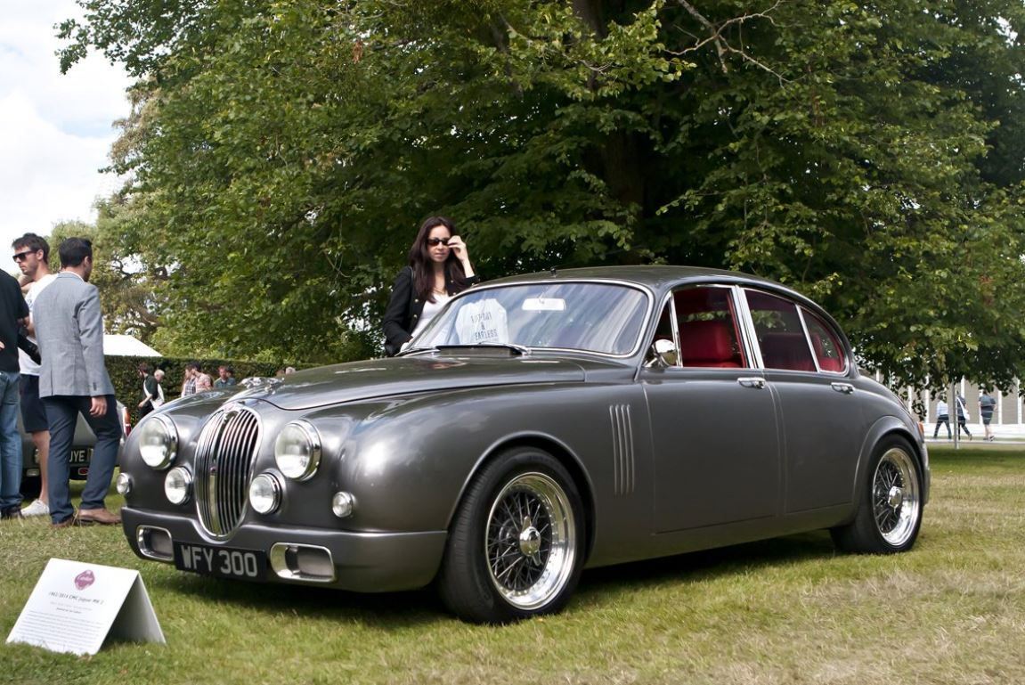

Have you had a look at the Ian Callum car. Nice colour. I particularly like Jaguar Gun Mettle Metallic Grey from the mid 60's. (not the same as the Callum colour)
BTW ~ if you don't have the paint code with the Glasurit system you just put a spectrophotometer on the color you like & out pops a perfect match.
Will look for a pic for you. You might like lighter, darker or different. Your choice obviously.
Callum car

Callum's car is beautiful. Interesting choice of his to reduce the chrome trim. Also like the relocation of the fuel fill. The color may be a bit dark for me as light colors absorb less heat in this unrelenting California sun.

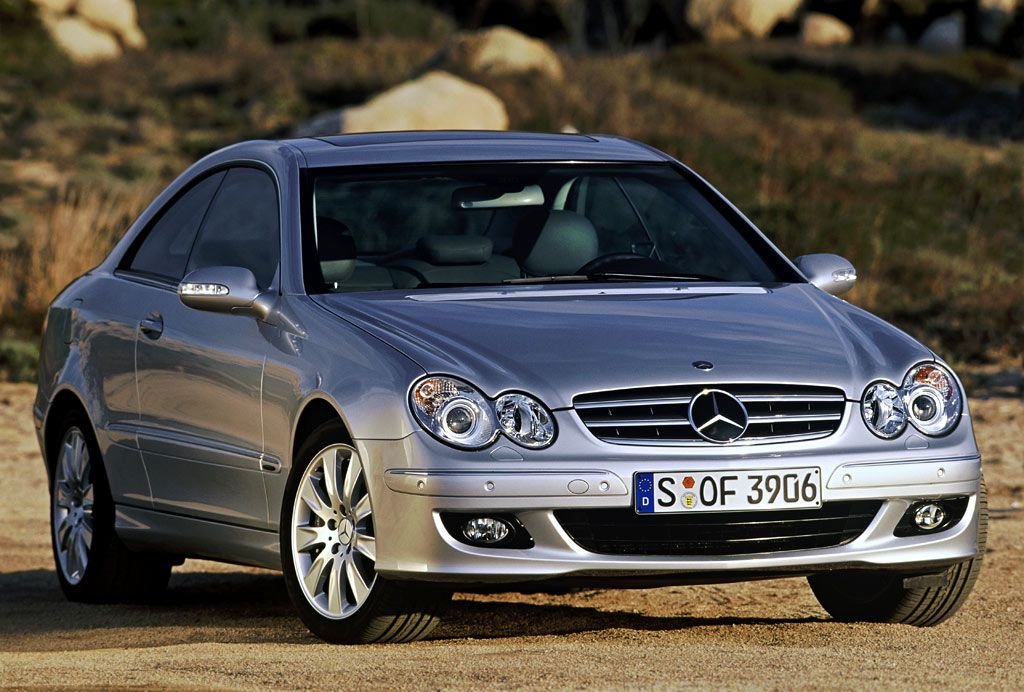

Understood living in Africa. Iridium Silver is light & somewhat reflective.
This is German Iridium Silver from Sindelfingen. Wheels are Sterling Silver.
