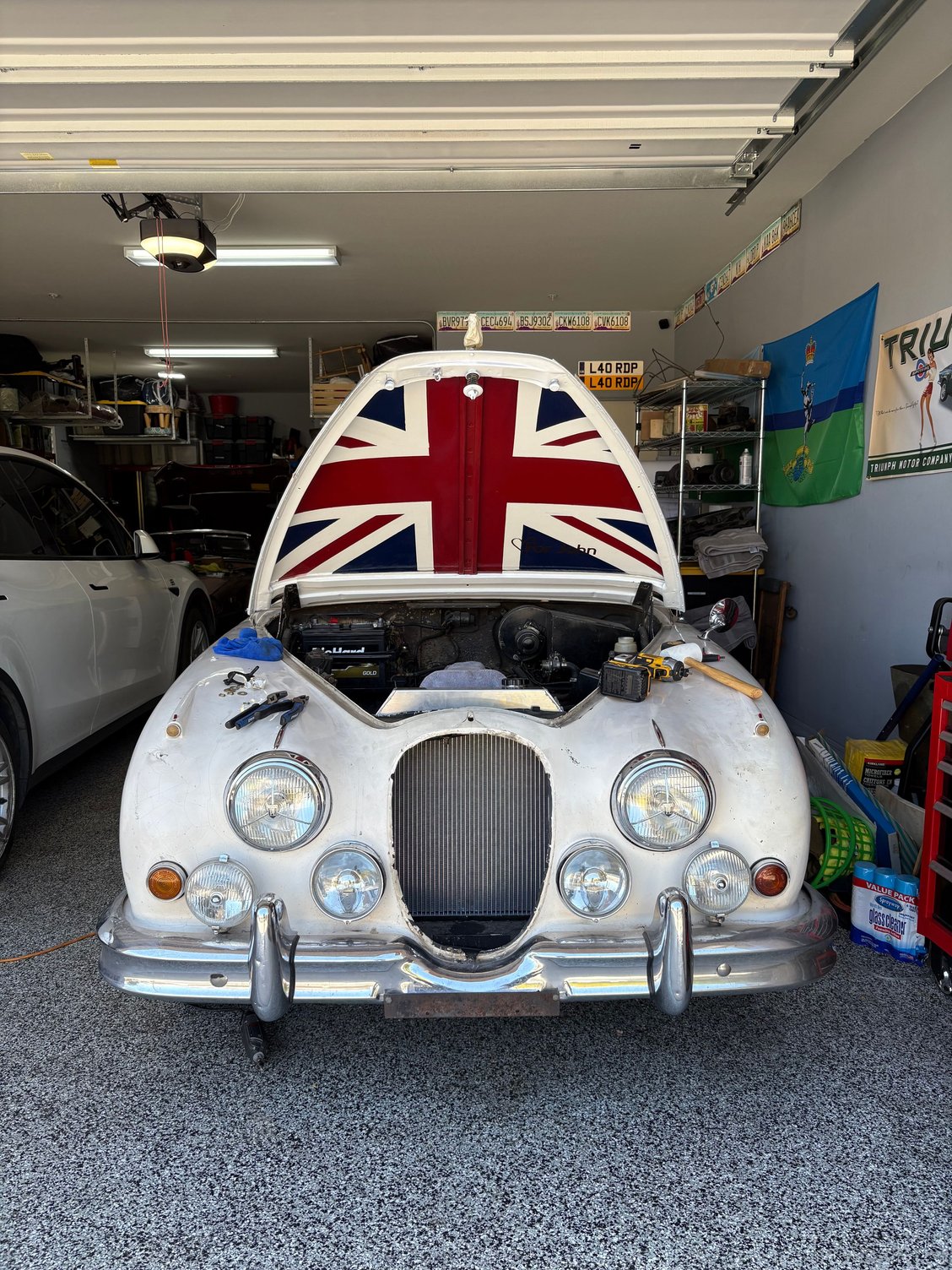

Got the hood on to see if the radiator fits.

My bet says yes, it will work. Is your "hood liner" painted on? Looks good, but I dont think a decal would fit that tight.

hand painted, with a custom decal I made that says “❤️For John” in metallic bronze.
it fits but only just.

Glad to see the progress! So many lights on the front, was it a Rally Car in a previous life?

Check the radiator cap pressure.
I fitted one of these alloy radiators and did not realise the cap supplied was 1.2 atmospheres or roughly 17 PSI.
I ended up popping a welch plug due to excessive system pressure build up.
These early Jag systems are set to run at low pressures like 5 to 7 PSI Maximum.
These early welch plugs won't tolerate the very high pressures typically found in modern vehicles.

Cap is marked as 17 psi, I’ll search for a lower pressure cap then.. thanks
paint on the fenders is cracking and there’s a ton of small dents… least of my issues atm as will need a full strip and repaint.
