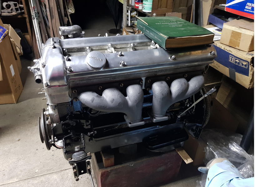

Many 2.4 engines had straight down manifolds. Jaguar was all over the place in those days ~ see Taylor comment.
Example:
Example:
All 2.4 engines in the MK2 had the straight pipe manifolds, they never used anything different just the same as all 3.4 and 3.8's had the swept back manifolds. The only difference was early manifolds had a different gasket arrangement as outlined above.

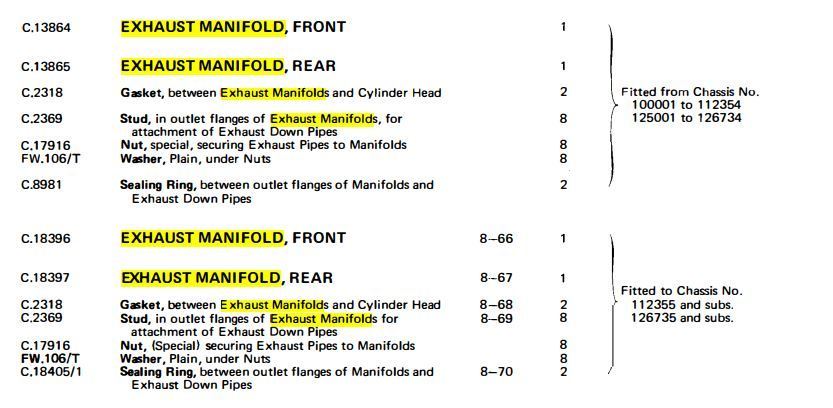

I have checked my MK2 3.4/3.8 parts manual which included illustrations of the manuals used.
Refer to Homers previous post reference parts numbers and what was fitted to cars by body numbers.
C13863 & C13865 were vertical output manifolds fitted to early 3.4/3.8 cars.
C18396 & C18396 were swept back output manifolds to later cars.

In the S Type parts manual the part numbers for the manifolds are C18398 and C18399. One number added to each so different parts. These are swept back so there is a different although possibly very small between the Mk2 swept back and the S Type swept back manifolds but don't ask me what it could be.
Guessing it could possibly be the change in flange to accommodate the doughnut gasket on the S Type if the Mk2 2.4 had the flat gasket?

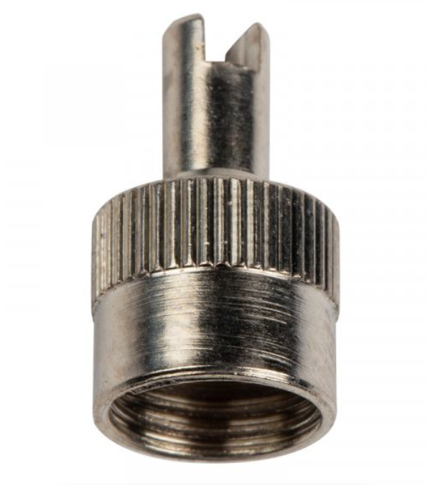

On a lighter note I was re-reading the aging Doctors notes on my car and he even recorded changing the tyre valve caps from plastic to metal caps with the facility to unscrew the valve itself.
Schrader valve caps.

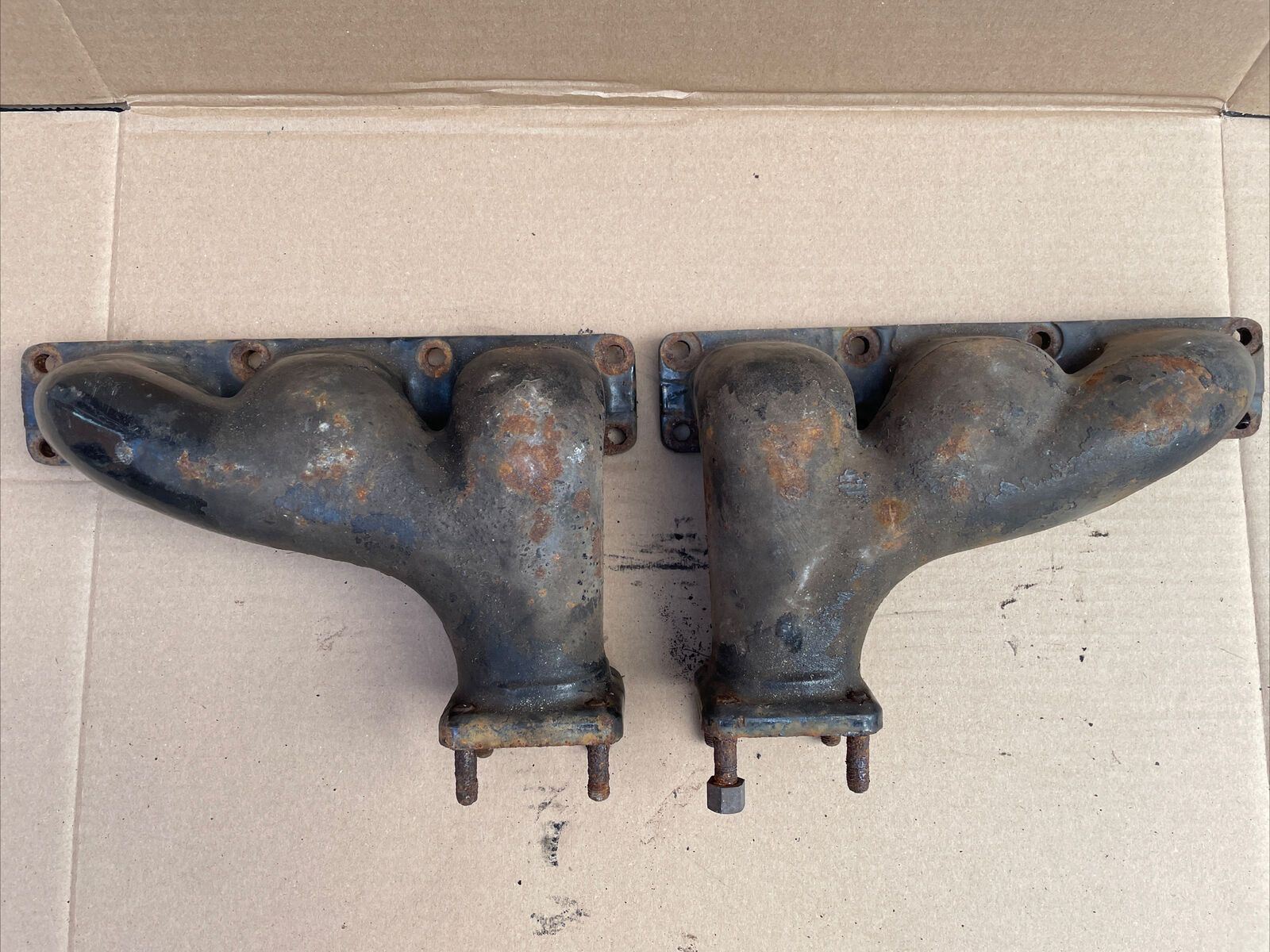

The reason the downpipes don't fit correctly is that you have an exhaust for a 3.4/3.8 which is designed to fit the swept manfolds and have fitted it instead to a set of straight manifolds.
The different angles of the outlet pipes and their relative positions are why they don't fit, if you look at the 3.4/3.8 manifolds they exit further back and at an angle which is why one of your pipes is too short. The down pipes have a flexible section and I suspect if you look at it its meant to be straight and its now bent at an angle.
You have these 2.4/E-Type manifolds
The exhaust you have is almost certainly for these 3.4/3,8 manifolds
Its not that you can't do what you have done and is probably the cheapest option but its why it doesn't fit as you expect. Just be careful that the flexible secitons aren't under undue strain.
