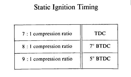

Re pinging/knock. Aus has good fuel so that should not be an issue. First thing to do is have advance curve of distributor checked & set timing correctly. High speed knock could mean that the distributor is over advancing. My car has approx 8.5 to 1 CR. Do you know what pistons are fitted to your car? Standard CR's were 7 to 1, 8 to 1 & 9 to 1. Most heads today have been shaved.
Correct distributor is a Lucas 22D6 41063A
I have no pinging with static timing set at 7 deg BTDC. 95 RON gas/petrol at coast ~ distributor rebuilt & on spec. New clean engine with no piston or combustion chamber deposits so no incandescent hot spots.
