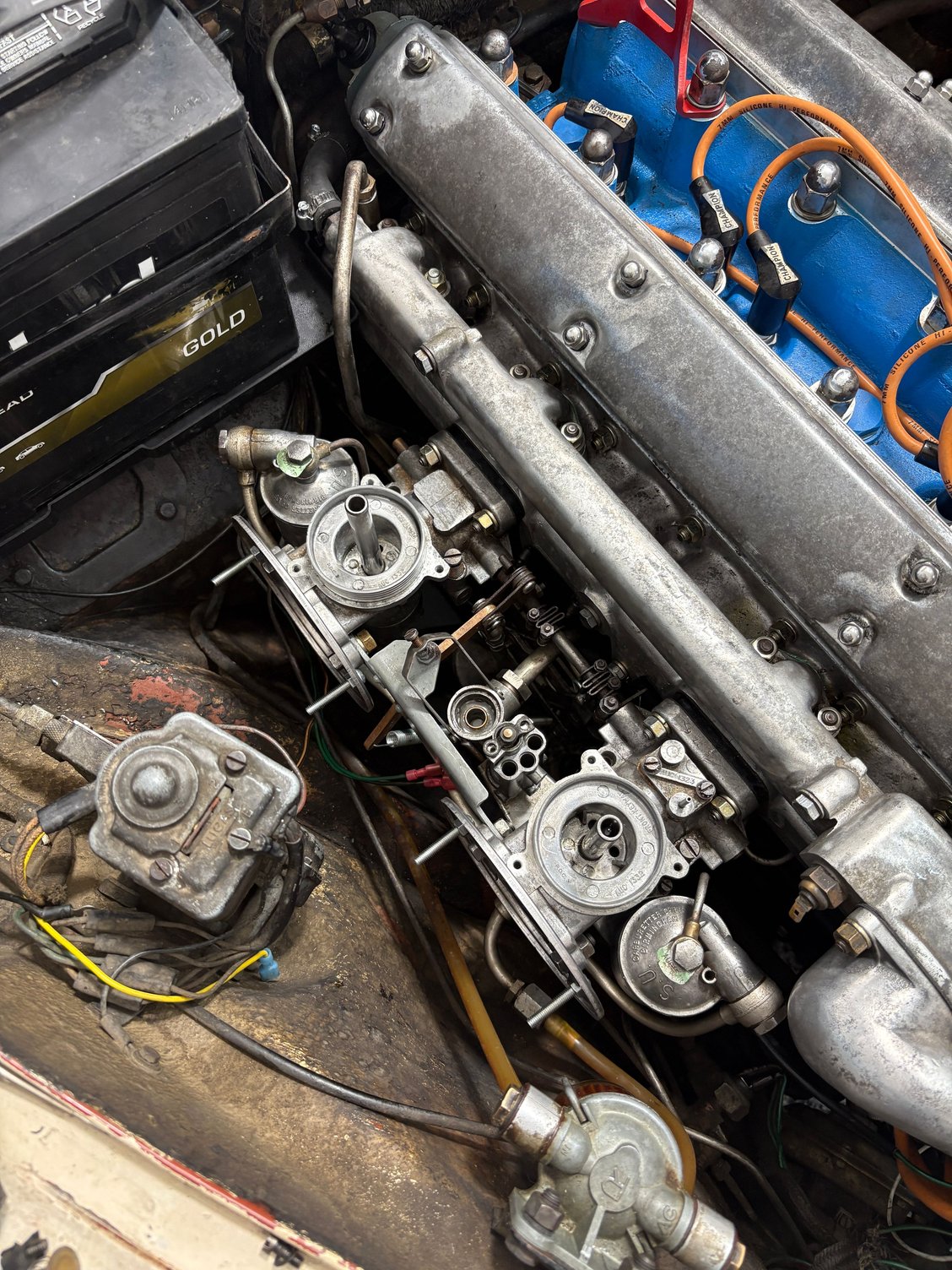

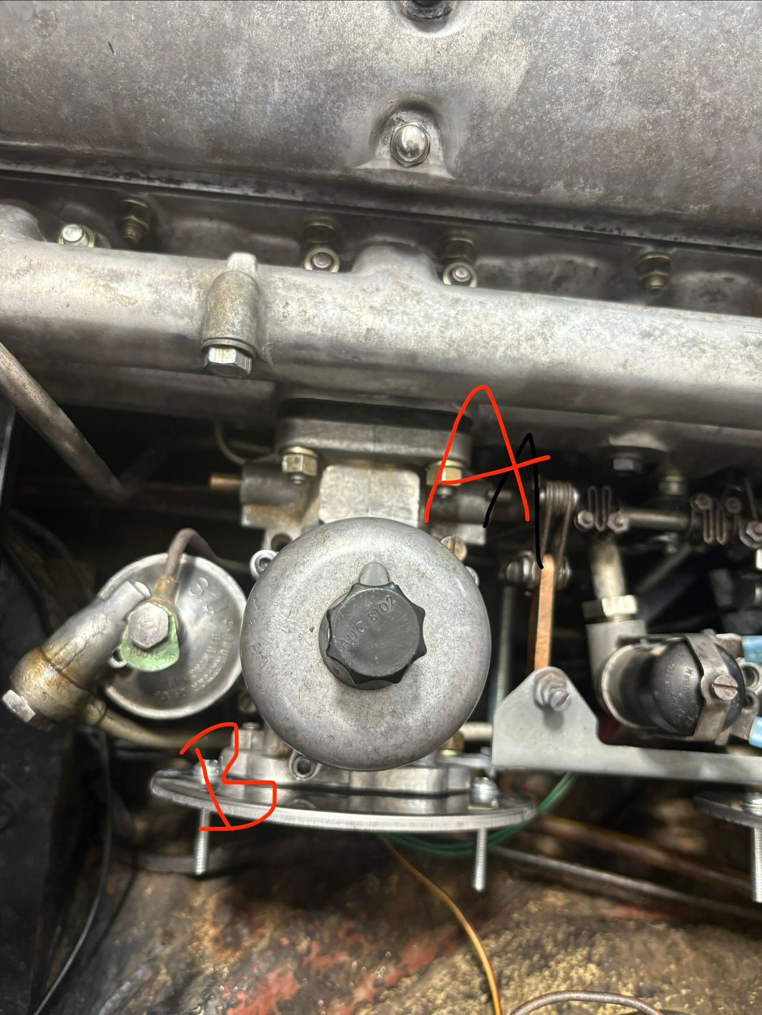

After looking at your photos: it looks like you're using the hard bake-lite heat sinks on both carbs, they need a green (usually green) gasket on both sides to seal properly.
The way they sit now, it's not sealing there well _ vacuum leak, that is one reason why the idle screws can't be set. (RED ARROWS point out where the gaskets should be)
The vacuum port arrowed out in green has to be blocked off, otherwise there is a vacuum leak there.(you may temporarily block it off with something)
If you attach it the the vacuum advance on the distributor, then that will be OK, assuming that the diaphragm holds vacuum.
Check it with a small hand held vacuum pump, if you don't have one of those, take a long vacuum line and use your mouth, most people can create enough suction to see if the diaphragm has failed or not.
And the thermostatic solenoid has to be in place, otherwise there is going to be MAJOUR vacuum leak there !

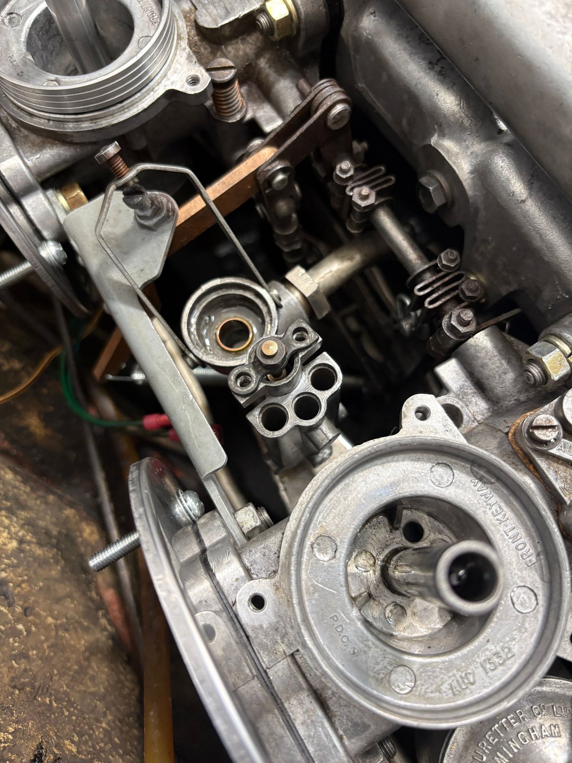

It also looks like the choke is missing some bits, the screws should be in place ((green arrow)
The cover is missing (red arrow)
Most importantly, the small locking tab looks to be missing, this stops the adjusting nut for the choke (pink arrow) from rattling around and keeps it set. (the locking tab doesn't seem to be shown in the picture)
You screw the nut in to lean the choke out and screw it out to make it rich.

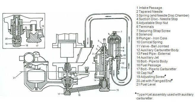

I will chime in with my ten peneth worth although everything has already been said really.
The fuel is only pressurised by the pump to get the fuel up from the tank to the float chamber. The engine does not use pressurised fuel only vacuum fed fuel. Once the fuel has been pumped to the float chamber and the float closes the float valve the fuel pump recognises, via back pressure that no more fuel is required and shuts off. (When you switch the ignition on the pump ticks and eventually stops when the float chambers are full.) If the pump does not stop pumping fuel and the float chambers are leaking then the fuel is still being pumped into the float chamber which indicates a fault with your float or float valve. The floats have been known to spring a hole and fill up with fuel causing them to sink which means the float valve is not being closed. If the float height is not set correctly then the float valve is not being closed and fuel will continue to enter the float chamber and find any hole to leak from as it is at this point under pressure from the fuel pump and the fuel level is pointless. Setting the float level lower so there is less fuel in the float chamber is better than having it full to the brim.
With the tops off the carbs turn on the ignition, listen to the fuel pump tick and watch the needle valve seat. If the fuel starts to flow up through the needle valve seat then your float chamber levels are still too high. If the fuel is leaking here then the float valve will not close and the fuel pump will just keep pumping until the tank is empty and you have fuel all over the garage floor.
This part is important as more engine fires are caused by over flowing fuel from badly set floats than electrical fires. (in my opinion.)

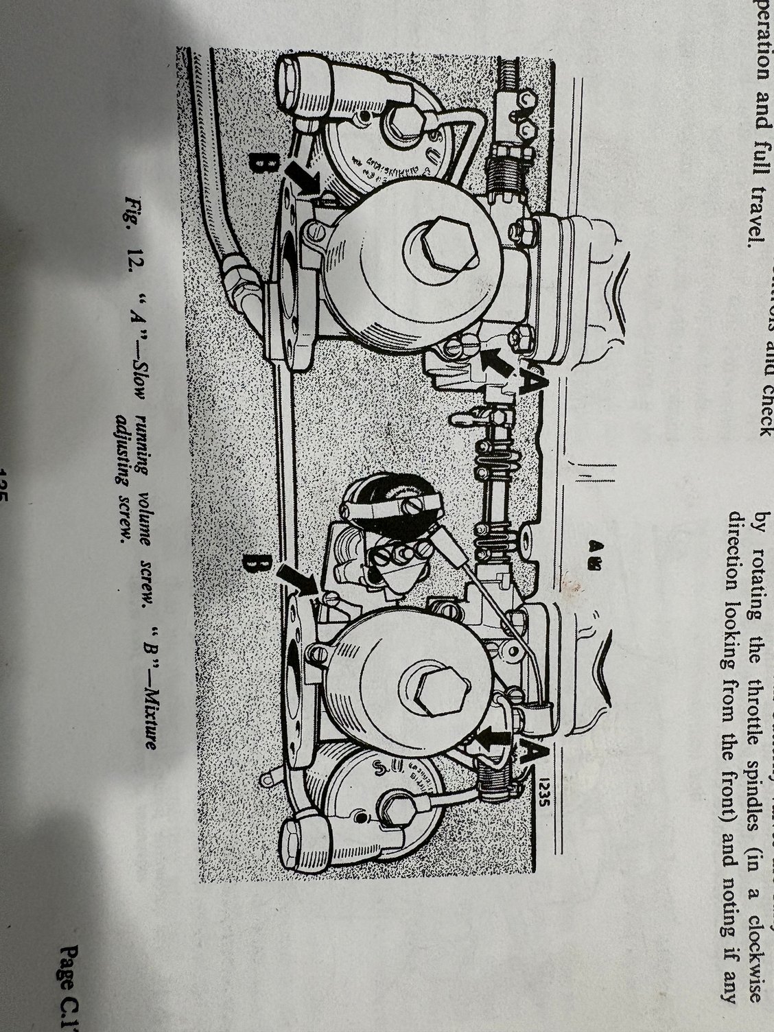

Below is a diagram of the carbs and the fuel levels. The line 21 is the fuel level when the float valve is closed.
If the fuel level in the float chamber is too high then fuel will leak out of the needle valve seat in the mouth of the carb and the AED will overflow if the fuel pump is still pressurising the float chamber..
Setting the slow running should be done when the engine is hot regardless of the ambient temp in your garage. Before setting the slow running screw to its starting position you have to balance the carbs. The butterflies on both carbs have to be closed with the slow running screw screwed fully screwed out so not effecting the butterflies. To do this there are bridging clamps on the spindle between the carbs. Loosen off the slow running screws, then let off one of the bridging clamps. Remove the top of the carbs so you can get a finger into the mouth and physically push both butterflies shut. They should be shut at this point anyway as the carb springs should be pulling them shut. I like to twist the spindle and let the butterflies snap shut on the springs. Once both are seated correctly then tighten up the spindle clamp and then you can screw the slow running screw down to its start position which is either 2 1/2 or three turns.

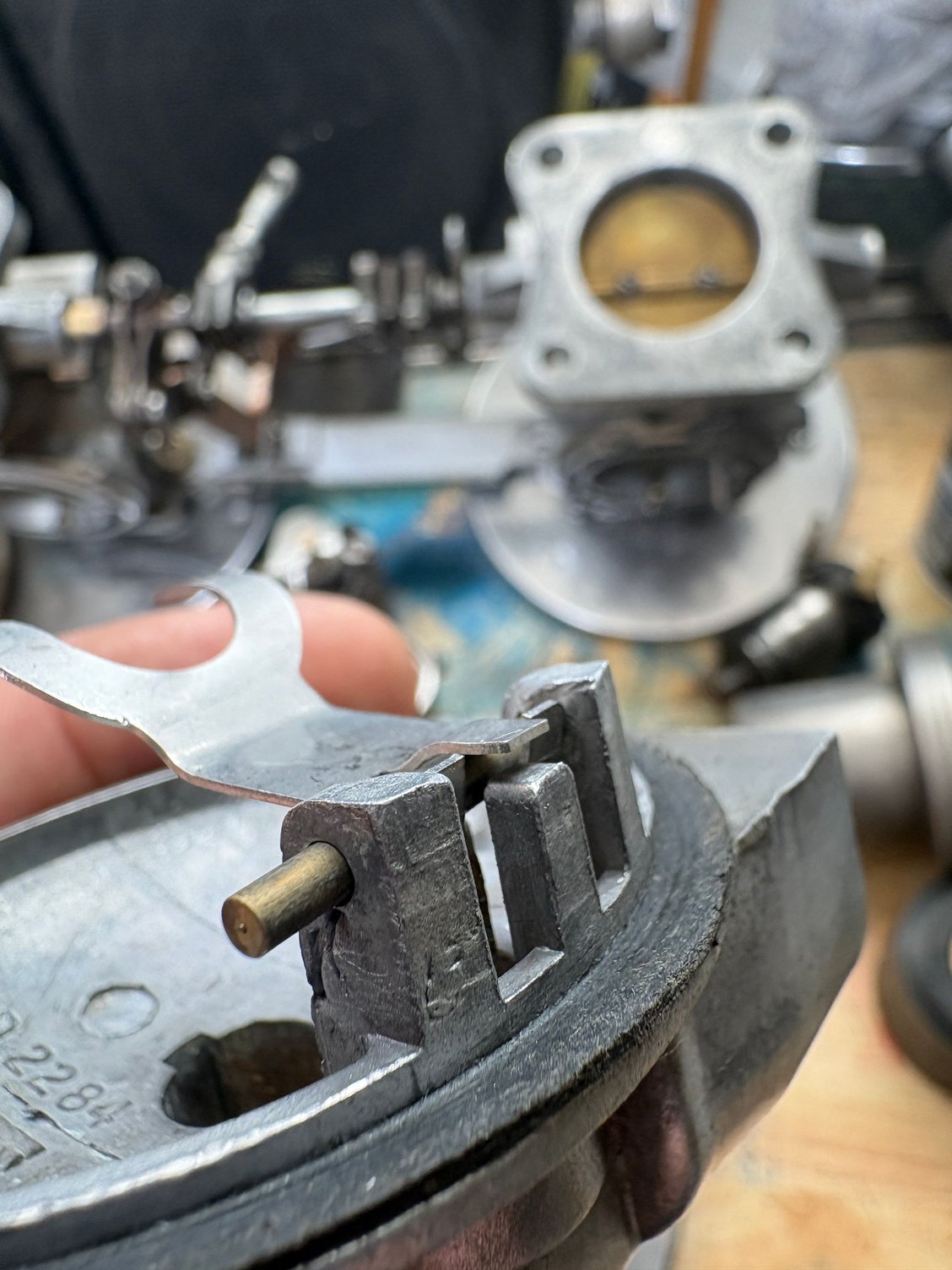

Another thing, your brass round stock that you used to set the float levels, it is 7/16 right, not 3/8 ?
Old Yesterday | 12:16 AM
Lord_P's Avatar
Veteran: Navy
Veteran: Army
Joined: Mar 2019
Posts: 273
Likes: 16
From: Buckeye AZ
absolutely - amazons finest
Old Yesterday | 02:45 AM
JeffR1's Avatar
Joined: Aug 2013
Posts: 1,840
Likes: 821
From: Lake Cowichan BC Canada

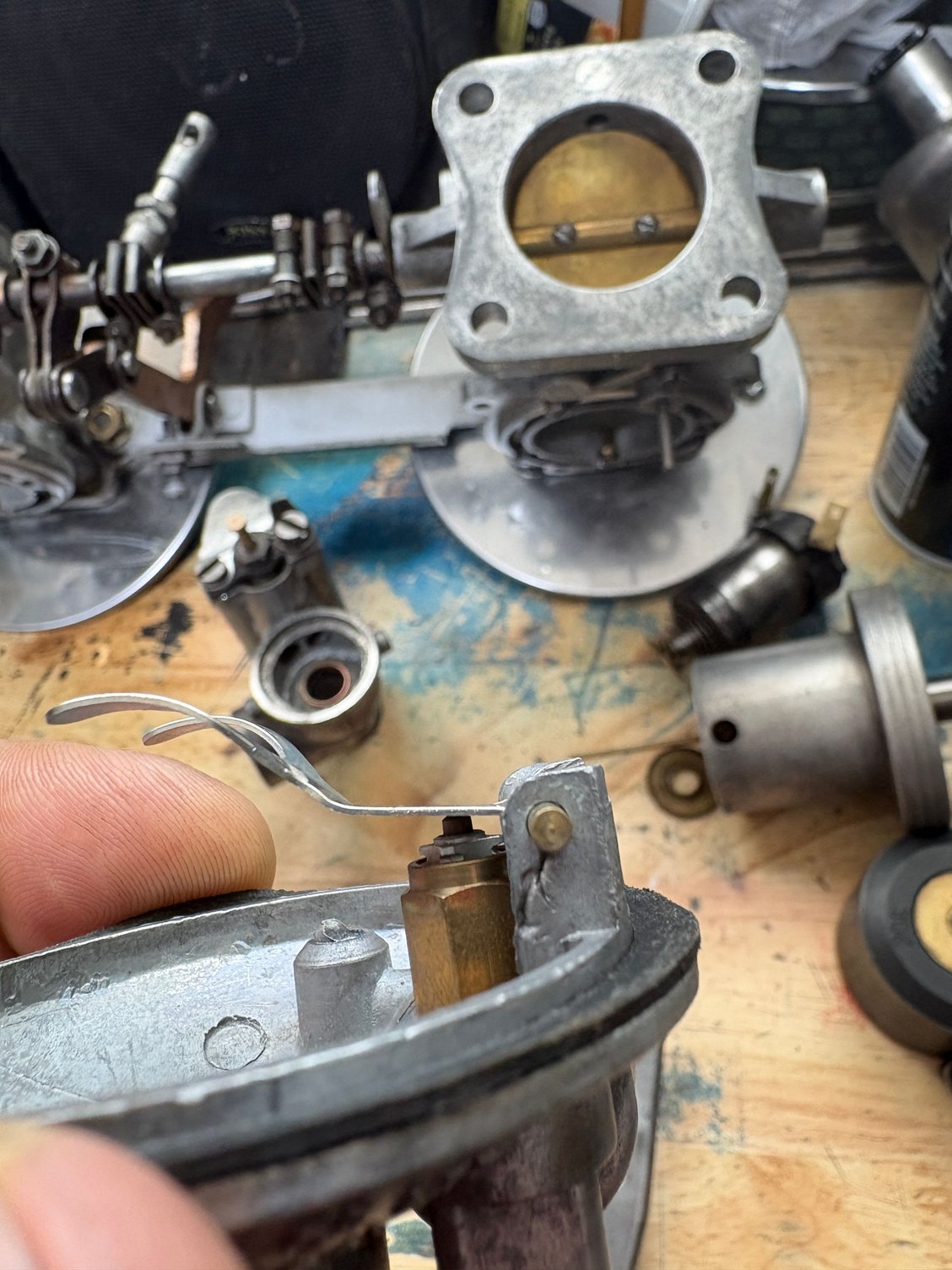

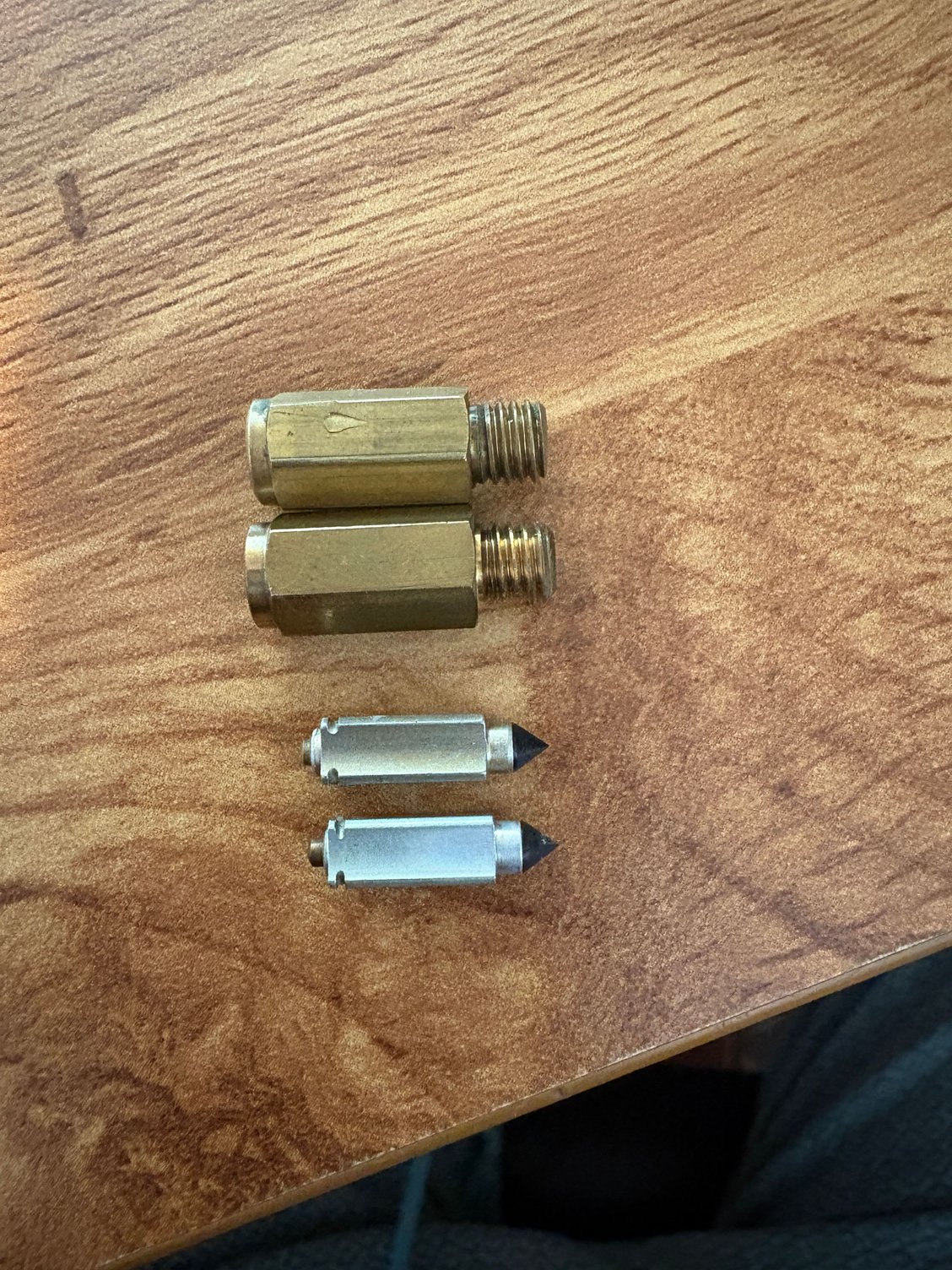

Have you adjusted the tab on the back of the float fork so that it doesn't fall too far into the float bowl ? (red arrow)
Another thing that I've had happen is the area (green arrow) where the needle valve comes in contact with the float fork has worn into a concave dip.
This causes the needle valve to bind there, even more so if the adjustment tab on the fork is not correct.
To correct this, I took a small flat punch to push the worn spot out, then filed and polished it flat.
I wonder too if you have the correct needle valves in your kit, a shorter needle valve housing would certainly cause your "fuel fountain" issue.
I'll check the length in the morning and post that, it's almost 1:00 A.M. now.

I’ll send photos later - both forks are brand new needle housing the same same size as the original from ‘62

Try this, go to your hardware store or where ever and get yourself a 1/2 bolt with a long shank that can be used to adjust the float fork.
You do not want to use the threaded part; an inexpensive Chinese bolt will work well enough.
Cut off the excess and the head with a hack saw.
Bend it where the Blue arrow is.
If your needle valve is spring loaded, then the fork needs to be adjusted on the "uncompressed" height.

[img alt="Original on top
New on bottom"]https://cimg0.ibsrv.net/gimg/www.jaguarforums.com-vbulletin/2000x1504/img_3396_5230d4e4ae2d352b22f7b4a2914ee852de41e922. jpeg[/img]
Original on top New on bottom
Used the 7/16 rod to adjust, but under advise from Jagvet and others made the bend larger for a quicker cut off.
I have cleaned the spindle that guides the float with wet and dry paper, I did notice that the float moves freer up and down, no snagging.

The top tip looks OK, but the bottom one looks damaged with a groove in it, or some material missing.
I would have ordered the parts from Burlen Carburetors.
The new bottom one does look damaged.
