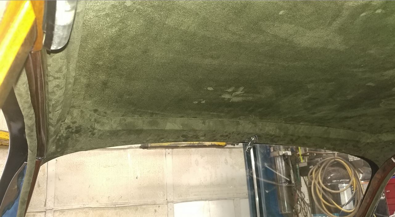

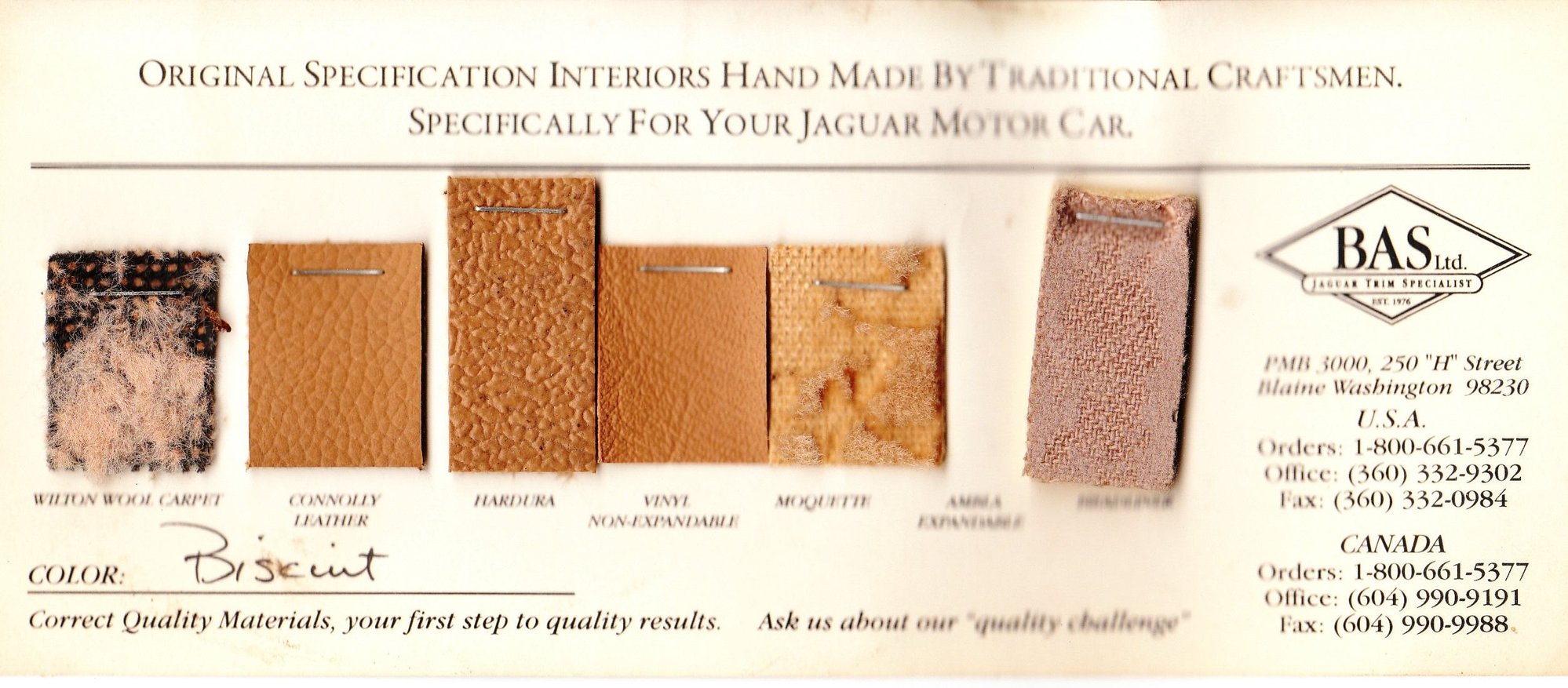

I just wanted to post this as a caution to keep bugs out of your car & the possible requirement for bug spray now and again. I'm not picking on BAS but these swatches were sent to me 6 years ago and have been stored in my garage. They insisted on sending me these when I asked them if new consoles had been moulded/manufactured by anybody for the S Type as they always slump over time.. I had already told them I was using John Skinner for all my interior materials. BAS headlining has always been wrong. It is thin hard foam backed & shows brush strokes in it's pile. The correct material for an S Type is lambswool Union Cloth. Note what bugs have done to the supposedly Wilton Wool Carpet & Moquette. Both chewed down to their backing in places & colors are not correct Biscuit.
This is the best scan I can take due to various thicknesses of materials: From left to right the swatches are. Wilton Wool Carpet, Connolly Leather (my genuine Connolly hide is about twice as thick as this), Hardura, Vinyl Non-expandable, Moquette, Space for Ambla Expandable (not provided) & Headliner.
Obviously Connolly hide requires the be fed on a regular basis. Genuine Ambla is real tough stuff.
I have personally applied bug spray to my Moquette. It is a known favourite of bugs.
Example of wrong headliner.

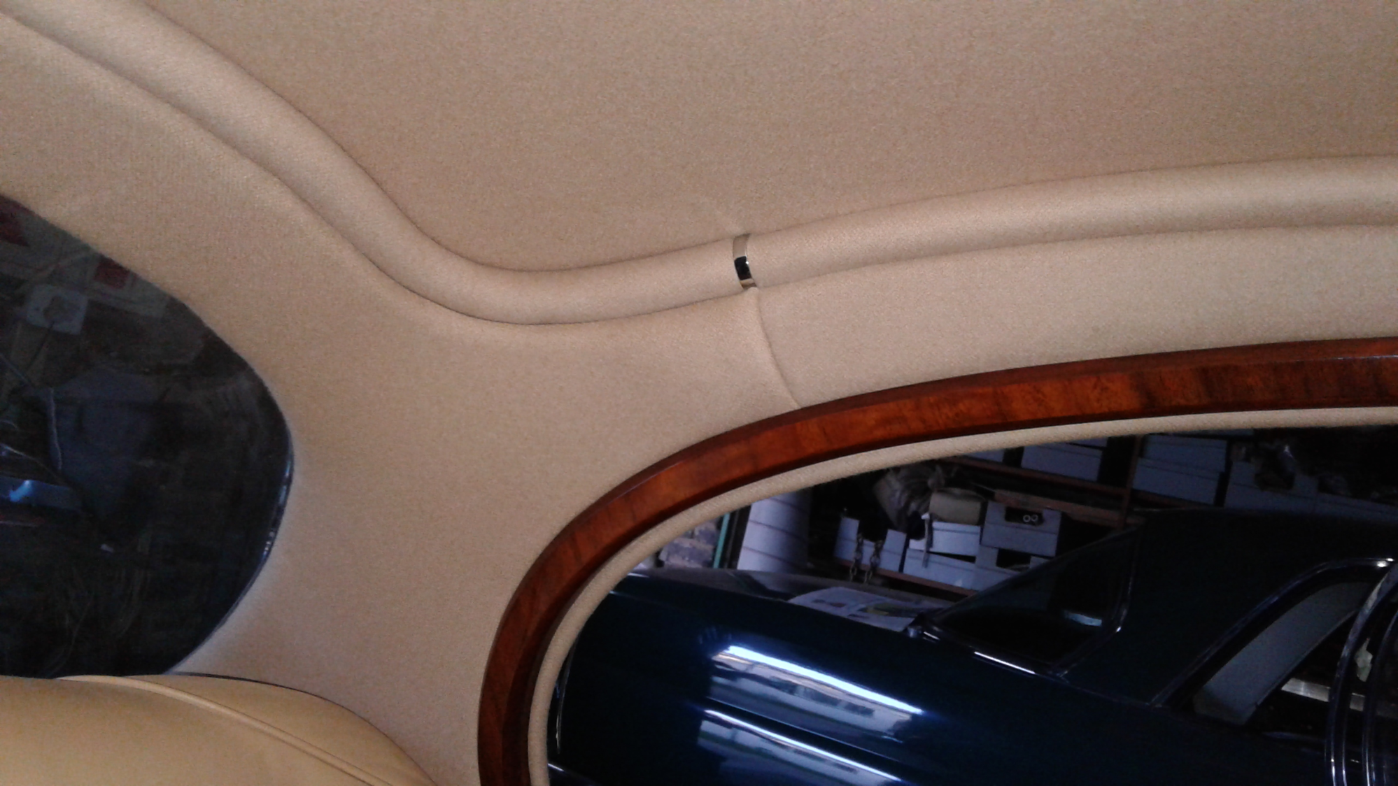

Correct Union Cloth & Biscuit Connolly hide.

I believe that BAS is using split leather ~ not a good idea.

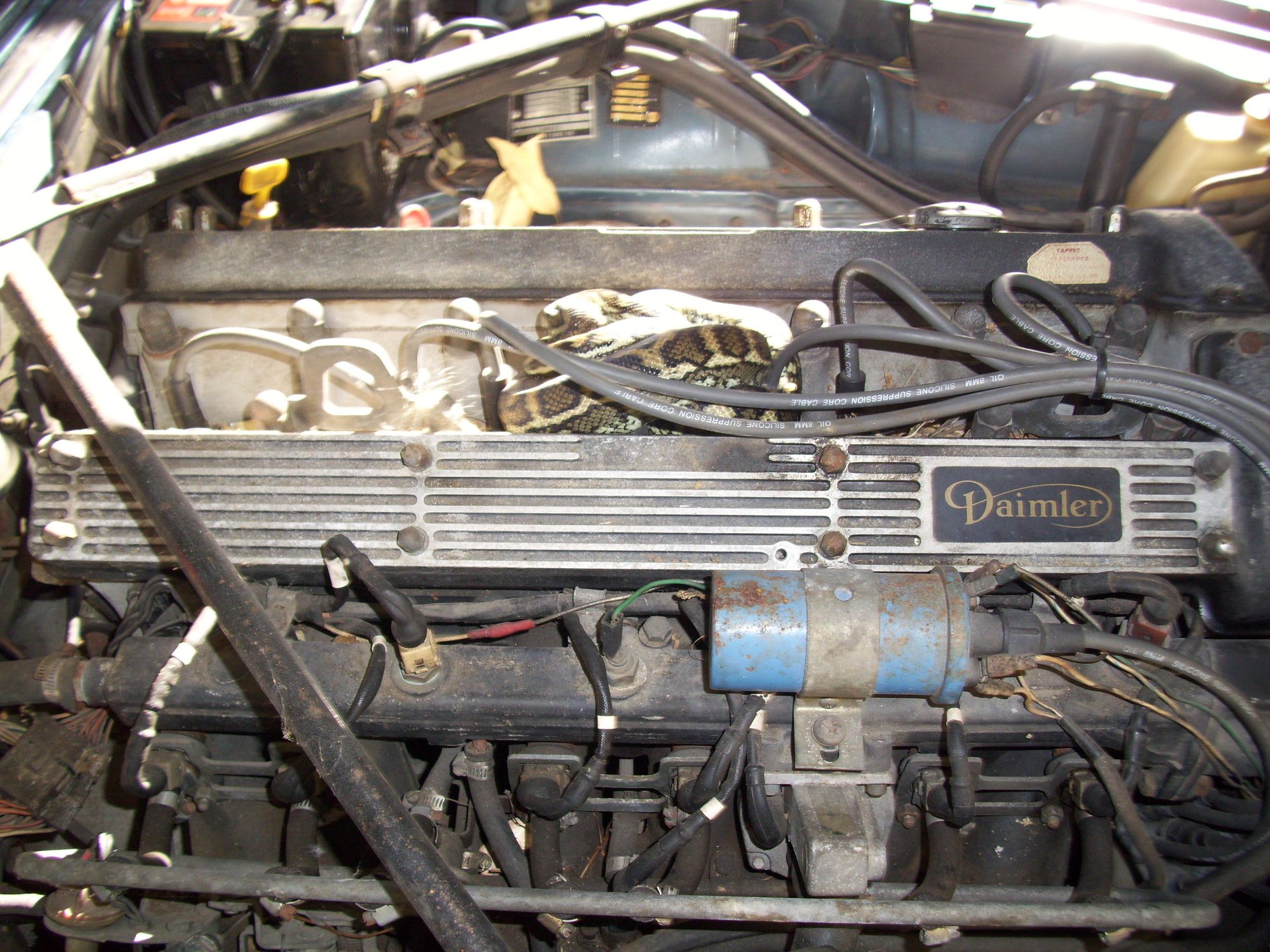

Also an occasional snake problem. One decided to make itself at home on my S3XJ6. It was a non-venomous python.
A carpet snake between the cam covers. It certainly deters any rats and mice.
