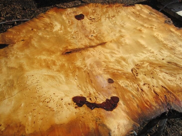

Dashboards, I have had to strip back the dashboard as its peeling and look terrible, I am looking at Huon pine which has nice burl, but is light in colour, the other option is clear Black Walnut Celery Top pine or Kinbilly pine

I live 5km from the mill and can pick it, see attache

There's no doubt that it's very pretty that's for sure.
If your going to change things, why not leave it the natural colour (it would be a shame to stain it) and use a dark wood for the banding.
Something like zebra wood, people heart wood, or ebony, the very dark colour would really set it off.
The other thing that may work is not to mirror image it, but keep the grain pattern from the dash, continuing down to the instrument panels and glove box.
The grain pattern IMO is not tight enough for mirror imaging.
