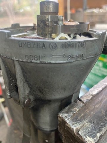

Will a distributor out of a 67 340 work in a 3.4 Mark 1 engine? Pictures attached to show the numbers. I'm not sure what if anything is different. First photo is of the late unit, second the early one.
Old Nov 11, 2022 | 10:19 AM
Jagboi64's Avatar
Joined: Jan 2013
Posts: 5,253
Likes: 3,515
From: Calgary, Canada
I expect it will physically fit, although they are a different series of distributor, so the cap is probably different. I would expect the advance curve is different, with different weights and springs inside, and likely a different vacuum capsule.

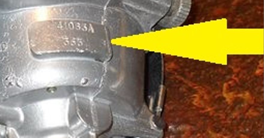

You can't just change distributors ***** nilly. Advance curves etc. change considerably by engine. Many of these fit alls can't replicate original specs.
e.g. a S Type 3.8 ~ 8 to 1 CR takes a 41063A. ~ our cars use part of the 22D6 family.

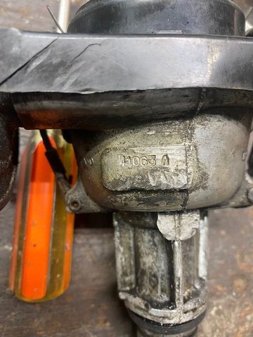

Bit of a battered unit.

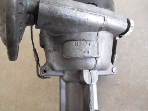

Made in March 1965 in much better condition than the above.

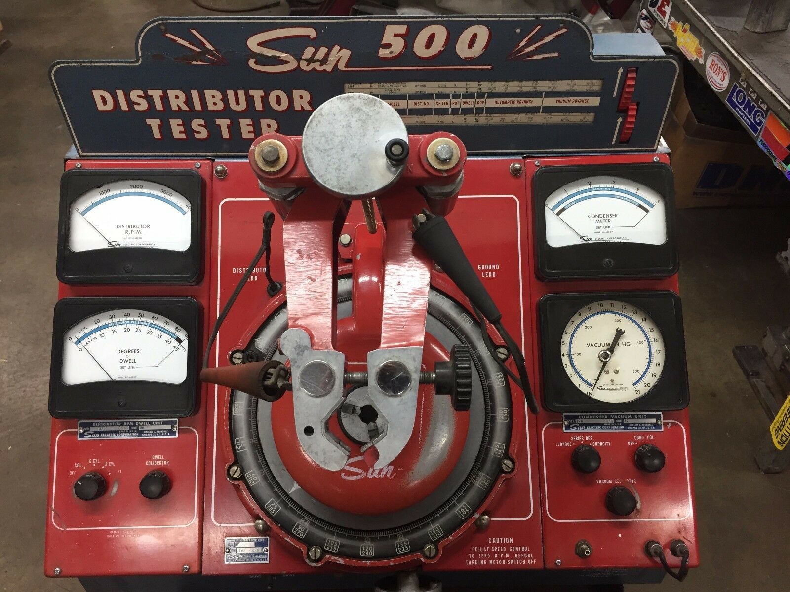

Then it should really be set up on one of these to ensure in spec ~ & they work surprisingly well:

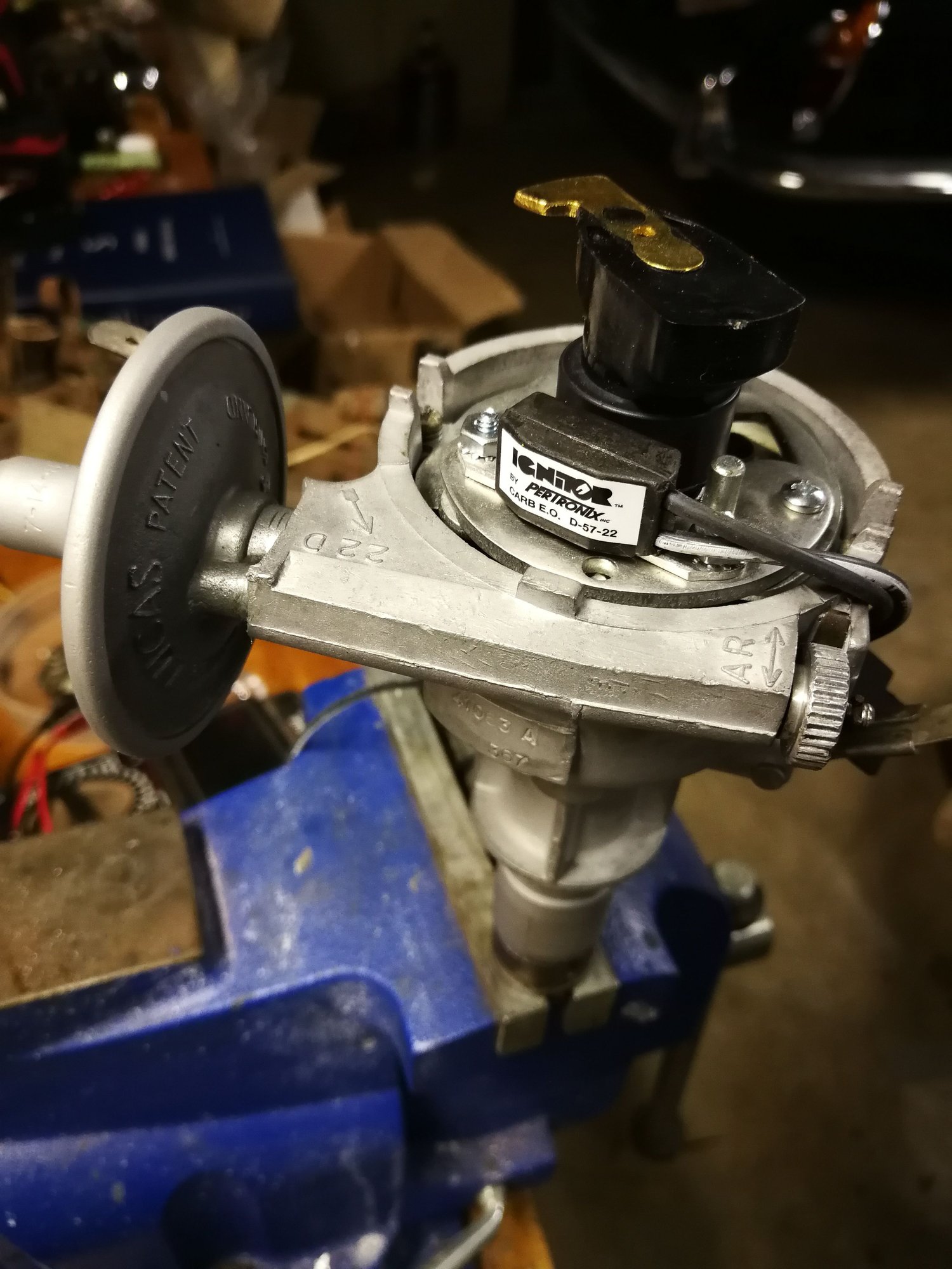

I went the originality route for concours & the car runs so beautifully I shall leave well alone. Certainly no lack of performance. I had the distributor professionally rebuilt to as new spec.
My only sin is fitting a Pertronix Ignitor as it is not inspected for concours & is under the distributor cap thereby getting rid of cursed points & setting dwell ~ available positive or negative earth. There is nothing wrong with the good old distributor. If it gives trouble at the roadside it is easy to fix & fit standard points & capacitor, new rotor etc. If you blow a component in your little mappable box you are stuffed. The engine compartment is a hostile environment for an ECU although many are mounted there with huge heatsinks. But then I use tube amplifiers on midrange & treble because they sound more realistic & faithful to the original performance to my ears which is all that matters. I only use solid state on bass. i.e. bi-amped. I maintain the practice in a full surround sound array with Maggies (Magnepan ~ Magneplanar Loudspeakers the size of a door & barely as thick) with ribbon tweeters.
