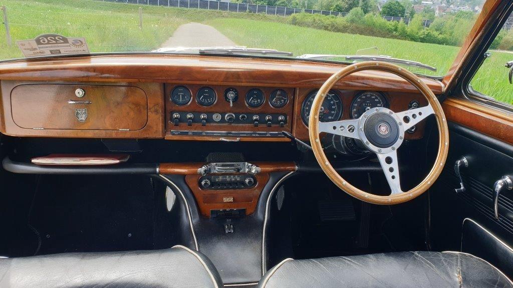

I prefer this woodrim that Vic Derrington made as an option for Lyons for Jaguar. Jaguar Part No. C25198
I just bought my S-Type and had the garage replace the aftermarket wood steering wheel with the larger original one. The car steers better with the original to my mind.

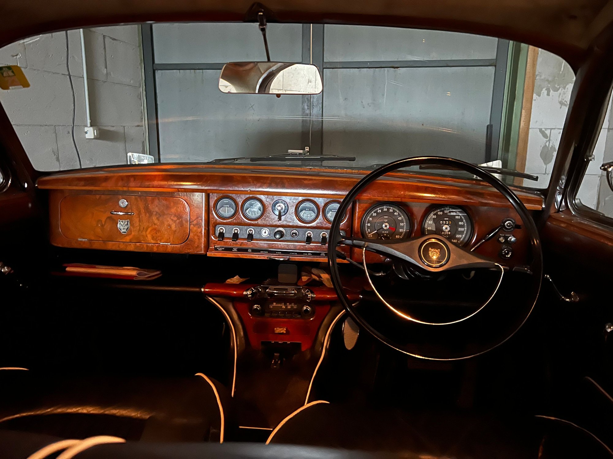

Mines a RHD 1966 3.8 S automatic. Originally registered in England, currently residing in Switzerland and likely retiring to Scotland (both me and the Jag)!
Then it's fitted with the 2nd Type Burman PAS. Same as my car. My car has the standard wheel & drives very nicely with slight oversteer at the limit. All suspension settings to the book at present. See my signature. My car was No 4 off of the SA line which really makes it a '66. Somehow registered December 1965. Production at CDA did not start until early '66 ~ issue never resolved. So I call it a '65

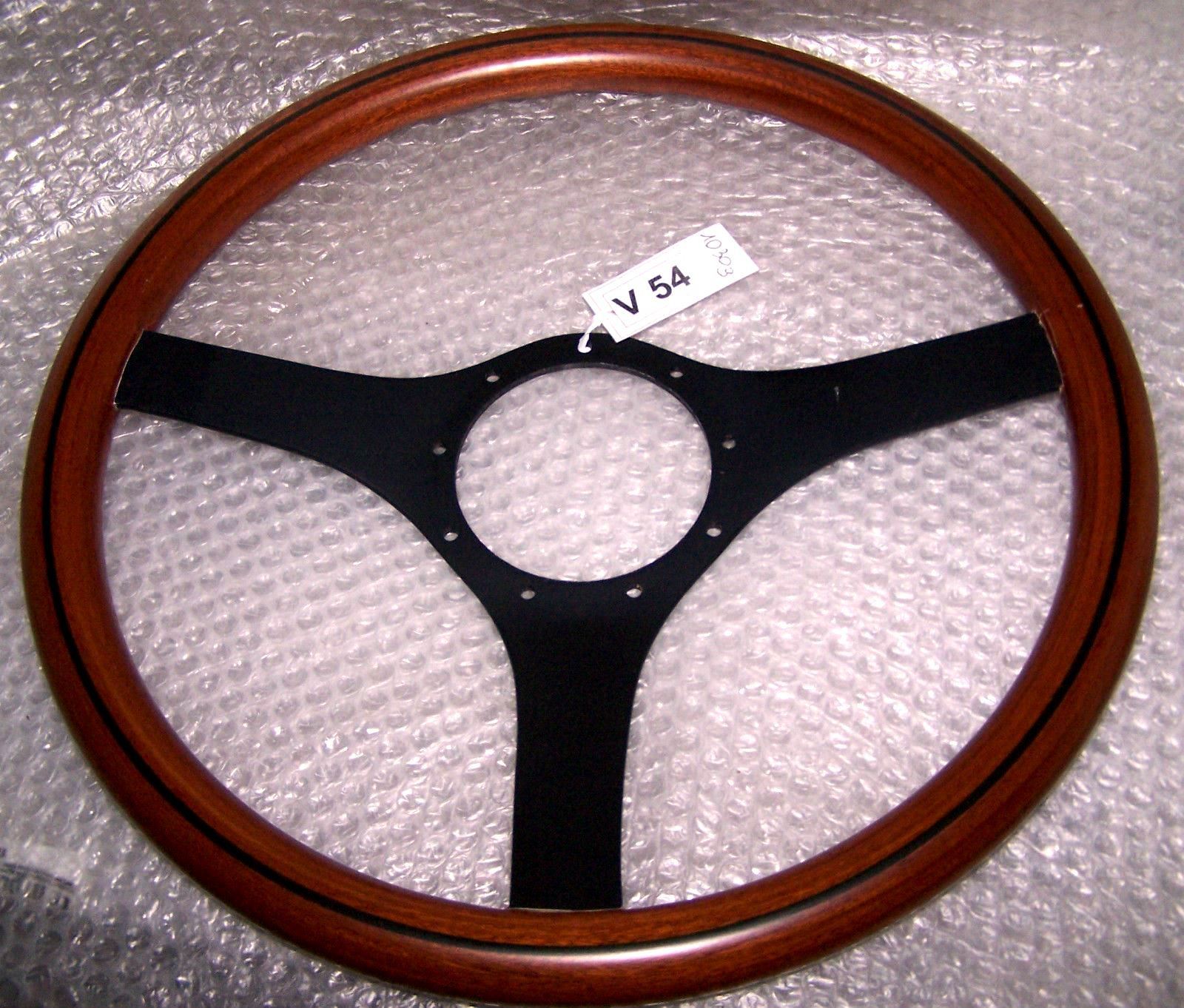

I have 1 of 4 made woodrim 15" wheels not yet fitted. It was made by a chap that works at Nardi. It is a Nardi wheel with a Moto Lita hub. It is being done in high gloss at present to match the rest of the car by a master at wood finishing. Old school friend. Very shallow dish. The seller preferred satin finish ~ who was I to argue.

I'm going with the don't fix what ain't broke programme. To be honest I think the extra leverage and knurled original fits me & my skeletal geometry better than the aftermarket wood 15", as does the stock aesthetic. I would say I'm a purist, but I'm not. I just know what I like😃

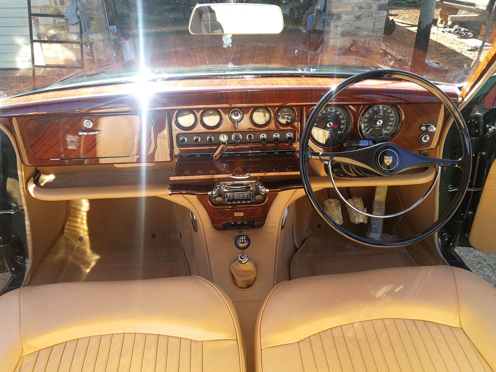

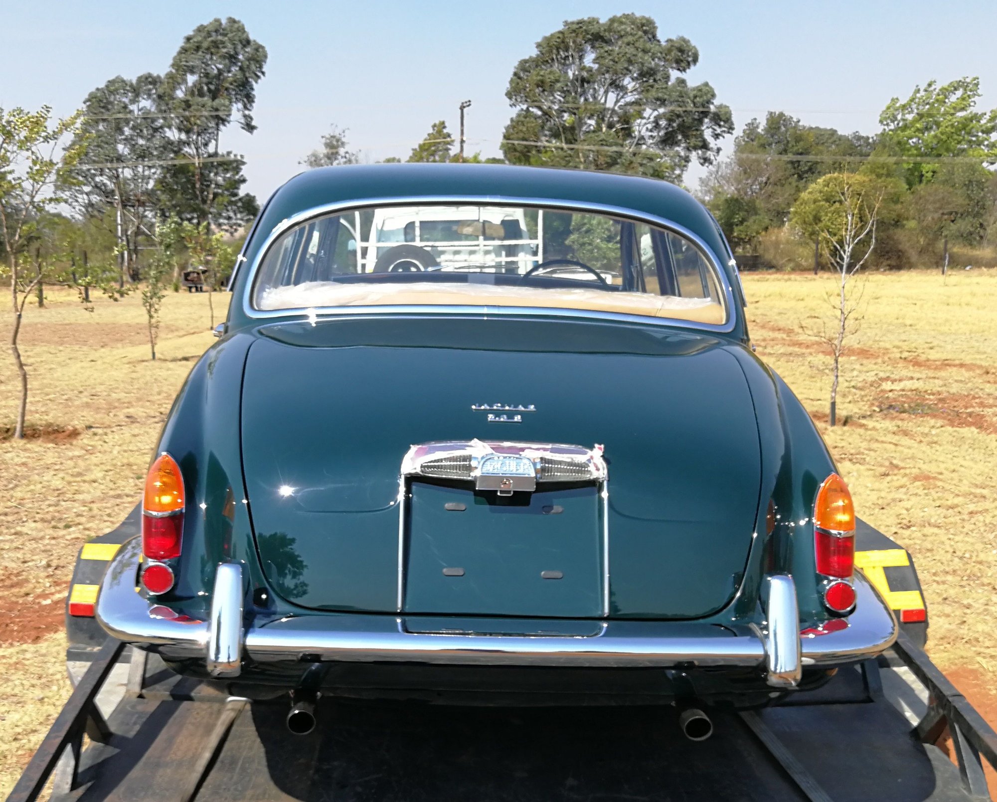

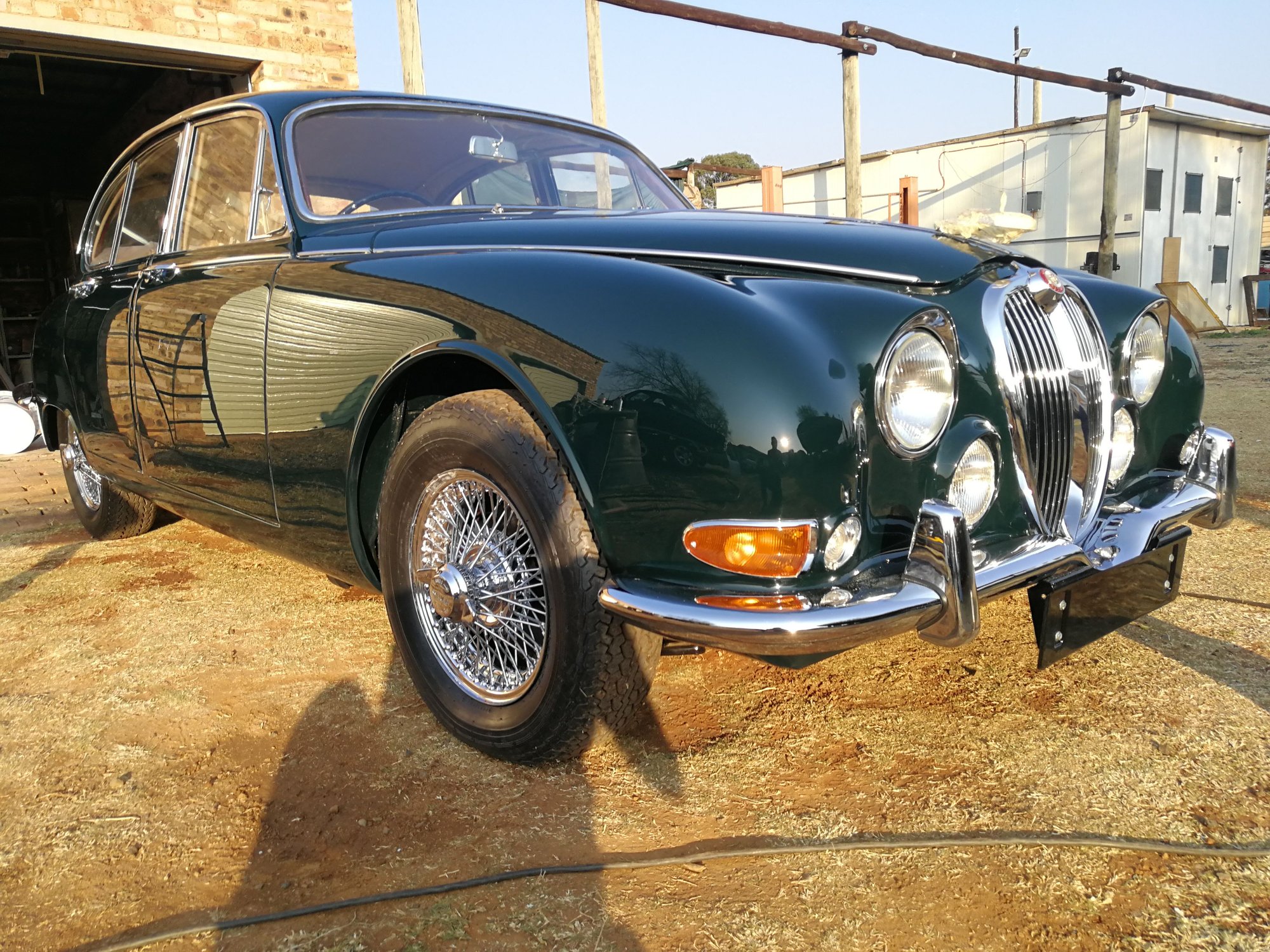

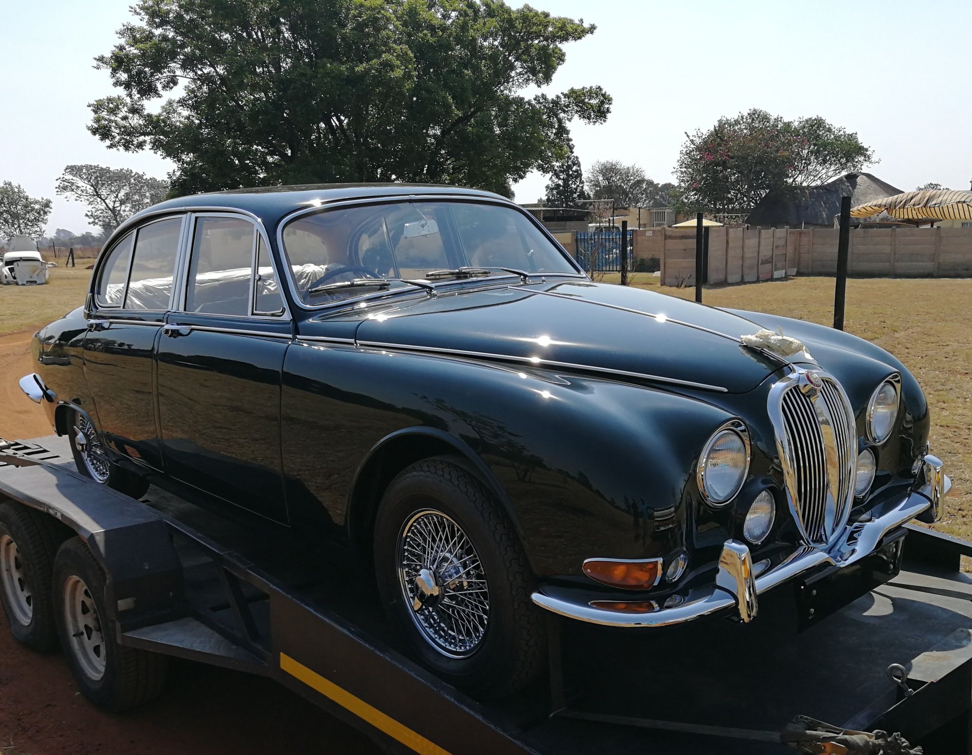

Mine at present outside workshop where we restored her. Excuse the mess ~ further construction taking place with hoist still mounted outdoors etc. & spray booth standalone.
Telephone cameras never get colours right. It is the 1976 XJ6 version of BRG. Interior biscuit.
On it's way to the big carrier from Johannesburg to Cape Town where I live.
Some protective film still on boot lid plinth etc.

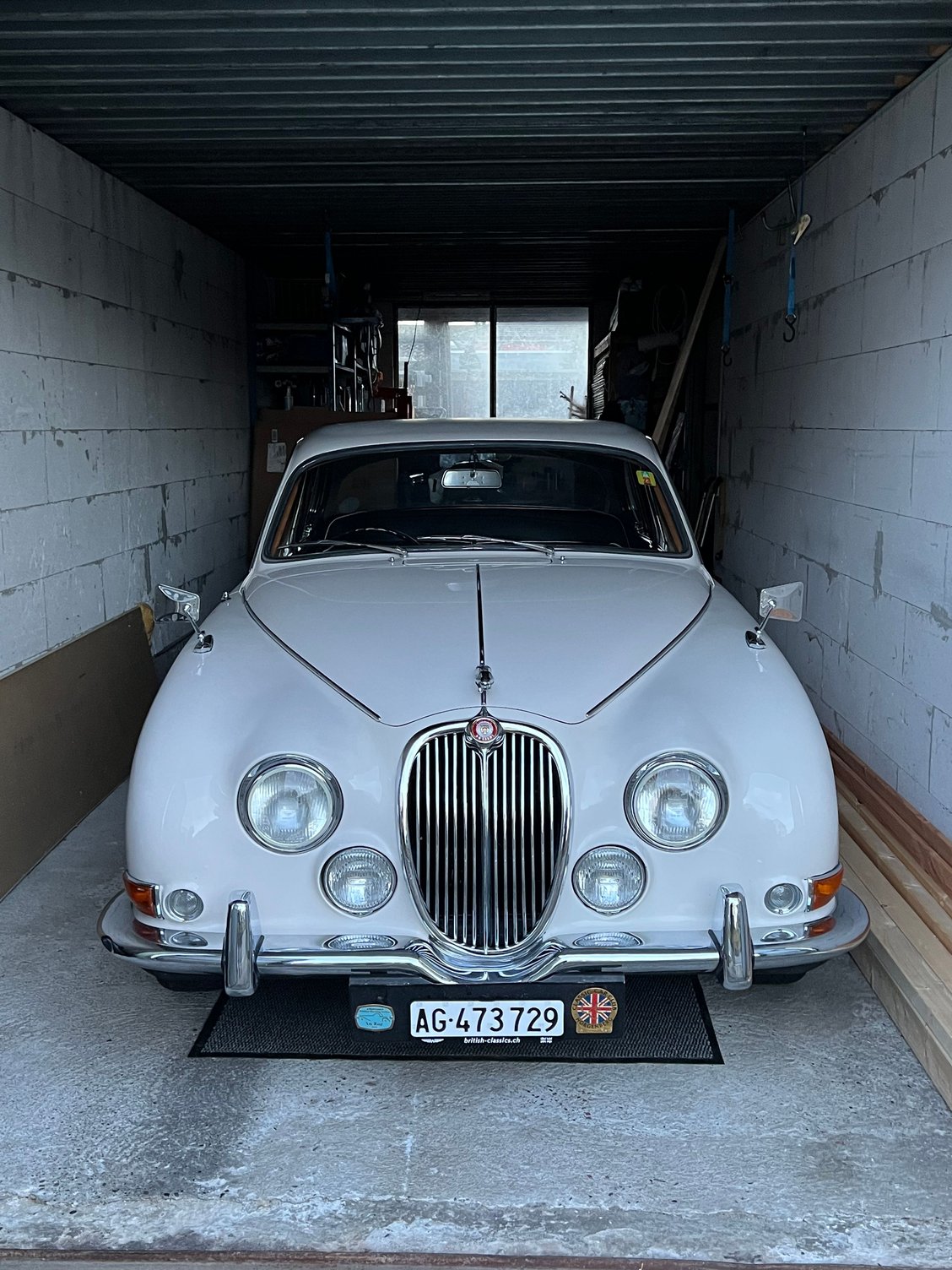

Yours looks fantastic. Mine is definitely more good runner quality living a life less ordinary as RHD in a LHD country. Even the radio works, but apparently no one's broadcasting🙄.
I may make a couple of mods: automatic choke switch and possibly replacing the ballasted coil with a 3 ohm one or install a 123 distributor. Bought in November with wooden steering wheel, delivered Thanksgiving with original figment and now garaged for the winter.
As test driven.
As delivered.
Home for the winter.
My favourite view
Wishing the last owner hadn't riveted the XJ6 Jaguar badges to the front wings.

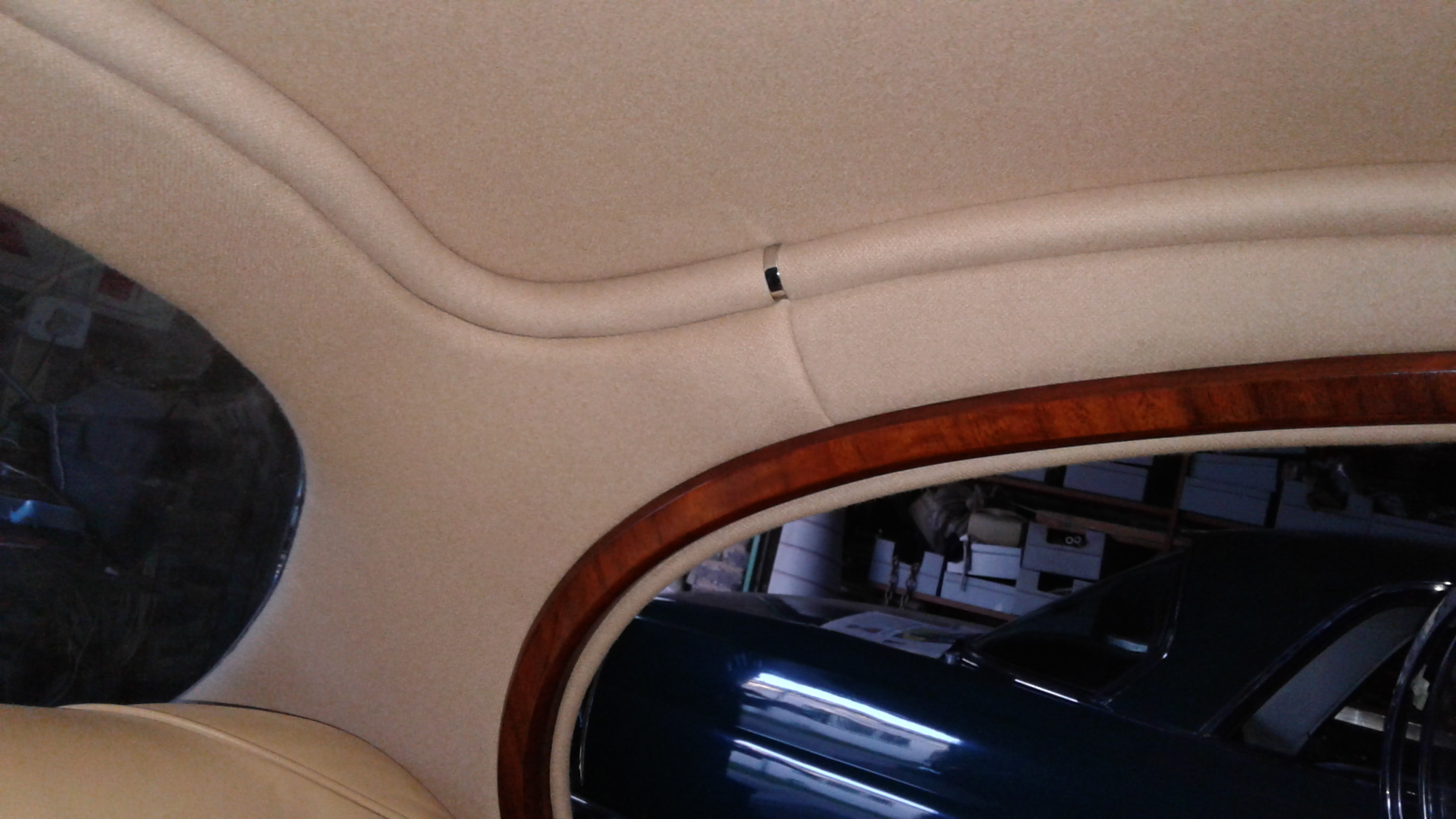

Default Piping is weird!
Looks like a neat car not full of rust. Very similar to mine when we started. Colour seems Old English White as mine was on solid wheels with original caps. I moved to wires. Funny what bugs certain people. I agree & would get rid of the XJ6 badges. What strikes me as odd is the white? piping on the seats & console. I would dye that seat colour which seems black.
To each his own. I don't criticise other peoples cars. If they are happy then I am happy. At least you are saving another S Type from the hotrodders that only want the IRS.
You should join us on the S Type Register. Informative forums section. Get your car registered if it's not there already.
Jaguar 'S'-type Register
I'm not what the previous owner was thinking, but I can't see it when I'm driving so it's all good!
