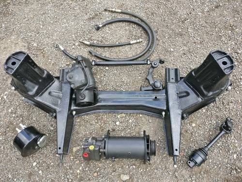

Thank you Peter. Your advice is very helpful. I am going ahead with the conversion and may then add power steering (any advice along that line would also be appreciated). I love the car and drive it often.
Try & get an entire front subframe as the crossmember requires an indent to accommodate the steering box. You can weld in an indent. Orlando from this forum & the S Type Register has done it.
Fit a Bendix Marles Varamatic steering box made under license by Adwest. Originally designed in Australia by Arthur Bishop for an aircraft nose wheel & commercialised by Bendix Corp for automotive use. The best of the bunch. You could then reduce the size of your steering wheel to 15" should you wish. Beef up your drop arm & idler or you can bend them if you turn against a curb. Easily found.
You would need to find a generator or upgrade to an alternator that can accommodate the PAS pump on the rear.(look identical) Don't waste your time trying to fit a Saginaw 1200psi pump. Not necessary & a pain to mount in a non 420 engine compartment. Stick to the S Type/340 arrangement.
Your steering will be far more direct. No mad winding of the steering wheel. Far better ratio.

For PAS, my opinion is that there are three attractive routes.
The first is that advised by Glyn above. Of the factory original systems fitted to our cars, it's by far the best. In the UK, complete late model (420 type) front subframes with steering and suspension come along on eBay from time to time. I guess they appear in the US, but it might be a bit hen's teeth. You will also have to arrange a steering pump. OE was a pump on the back of the dynamo (generator) - see Glyn's comments above.
As your car is a MK1, it should have a high ratio steering box with about 3.5 turns lock to lock. It's much quicker, but heavier in use than the standard Mk2 box. If the box is in good condition, a very good option is electric power steering. There are a few systems around. They are usually fitted to the steering column under the dash. Most reports are very favourable. In fact, at least one of the Mk2 owners on this forum has decided to buy a new replacement high ratio box to use with one of these.
The last option is the one that steps away from originality and raises a load of questions and discussion on these pages about bump steer and loss of Ackerman. It's to use a power assisted rack and pinion. There are several kits available in the UK using XJ racks with their tie rods shortened. Some say they are great; others that it's impossible for a rack to work well with the amount of trail on the wishbones of our cars. I'll leave it at that now and wait for the sparks ...
If I were you with a MK1, I'd start by thinking hard about the second option.

The Electric option requires some metal cutting under the dash. Not a big deal and are not cheap but work very well. Especially those that are now speed sensitive. There are plenty of 420's in the US. Either in scrap yards or abandoned. There was a whole field full of them within a couple of miles of our offices in Dallas. Down the Northwest Highway just out of the Baptist area where the booze stores start on the right. We were in Irving. It was popular by Jag standards in the US.
The 420 Varamatic steering is 2.75 turns lock to lock. Nice & direct ratio. Great on traffic circles.
https://www.sngbarratt.com/English(U...rnedDown=false
I'm not getting into the Ackermann angles argument. People that suggest that Ackermann angles are of no consequence are lacking in common sense or worse.
You will still need to beef up your drop & idler arms.
I would fit the wider rear axle, Vastly improves the handling. The rear track is too narrow. It worked on a front wheel drive like a Citroen but not a Jaguar. It also looks stupid.
