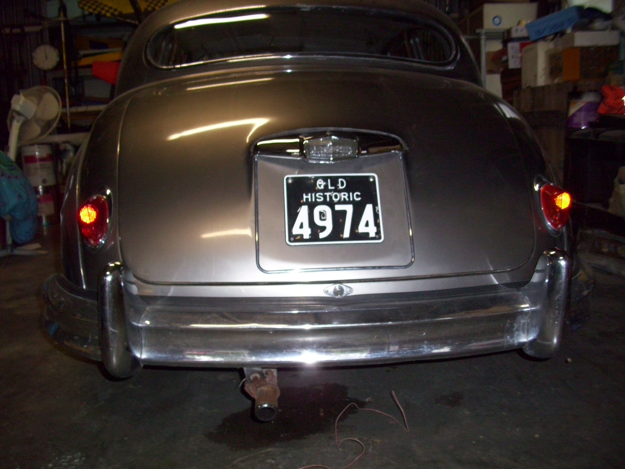

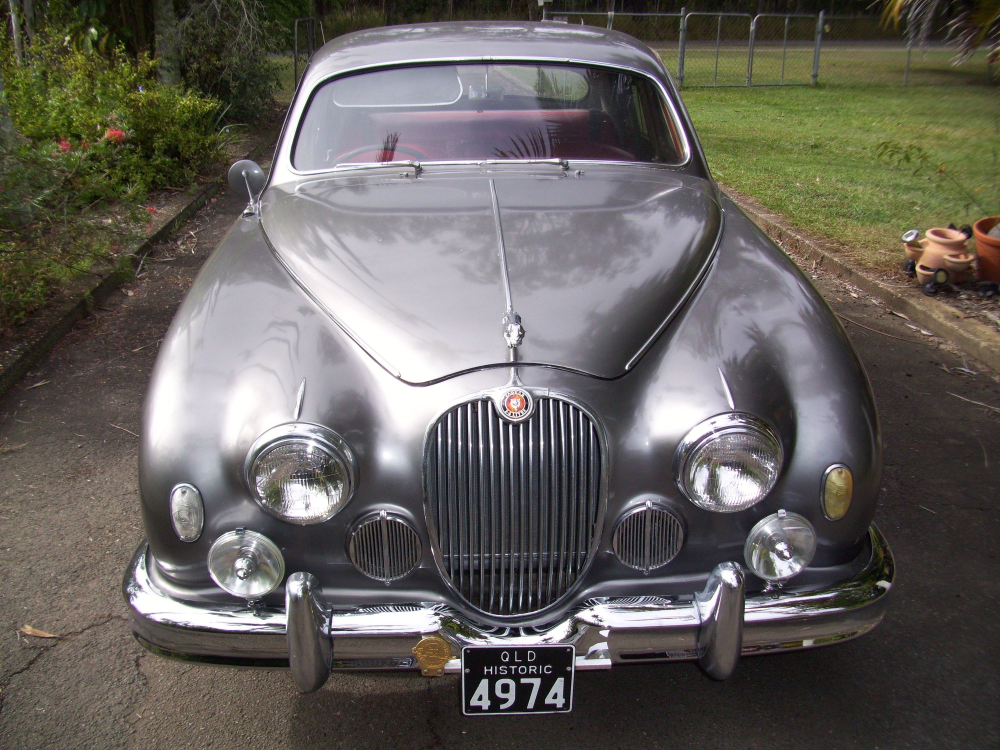

I enjoy "puttering along" in my 1957 MK1 2.4 manual. It gets lots of appreciable comments and waves.
I do not try to use it as a high-speed highway driver. Most of our highways are limited to 100ks/60 mph anyway.
I drive it with plenty of space from the preceding vehicle as the drum brakes are good but not really as good as modern braking systems.
In other words I treat it as a 65 year old vehicle should be treated and don't expect it to do more than that.
The only modification from stock standard is replacing the 1 1/4 inch downdraft Solex carbies and manifolds with 13/4 SU HD carbies mainly because I could never get the Solex carbs to tune properly.( This SU change became a factory option)
I use a 1996 X300 for highway driving. Comfortable, economical and reliable.
Trying to make a MK1 emulate this is sheer nonsense. Leave it as it is and enjoy the patina of an old car.
MK1 rear
MK1 2.4 1957
Old Nov 22, 2022 | 08:50 AM
Peter3442's Avatar
Joined: Aug 2020
Posts: 2,285
Likes: 1,458
From: Oxford, UK
Lovely car. Is the colour gunmetal or silver?
