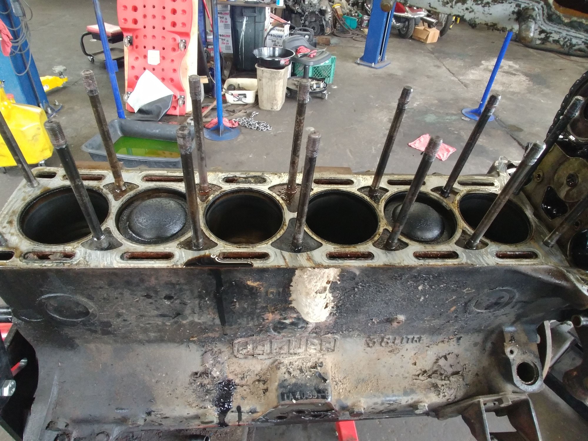

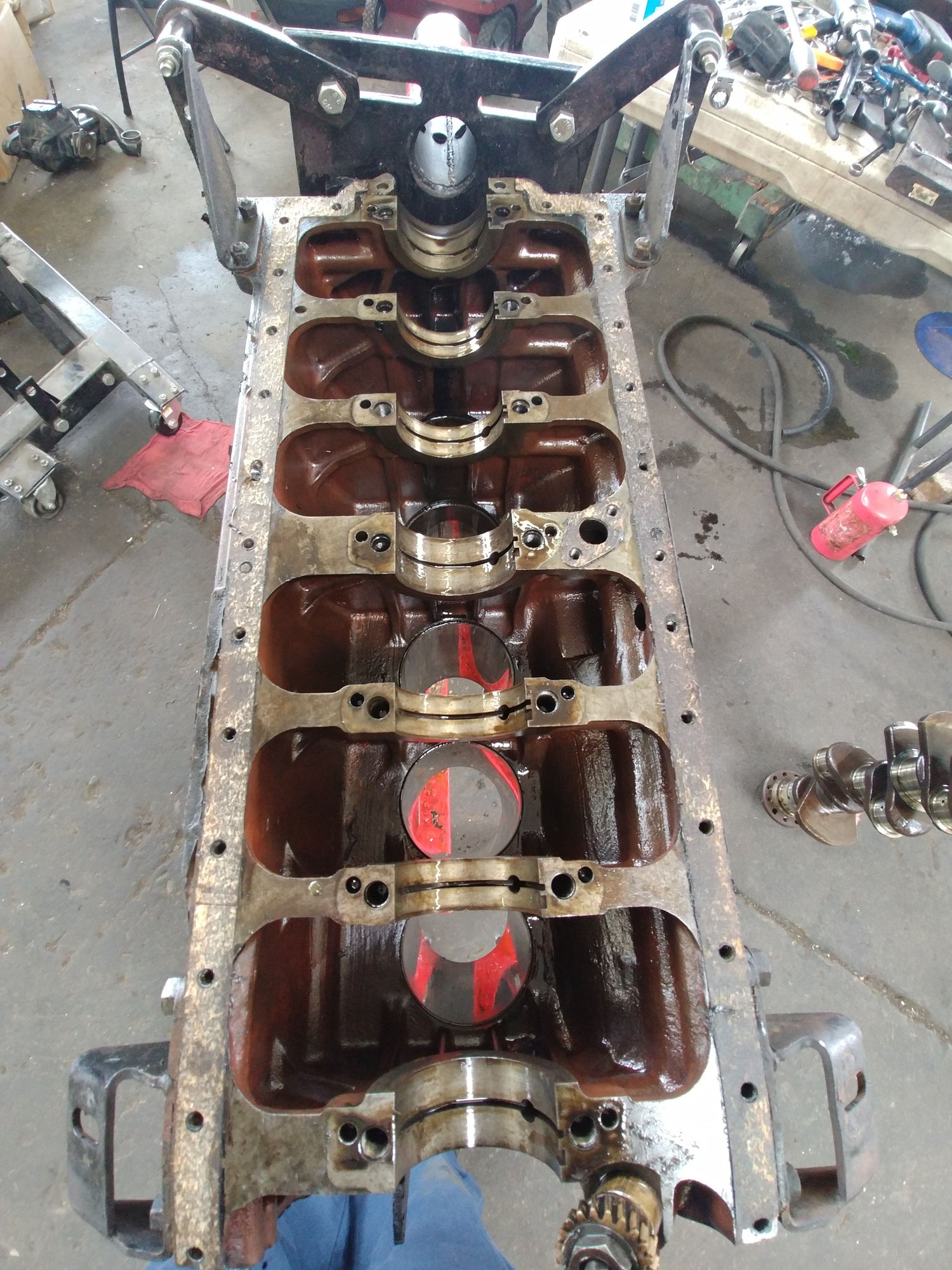

Default Result and solution
Hello all -
I hate it when I am searching for some information or help, and you find a post that seems to be your exact issue, but nobody bothered to come back and close the loop!...SO....I am doing there here for future readers.
The issue (primary) with this engine is what my mechanic (classic Jaguar experienced) thought might be either a stuck wrist pin, or piston slap, but likely a pin. I decided to have the motor torn down and rebuilt, because even though piston slap is often not terminal and many, many engines have long lives even with some slap (new engines seem to come with it from the factory) not knowing the true cause would be annoying, and, since I'd decided to KEEP the car and remove from the market, I figured I better just bite the bullet and get her done properly. SO! removed and disassembled....Verdict?......
Piston skirt drag on cylinder 4 and also some on cylinder 1. But as you will see below, there were other...erm issues....Most notably the fact that the support for the exhaust cam had been completely broken off. Whoever last changed the timing chain (it has been changed, that much is clear to see) must have used a sledgehammer. Unsurprisingly, the chain was also a few teeth off - which added to the noise from the unadjusted tappets and may have magnified the slap / drag on the piston skirt since things were somewhat out of time. Fortunately, the engine was very clean inside, and aside from the noted chain sprocket support, no other damage. The engine will be getting a hot bath next, new parts have been ordered and the crank is going in for its facial and manicure.
Hmm.....spot the one difference.....
So...there it is....that noise from post #1, is an engine with a drag on the piston skirt, that needs tappets adjusted, that is also at least two teeth out of proper time ...oh...and has a missing sprocket support.

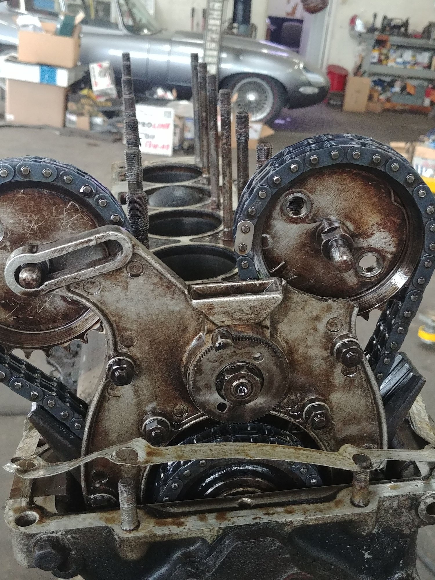

That looks like someone has given that a bit of hiding on the exhaust cam, although i'm sure you will change this part during your rebuild it doesn't actually do anything when the engine is running, it seems to just be there to hold the sprocket when you remove the cams to set the tappet shims.
Do you have any close up photos of the damage to the cylinder walls, I would be interested to see how bad they are for the noise it made.
Well done on the decision to rebuild the car, I don't think you will regret it as you can build it to exactly how you want it and will be safe in the knowledge that its all been done correctly and if there are some parts you don't rebuild at least you know what they are.

That loop is only used when lifting the head, as it allows the two cam sprockets to sit there and maintainn the ignition timing. Hope fully you'll be able to find another casting from somewhere. How somebody broke that off is a story in itself; Charlie Allthumbs maybe ?
