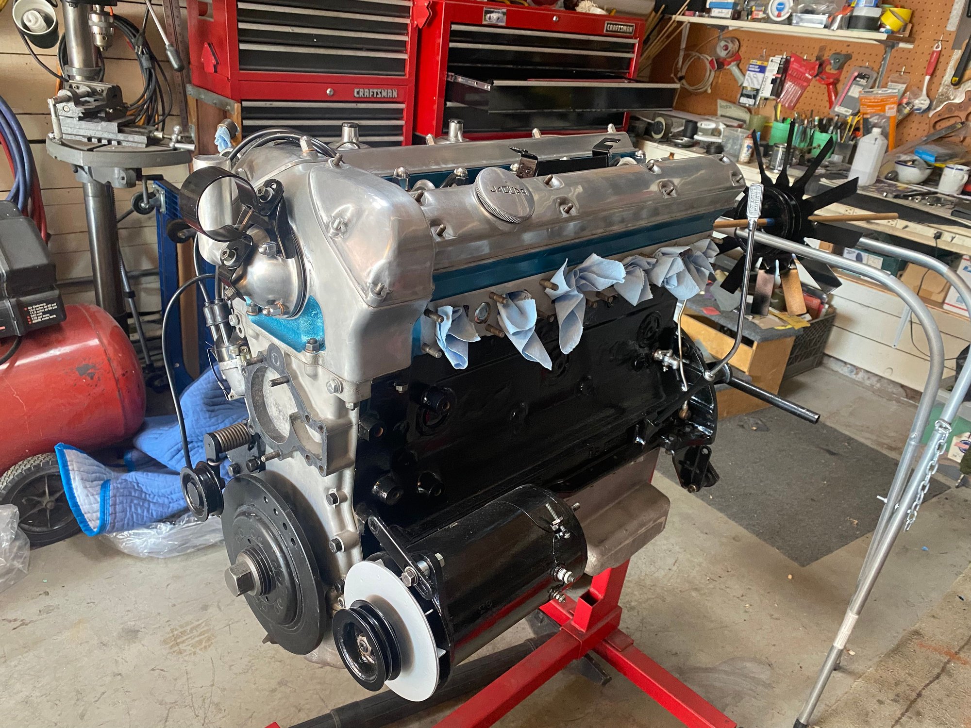

Suggested I put up some photos of the engine compartment. I've included a time line in photos of the work I've been doing over the last year and a half.

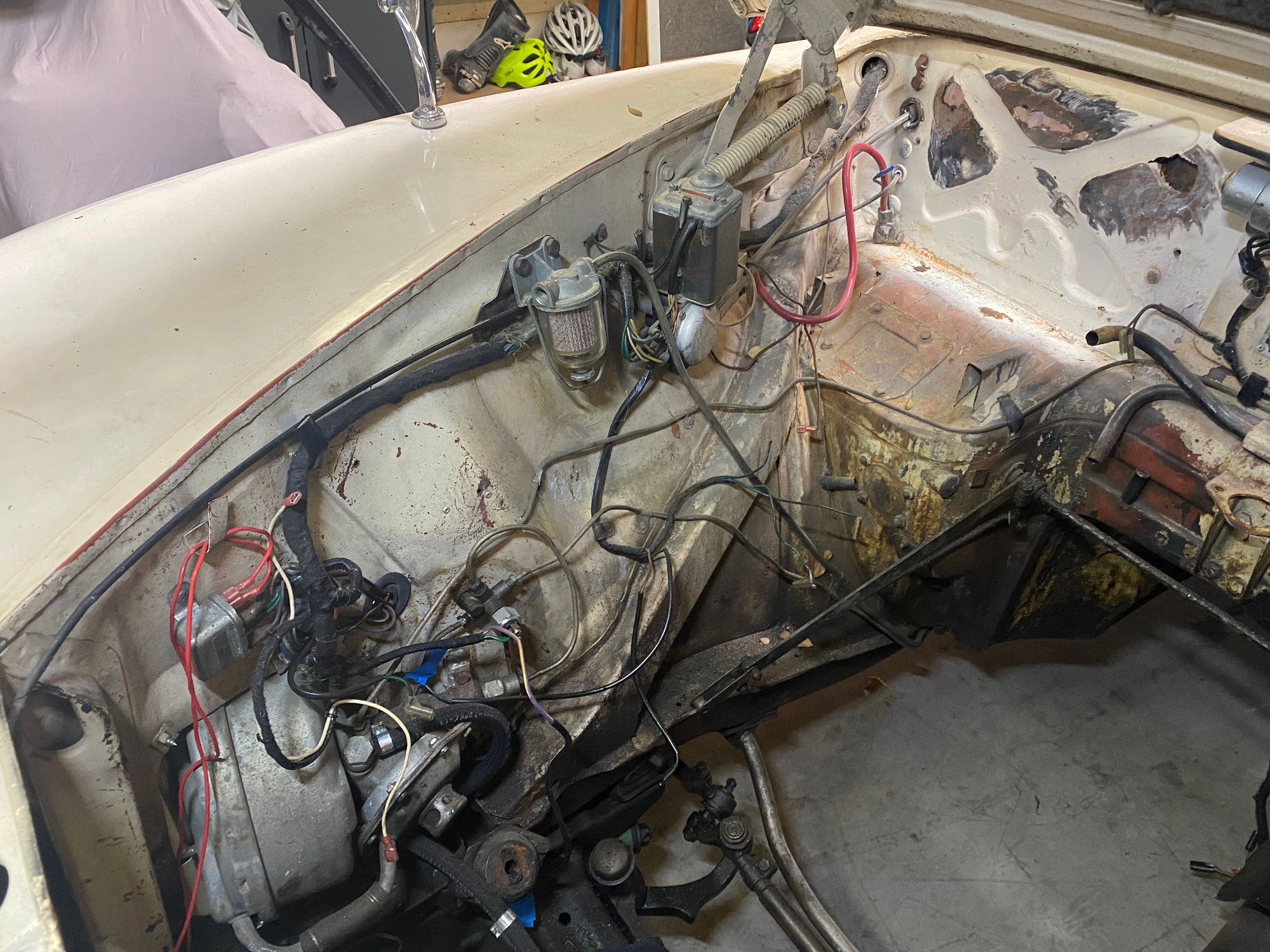

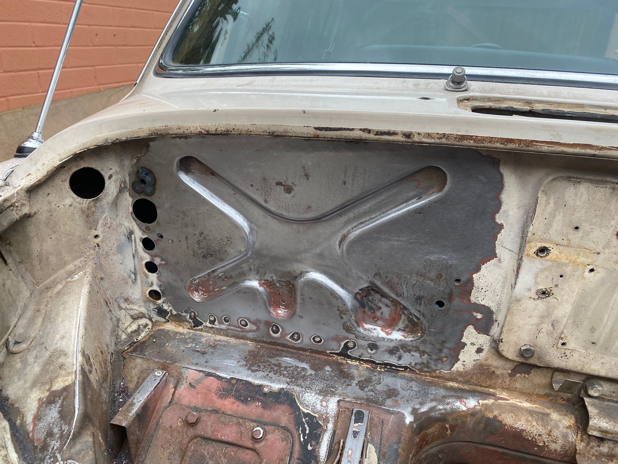

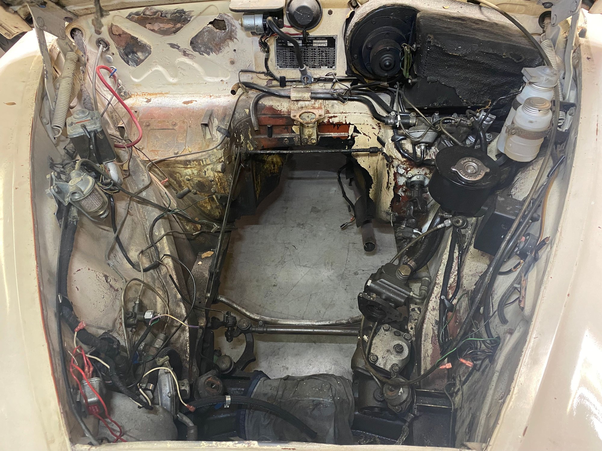

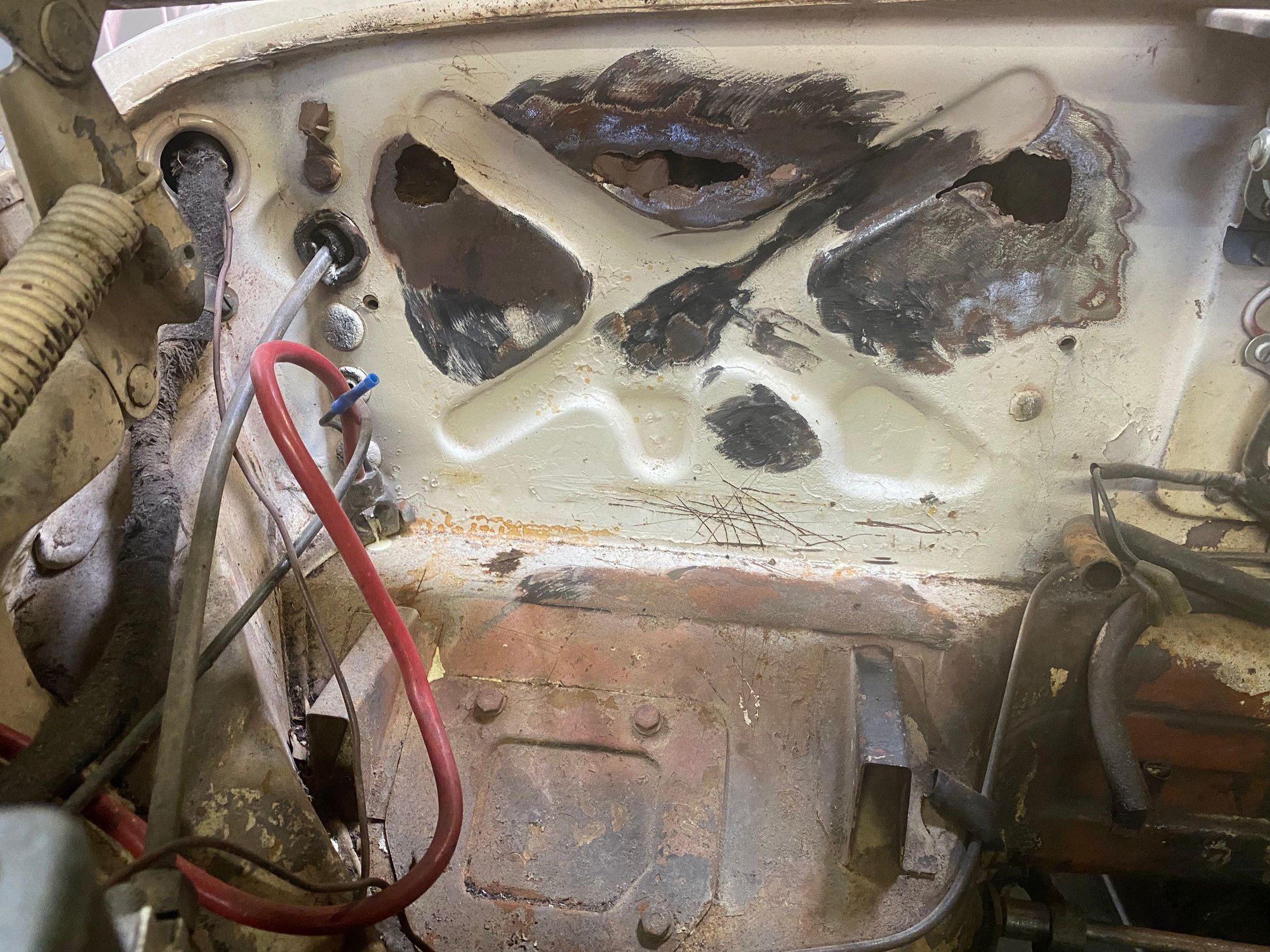

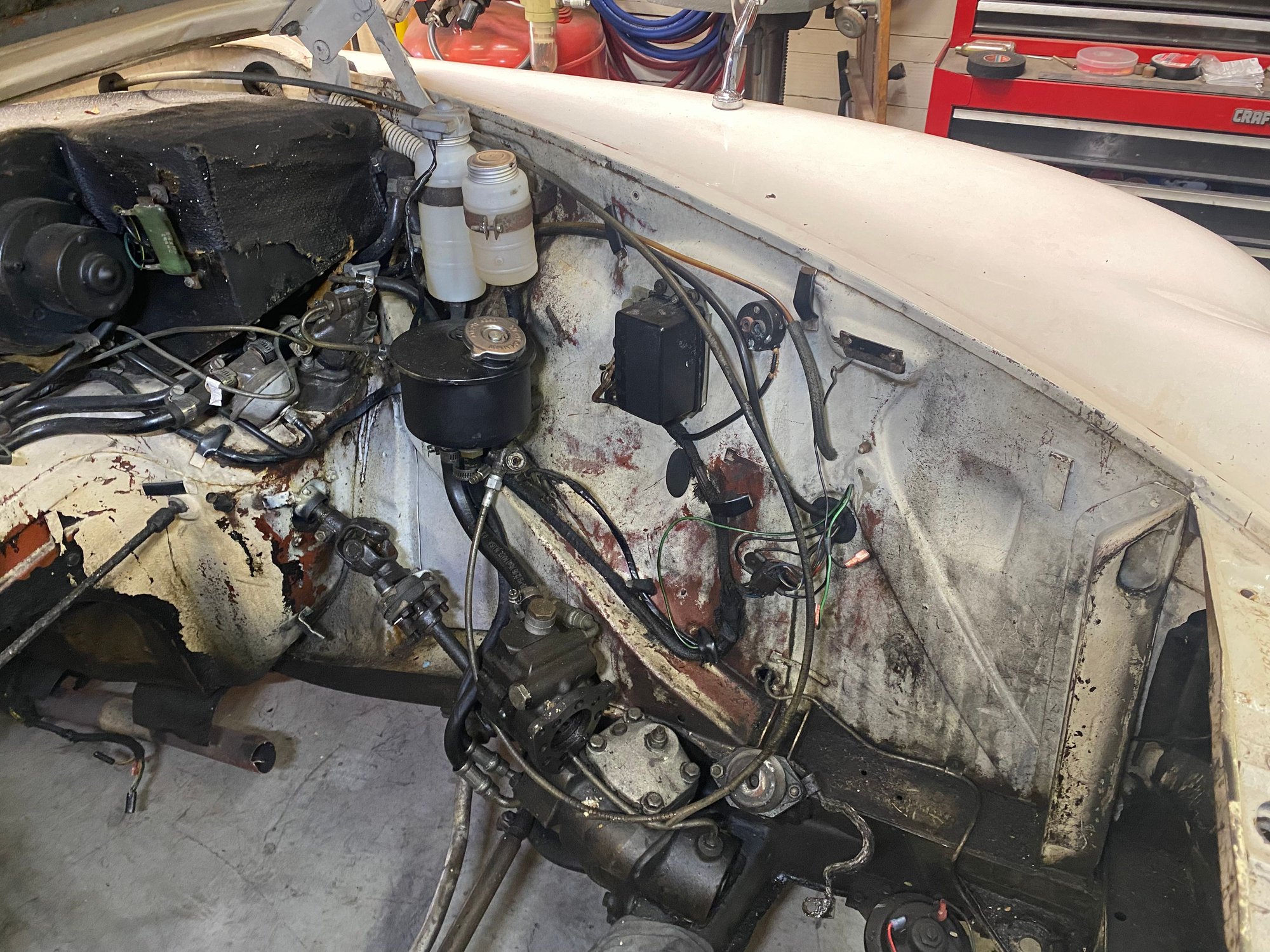

Engine removed and sad state of compartment. As can be seen on the battery tray. A battery exploded burning several holes in the firewall and then repaired with Bondo.
A lot of work to be done!

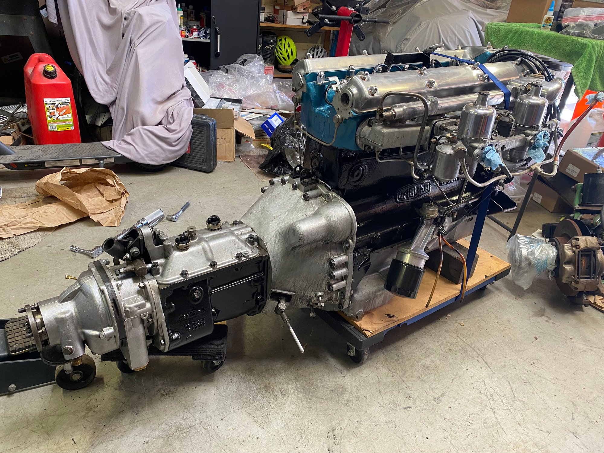

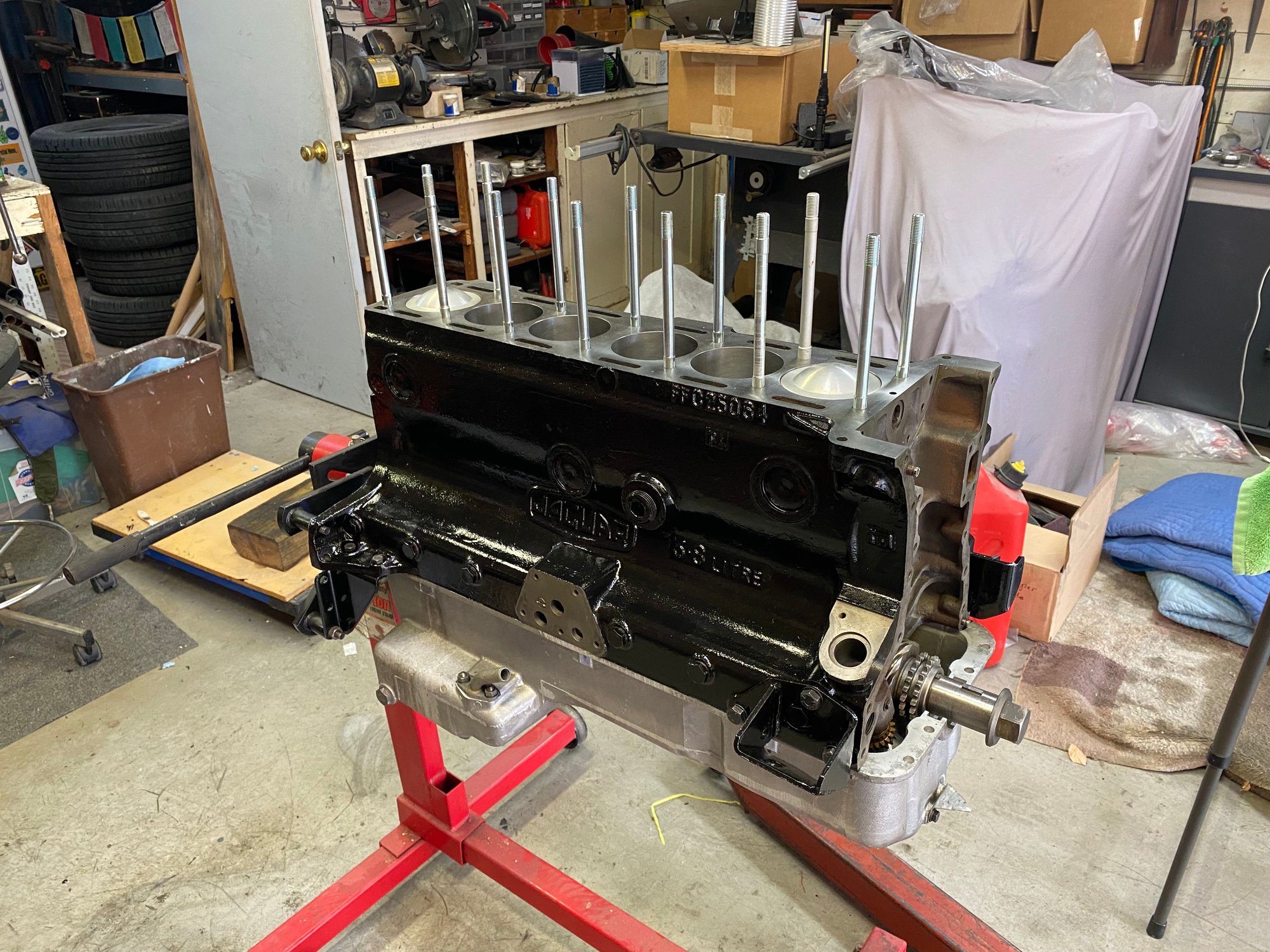

Engine back from machine shop with new pistons, bearings freeze plugs and head studs.

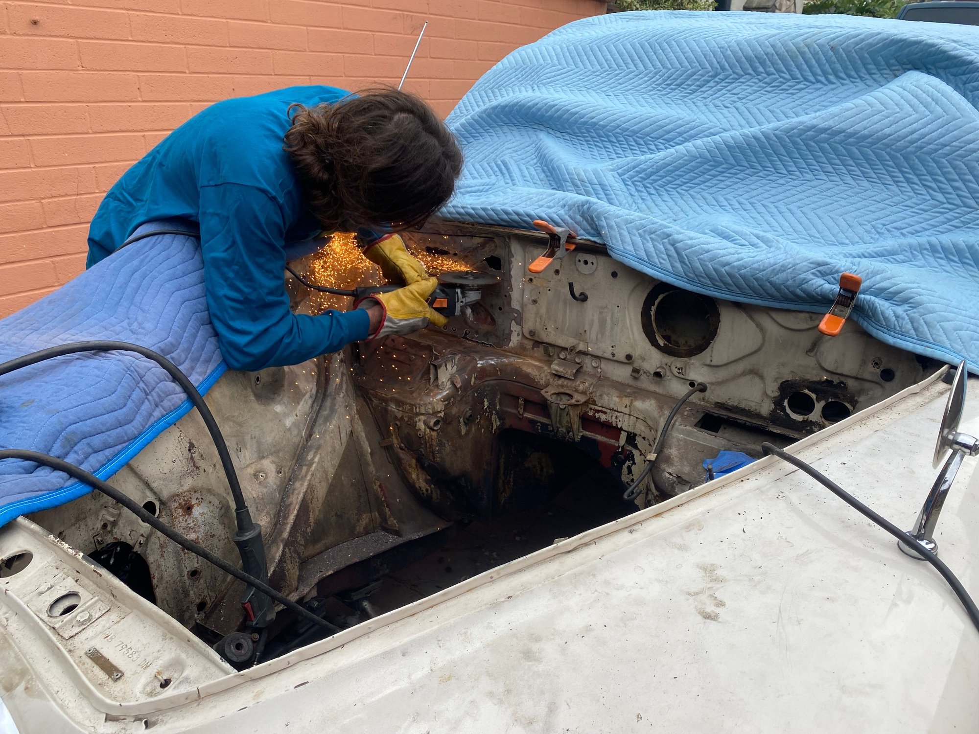

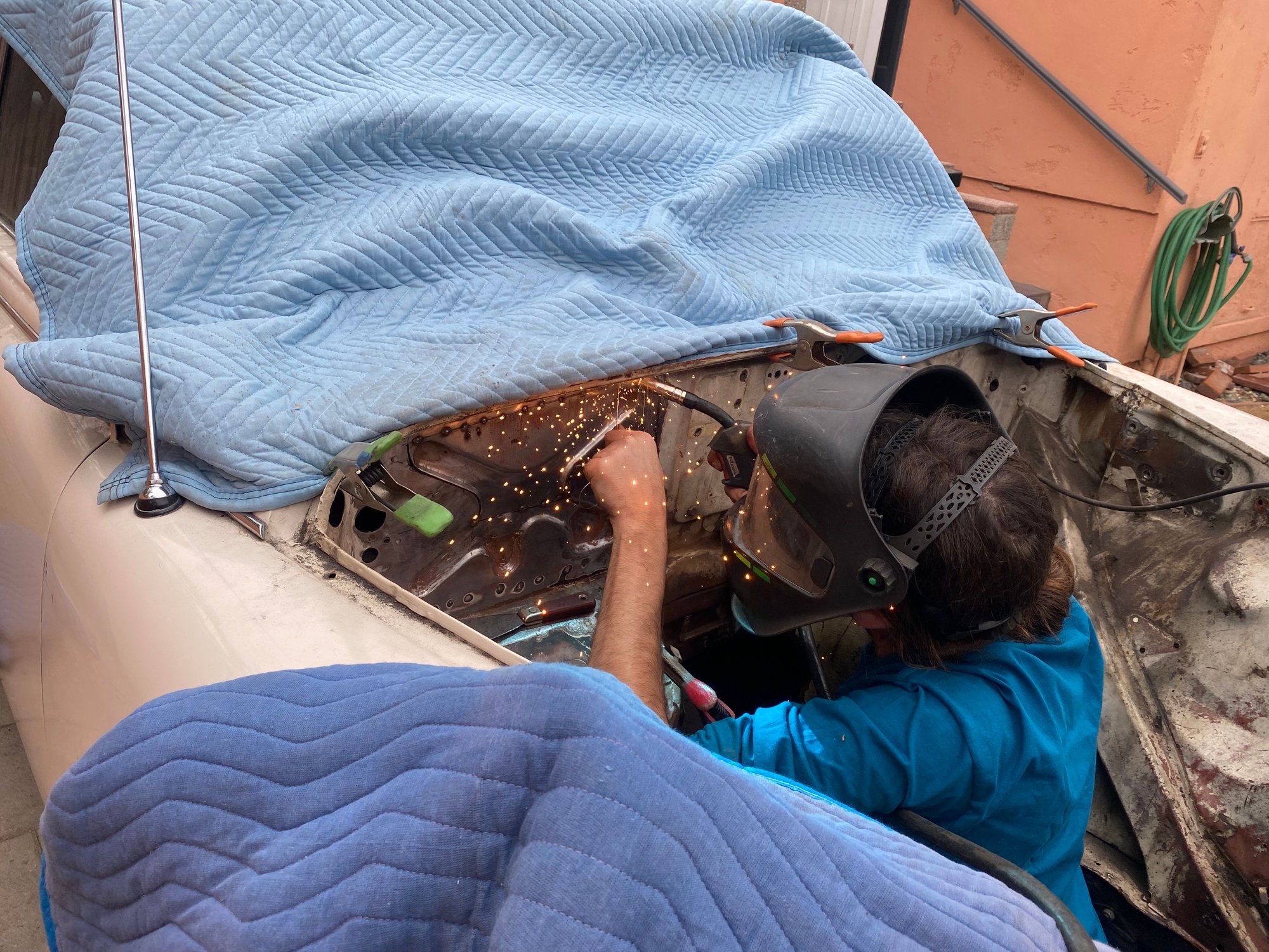

Firewall repaired
Rebuild head back on.

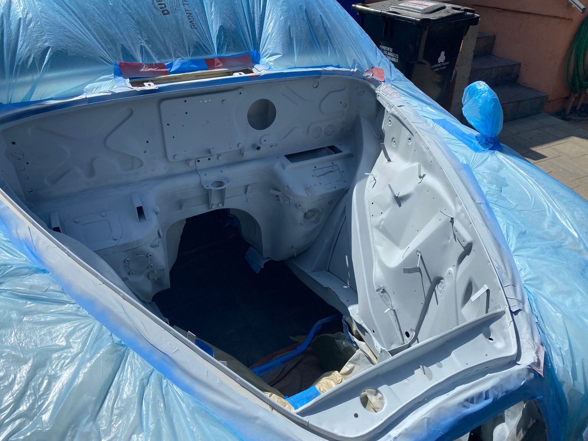

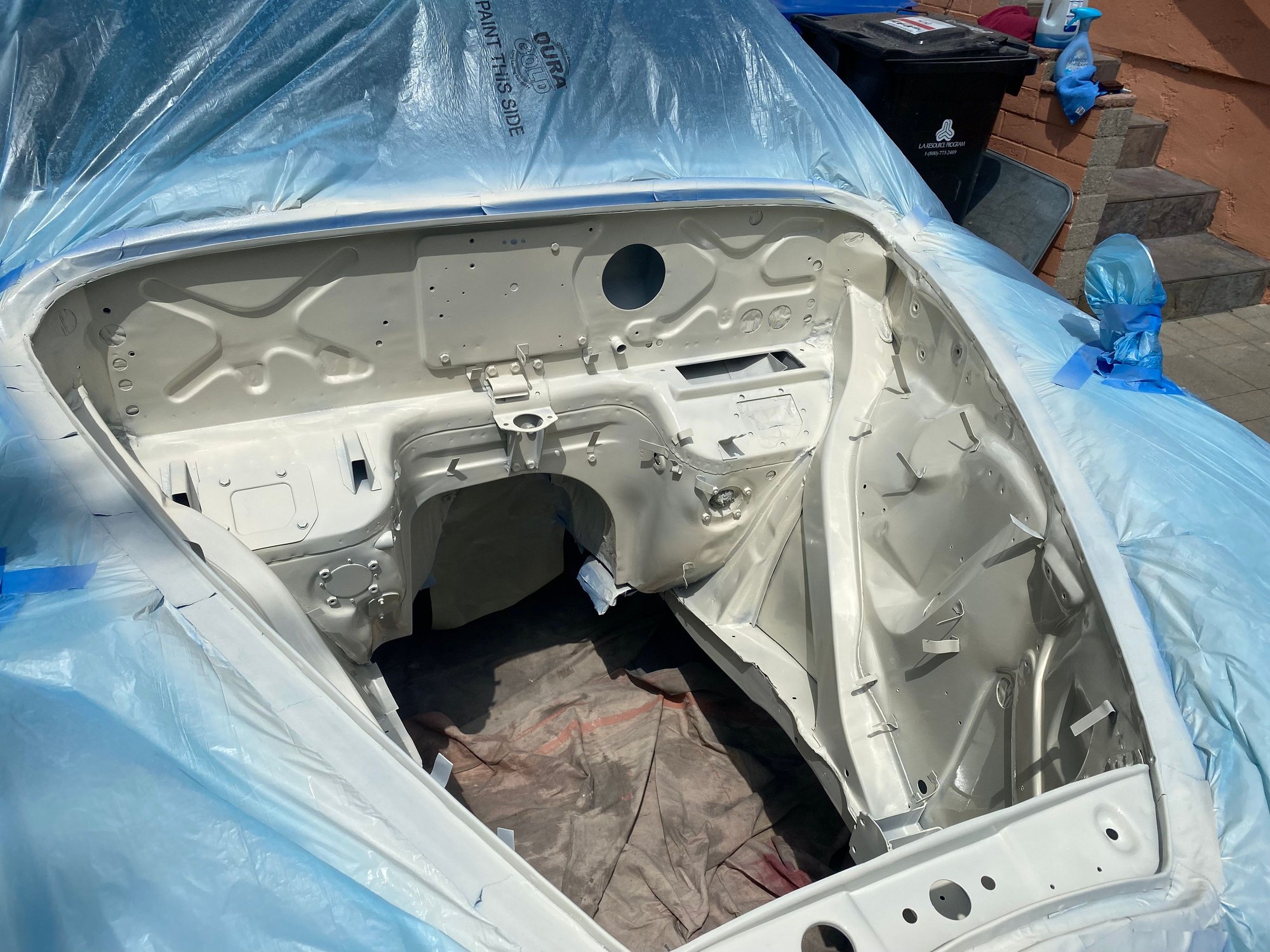

Ready for paint
Primer coat

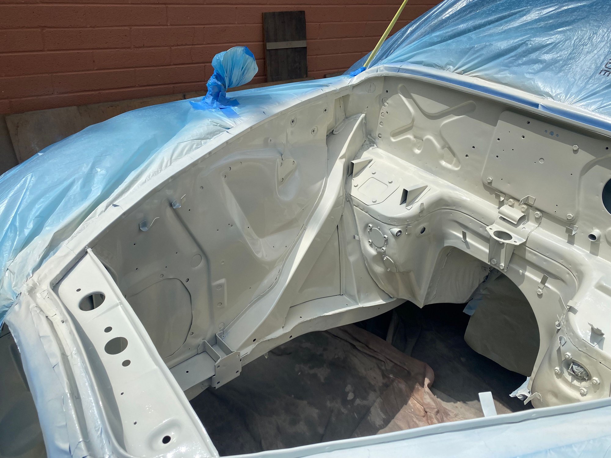

Three coats of single stage Cream Paint

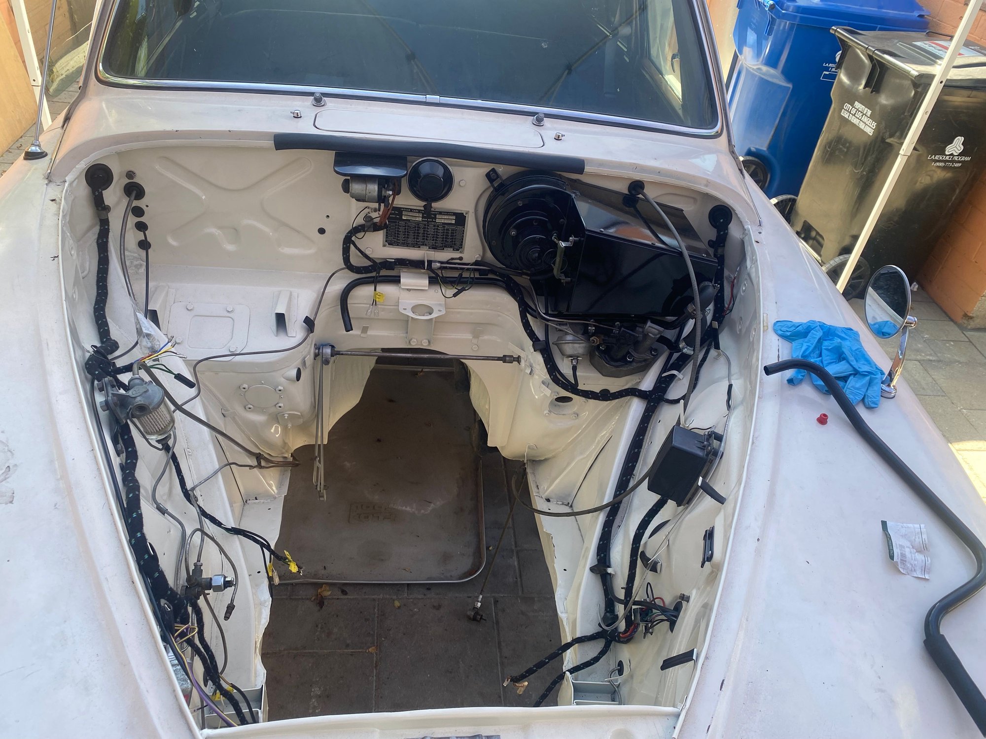

Engine and Trans ready to go in. Acid stains from the battery exploding can be seen on the bell housing.

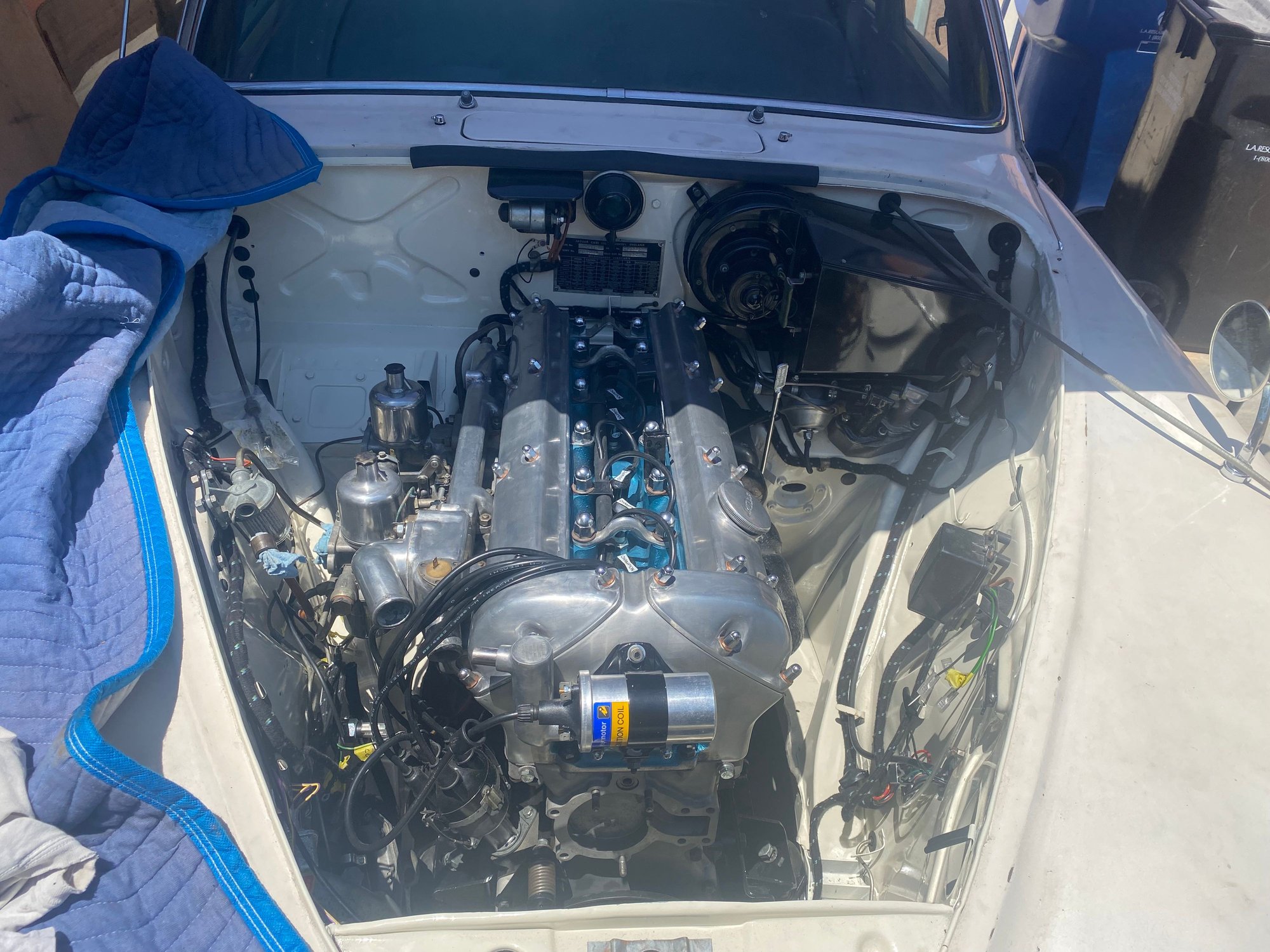

Engine compartment awaiting engine!
Voila!
