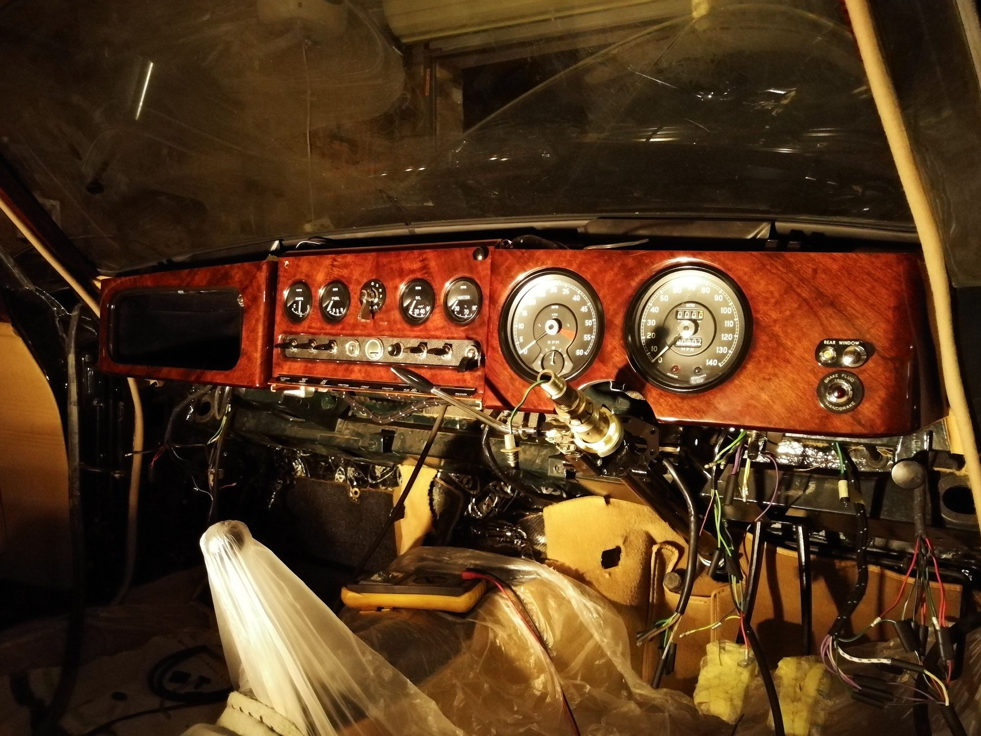

I'm delighted to hear that. A friend restored a Mk2 and went the cheap route of not replacing the wiring harnesses which he knew to be in a bad way. The fabric insulated wiring was still fine but the early plastic insulated wiring had deteriorated badly to the degree that some of it was cracking & falling off. Result was a totally burnt out restored Mk2. and it was a lovely car. It's not difficult to check harness insulation. In a car that has lived in a cold climate it will almost last forever whereas in hot Africa I replaced every harness in my car during restoration.
