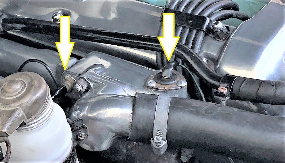

If the thermostat housing is still hot & the rest cool the temperature sensor is not seeing a true reading. It's right there.

The picture below shows the thermostat housing with the temp sensor indicated by the arrow on the left and the Otter switch indicated by the arrow on the right.
