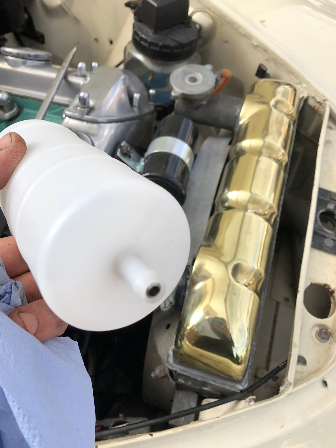

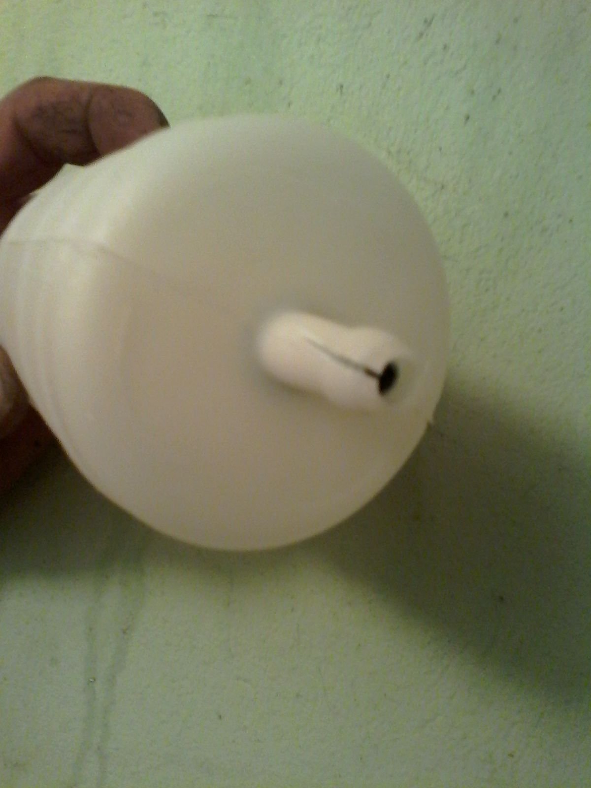

You may find that the bottom of your brake fluid reservoir is cracked and leaking fluid. Common fault on the old reservoirs as the plastic becomes brittle with age. The crack is caused because the nipple on the end where the outlet pipe is attached is not reinforced and cracks where it joins the flat base. The new one that I bought has a metal sleeve inserted in the outlet tube which strengthens the outlet and it no longer cracks.
First photo of the new one with the metal sleeve. Now been on the car for 5 years and no problems.
Second photo is the old one that I had repaired a couple of times with Araldite but after time it too cracked again.
New brake fluid reservoir with metal sleeve.
Old brake fluid reservoir with several repairs.
haha...BINGO!!! you win the prize.

This is also common on new metal reinforced bottles. Excuse poor picture. Barratts replaced FOC.
