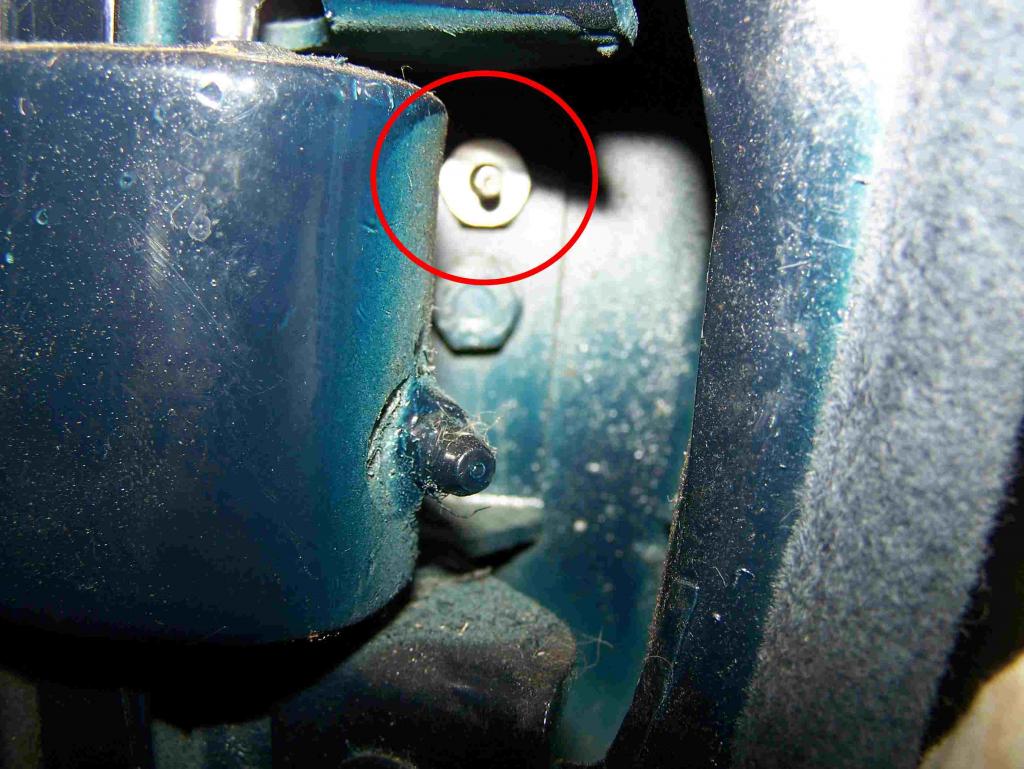

3) Are there door swiches for the interior lights? Mine work on the panel switch only.

3) The door switches are behind the door hinges _ they are hard to see unless you know where to look for them. They probably need cleaning or replacing, but you said the restoration wasn't finished, maybe they were not connected.

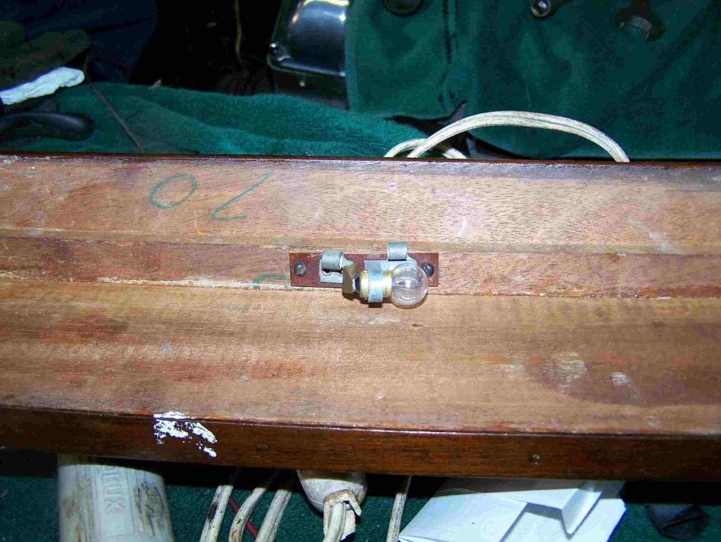

Regards map light....the space below the wind screen under the wooden finisher has nothing. I cant even see where it was! So I will have to get all the parts and figure it out. ( any body want to send a pic??? roger_tipping@yahoo.com

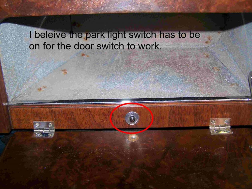

Likewise the glovebox....no switch or light fitted. Likewise any pics??
The door switches are also invisable....any pics so I know where to start??
Many Thanks

I'll take some pics tonight. The glove box switch should be obvious, there is a button that makes contact when it's opened and when the door is closed the switch head comes in contact with a round metal area on the lid to shut the light off. The light itself is a blue plastic cover on it tucked up inside the glove box itself.
I also have my dash cap off, it will be very easy to take a photo of that.
The door light switches are behind the bottom hinge on the front (you need a flash light to see them) they will be there or a hole where they are supposed to be. The rear ones are right in the middle of the door pillar and are clearly visible.
I'll post the photos here...

Sure there are no screw holes for the map light fitting at all ? It screwed onto the underside of the dash top rail.
Glovebox light is as described, and there should be a hole in the box liner to take the light fitting. It sounds like you may have aftermarket trim in your car. I remember onmy Mark 2 getting new arm rests for the rear doors, and the Ambla covering was without the hole for the ashtrays, but underneath the rectangular hole was punched so it was fairly easy to fit the little chrome ashtrays. Of course most people don't want these any more !! Still nice though, as they are beautifully chromed with a little Mazak ashtray below.

Thanks for the help..The pics are a great help. The glove box has been reupholstered and the light fittings and switch are not there!! Same with door switches...not fitted Dont you just hate a half done car!!

the glovebox light will come on only when the Headlamps switch is in any of the ON positions. (parking/headlights/fogs).
The headlamps do go OFF when the Fog position is selected at the switch.
if you can't find a replacement glovebox light assembly, I have one from a 1964 S type, similar to the one shown in the pictures, I also have the lid switch.

1) Map light assembly with original bulb, 2 screws, and 2 wires with the proper
Bullet connectors. (these connectors have a "Stop" unlike other bullets.
the remaining wiring was part of the Main wiring harness, so I had to cut the wires to salvage the assembly. You'll have to splice them unless your harness has the two bullet connectors.
2) glovebox door spring Switch for glovebox lamp. Lucas-England.
