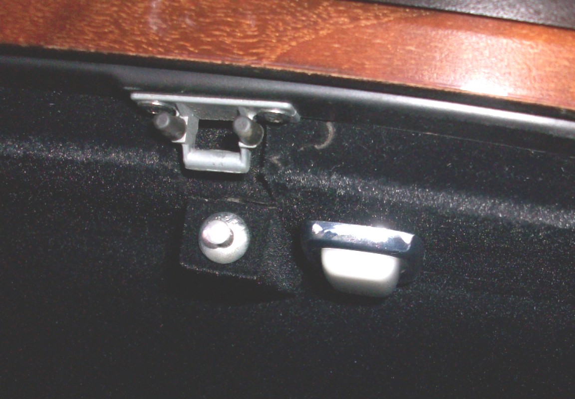

I made a discovery yesterday, I'm going to share it here, please send any $$ donations to me
The Discovery:
First: I own a 1965 3.8 'S' and also a 1984 XJ-6 (Series 3).
yesterday I was warming up the XJ-6 and started testing all the lights, windows, everything electrical, everything worked except the glovebox lamp.
(NOTE: in the S type and the XJ, the glovebox lamp comes on ONLY when the headlights switch is in any of its 'ON' positions, so keep that in mind).
So I started fiddling with the spring-switch, sprayed a squirt of WD40, got it working again and all of a sudden it dawned on me:
it's the same LAMP as in the S type and almost identical switch! Actually it's even better because the lamp housing in the XJ is chromed, but the LENS is WHITE as opposed to the BLUE LENS in the S type and MK-2. Otherwise identical parts except for housing finish and lens color.
I'm now thinking the lamp is the same in the 420, and the XJ-Series 1 and 2 as well, not to mention other Jaguar models.
so...for those looking for a glovebox lamp and switch for their MK-2 or S type which they can't find, go to a Series 3 XJ-6 or 12 and you can "extract" the glovebox lamp and switch from it.
Here's a picture of the XJ-6 glovebox lamp and switch. Fresh from yesterday!
