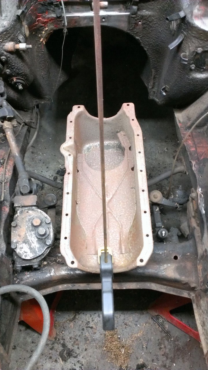

Have you trial fitted the chev yet? whats it like for clearance?
Old Oct 1, 2014 | 07:56 AM
blurooster's Avatar
Joined: Sep 2014
Posts: 152
Likes: 17
From: knoxville, tn

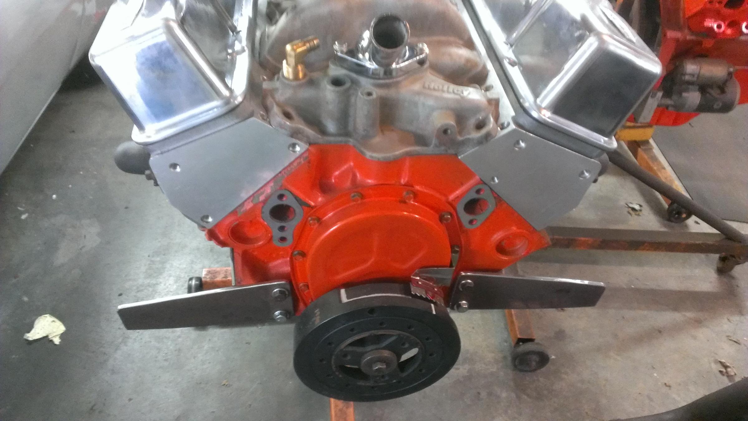

I see no problems, if you use stock old rams horns or tight fit headers. A GOOD exhaust guy will have no problems, a r&r guy will whine a lot. The front motor plate sets across the frame rail. The back of a Chevy block is 17" wide so the mid mount is shorter.

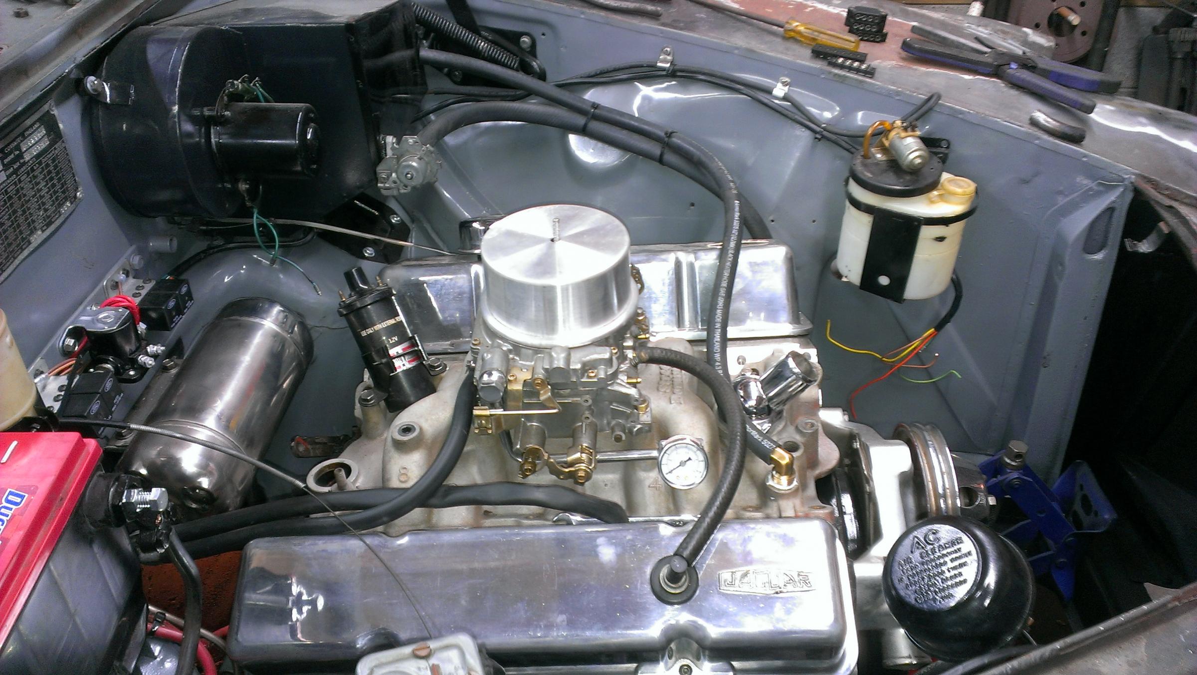

Engine is in, tight fit, but in. Pictures when I get back to my desk top. I had to make some adjustments but nothing serious. I may have to bite the bullet and get some coated headers to protect my engine bay paint and make some heat shields and insulate.

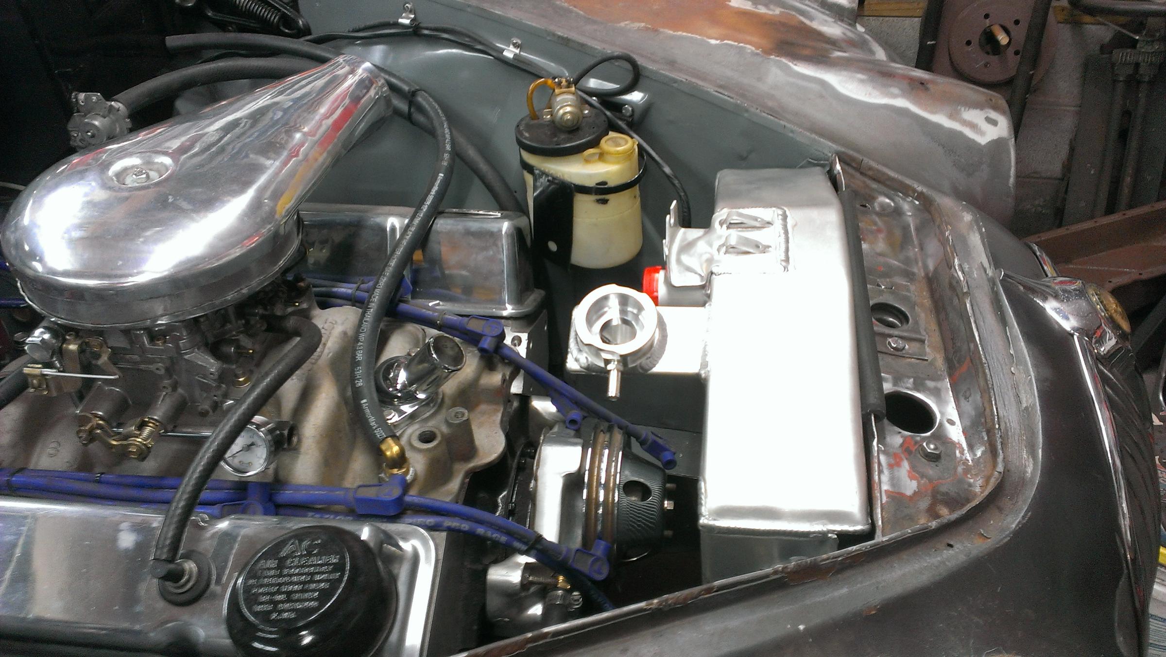

Sourced a 32 Ford aluminum radiator for $150. Only minimum
mods to car.
Old Oct 17, 2014 | 09:09 PM
blurooster's Avatar
Joined: Sep 2014
Posts: 152
Likes: 17
From: knoxville, tn
Radiator is mounted and a little more pretty work and I am done.
It was for a big block Chevy in a 32 Ford so it should cool.
Transmission cooler mounted also.

more build pics
Attached Thumbnails progress on MK2-radiator-1.jpg   progress on MK2-vacuum-tank.jpg

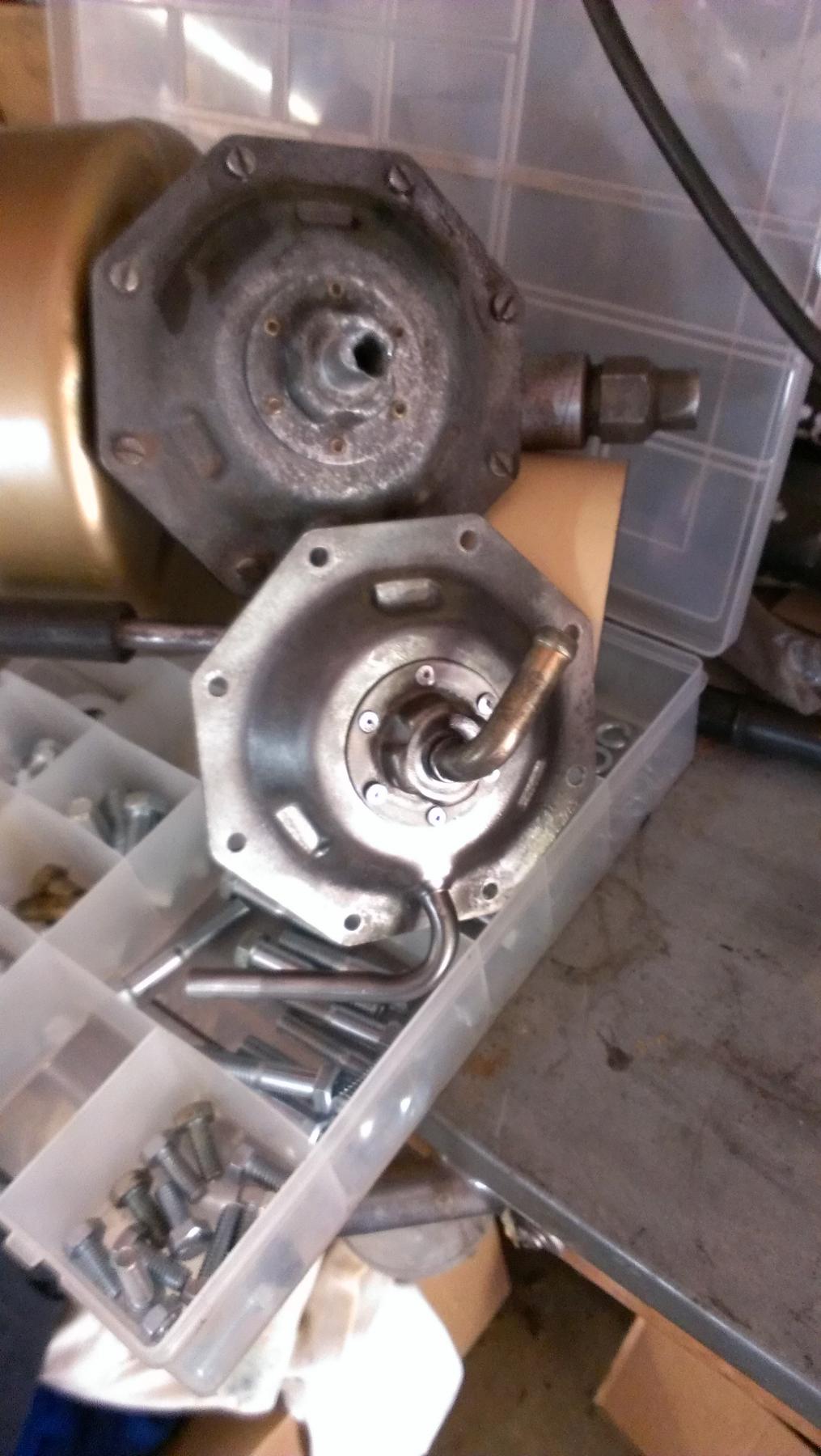

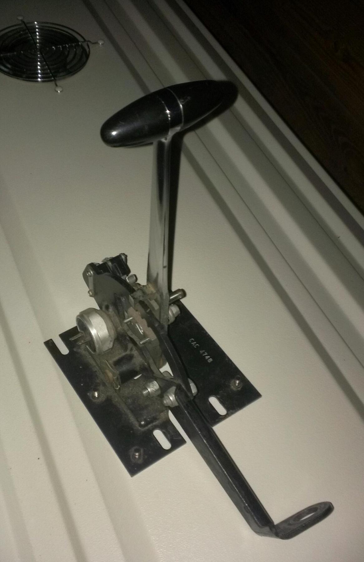

Sanderson tight fit headers will be used but are $$$, gathering up sheckles for that purchase. Probably use 2.5" from collectors and maybe long glass pack mufflers? Not a lot of MK2 owners in town to get rid of these extra parts to finance the new stuff. picture of modified xj shifter for 700r4 and modified booster to eliminate pricey hose.

Nice underhood shots. I can't help looking at it and thinking there is room to move that V8 back about 6 inches without too much cutting. Not suggesting you should have done it, but I want to.
Old Oct 22, 2014 | 12:35 PM
blurooster's Avatar
Joined: Sep 2014
Posts: 152
Likes: 17
From: knoxville, tn
foot boxes would have to be cut and gas pedal moved. I am not sure about trans clearance(jag is small). I did mine this way because I really didn't want to cut up the floor since upholstery is fair. The only real advantage would be weight distribution and since I am already much lighter than the Jag I felt it would be a lot of work and little or no gain.
aluminum heads, manifold, radiator and pump. plus headers
