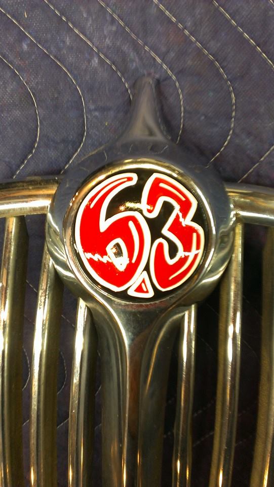

finished my new grill emblem

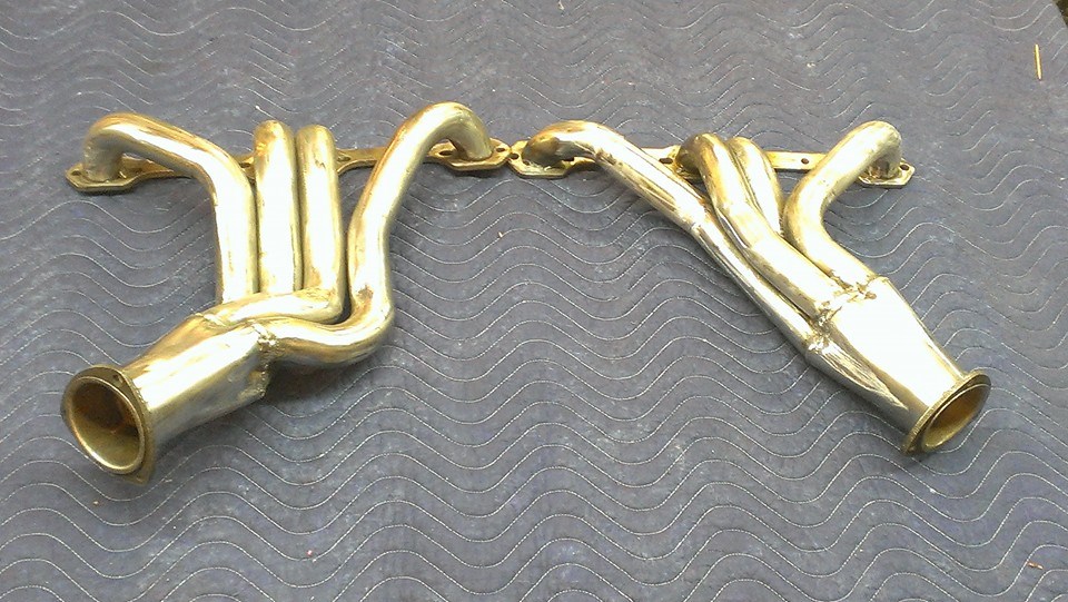

Header guy working on right side header mods. I will post pictures before they go to ceramic coater. Gas pedal and trans TV cable bracket finished and painted. It has been cold here and I have been a little lazy.

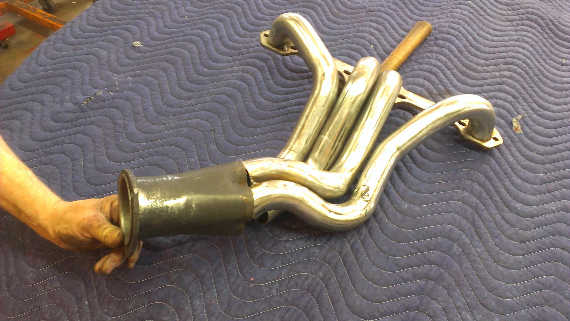

right side getting finalized, left side easy. I have lowered the anti sway bar 2" and shimmed the steering box 3/8" to the outside. So far no harder to fit than a Camaro. The headers are 1 3/4" and the exhaust will be 2 1/2" run like factory.

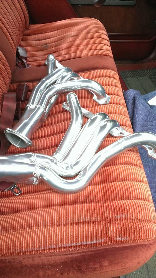

headers are getting coated, total cost involved $175.00

the headers are back and installed and the hood back on after 8 months. The cold air was moved to make room for a/c and a mk10 style package tray unit. my mini starter was bad but a new one will be here Friday. Drive shaft is 47" c-c and I am working on that now. I am getting excited about building a fire in it!
Attached Thumbnails progress on MK2-header.jpg   progress on MK2-april-2015-1.jpg   progress on MK2-april-2015.jpg

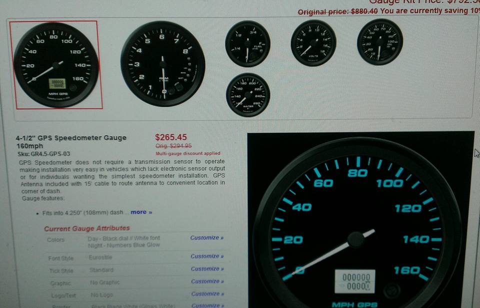

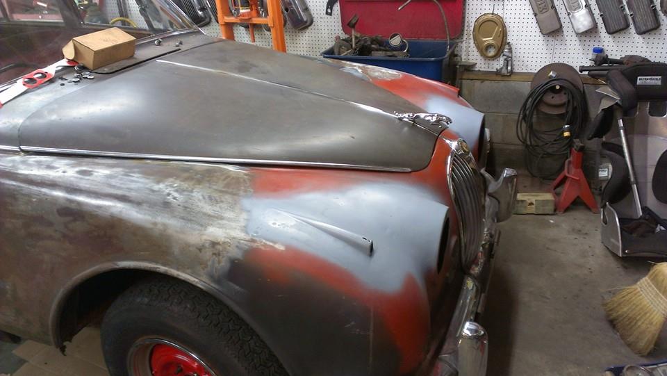

Ordered my new GPS gauges from Speedhut. Drive shaft cut and rearend finished.
Attached Thumbnails progress on MK2-11227058_10205095413238759_1080530962181103098_n.jpg

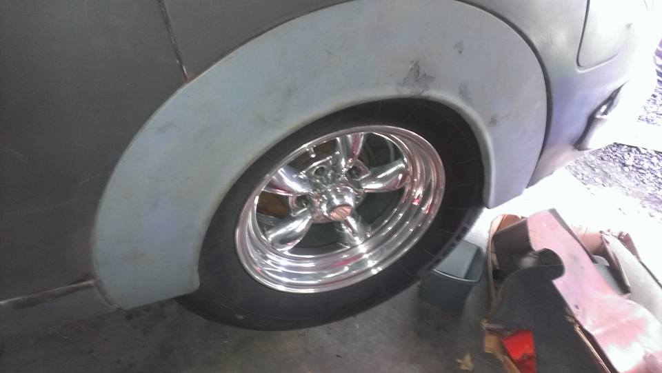

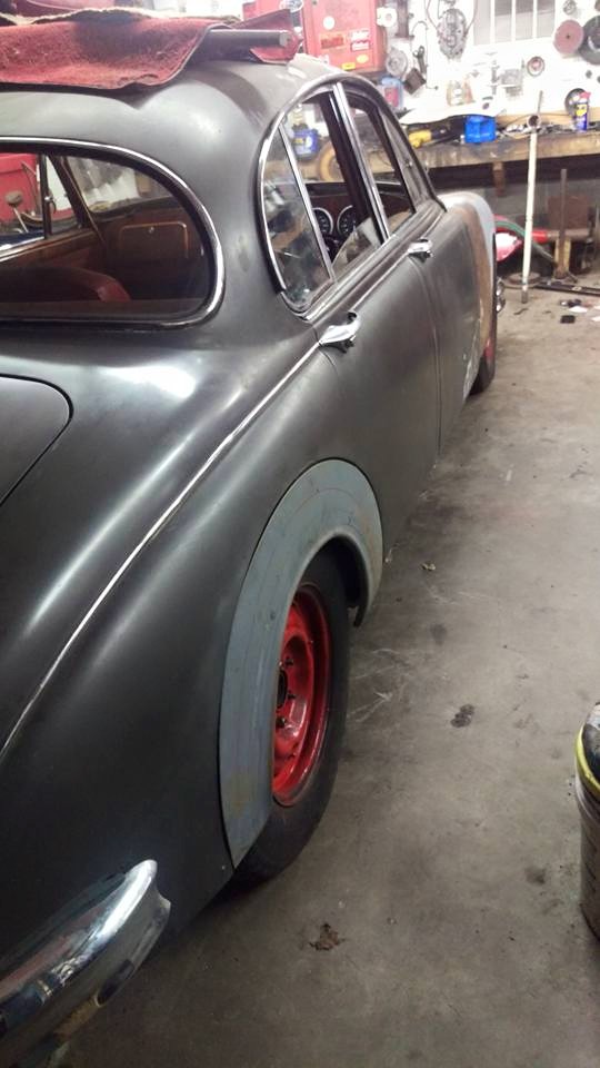

wish I could get the offset I want in this wheel. My widened steel wheels will look good though and appear more stock. The three inch tailpipes, widened wheels, tinted windows and 6.3 grill badge should be just enough to hint at it's performance potential.

If you spend the money for a 3 piece wheel you can easily run a 17" x 8.5" or 8" and run 245 wide tires on all four corners. That is what I am running 17" x 8.5" with 245 40's on my 3.8s

I am more "old school" and don't care for the big wheel small tire look. I like the old big wheel narrow tire look from the 60-70's. The road wheel for the rear is 15x8 with 6" b/s, fronts are 15x6.5 with 4.5"b/s. I finally got my starter worked out and hope to start her up this week end. I have deal working on a Corvette and the normal home projects to worry with.

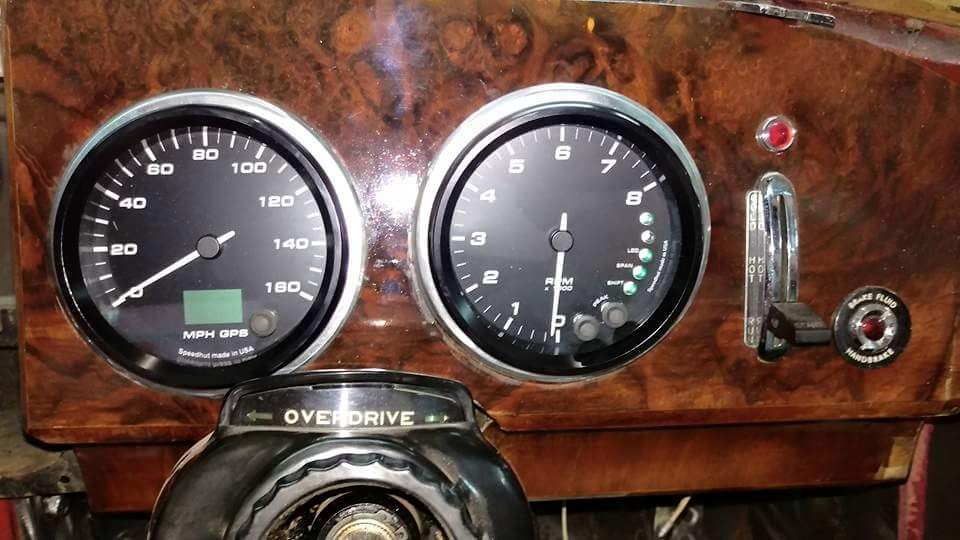

Speedhut GPS gauges arrived and I am happy! They are beautiful, I will have to modify my pre-wiring a little they come with a lot of wire. My adapter rings for the speedo and tach are done in stainless(gauges are 4.25 and Jaguar hole is 4.75)and will be painted black(maybe) to match the bezels.

Love the gauges, hints at a performance update/modern revamp of the car while still keeping everything beautiful about the interior of the old Jags

I , like the shiney against the black
