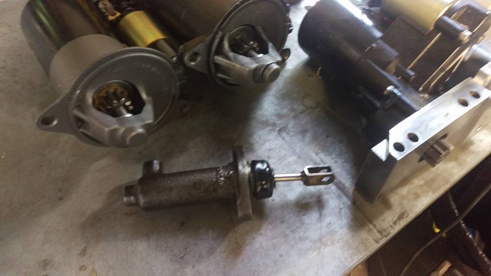

rebuilt the master cylinder and replaced
