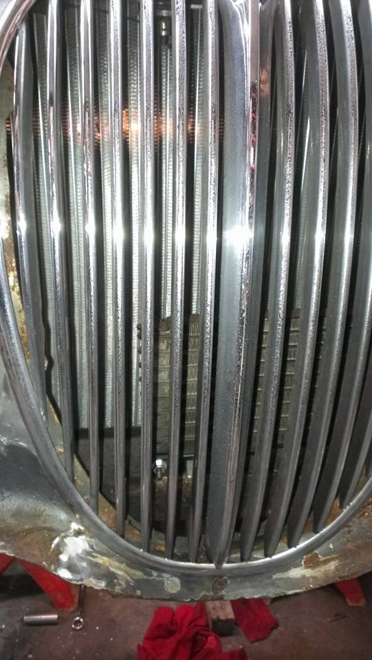

Removed the 32 Ford bracket from the top of the radiator and finalized top mounts. Blew leaves to the curb and started my tree house. how did your evening go?
Added a pic of the trans cooler, must paint radiator black.

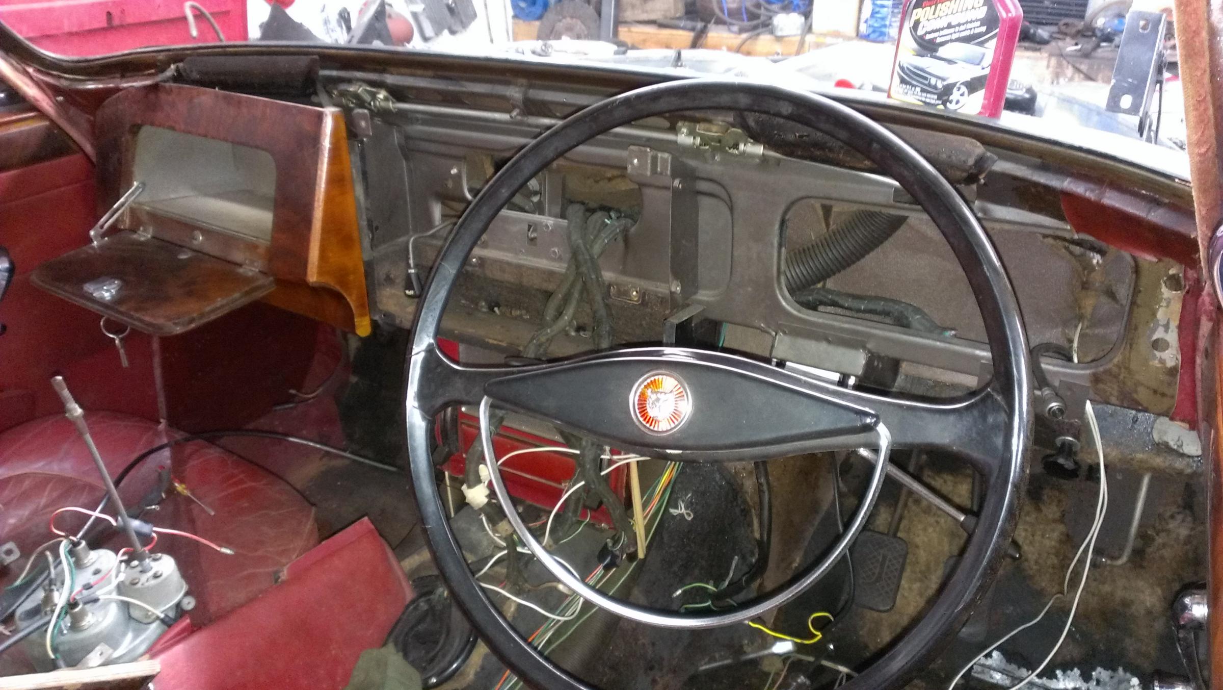

Pulled the dash out cut all the wires, what a pile. I am too old to try to wire this one laying in the floor. Now I can see everything and fix a few problems. Very interesting prodction methods used. Pictures when I have less mess.

I noticed that a previous owner had cut all the wires on the back of my dash. I thought they all unplugged? Fortunately I will be custom building, so no need for originality.

Mine looks like the proverbial dog's breakfast. And after 50 years, all colour coding has long since gone. This part of the restoration I'm not particularly looking forward to!
Does any one know if auto wiring has a use by date? No point I guess in mucking around with it if all the copper cores are oxidised.

The wires were probably cut because that is the easiest way to strip it. I have wired hundreds of hot rods from scratch (my preferred method) and wire does not have a "use by" date..lol. It really isn't as hard as everyone make it out to be. Research, study and do one circuit at a time until you get comfortable with it

It is possible to buy new wiring looms for Mark 2s and other 60s Jaguars. All the connectors are reproduced and the lovely braiding covering the wires. Two looms run through the sills each side. If you remove them, make sure you pull through a tracer wire or string when punning them out, to get them back later !

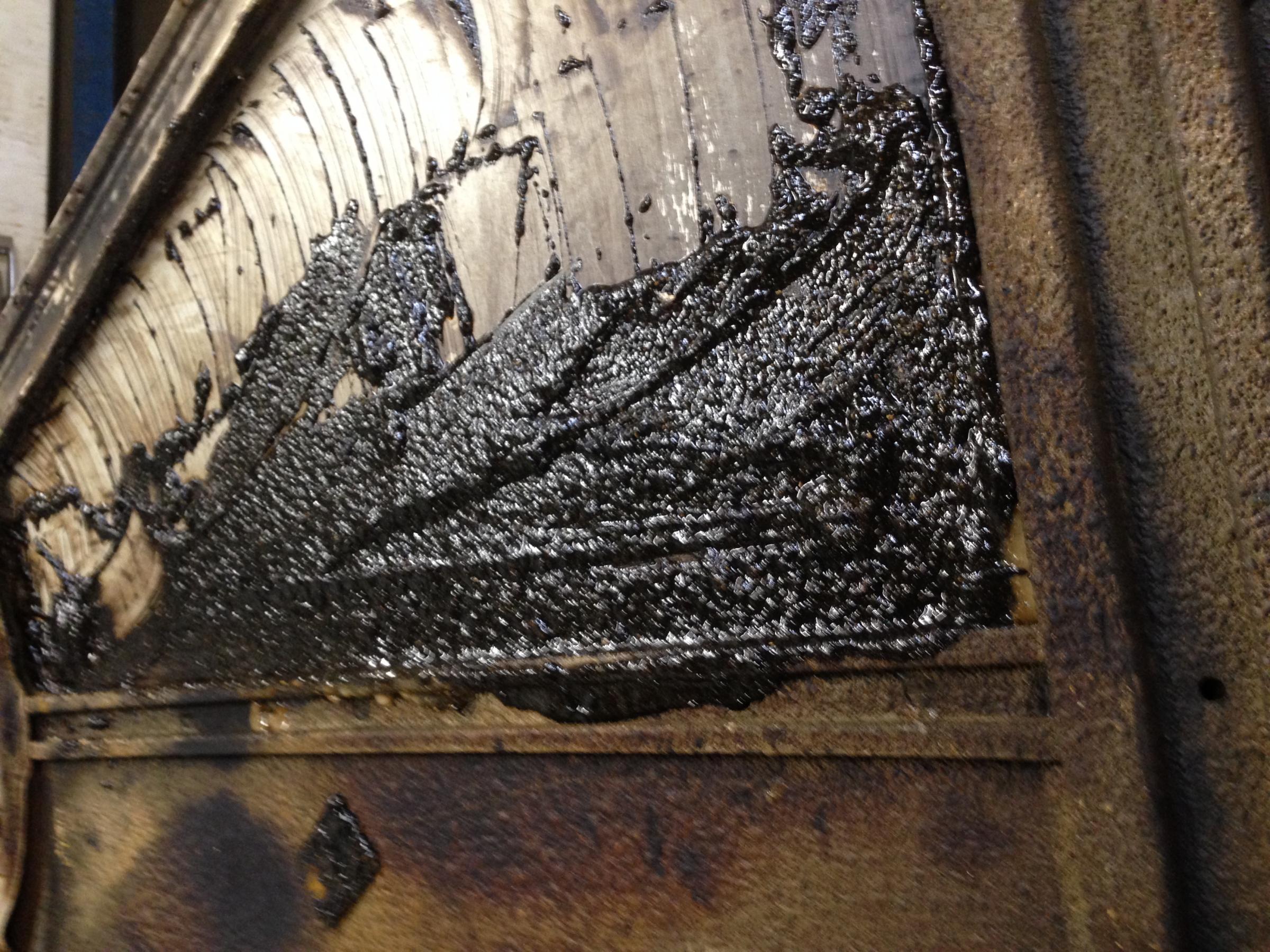

trans is in and now to fabricate the clearance panels, I have learned to hate the sound deadener. I hate that I can't restore a car as Jaguar ment it, but not much.

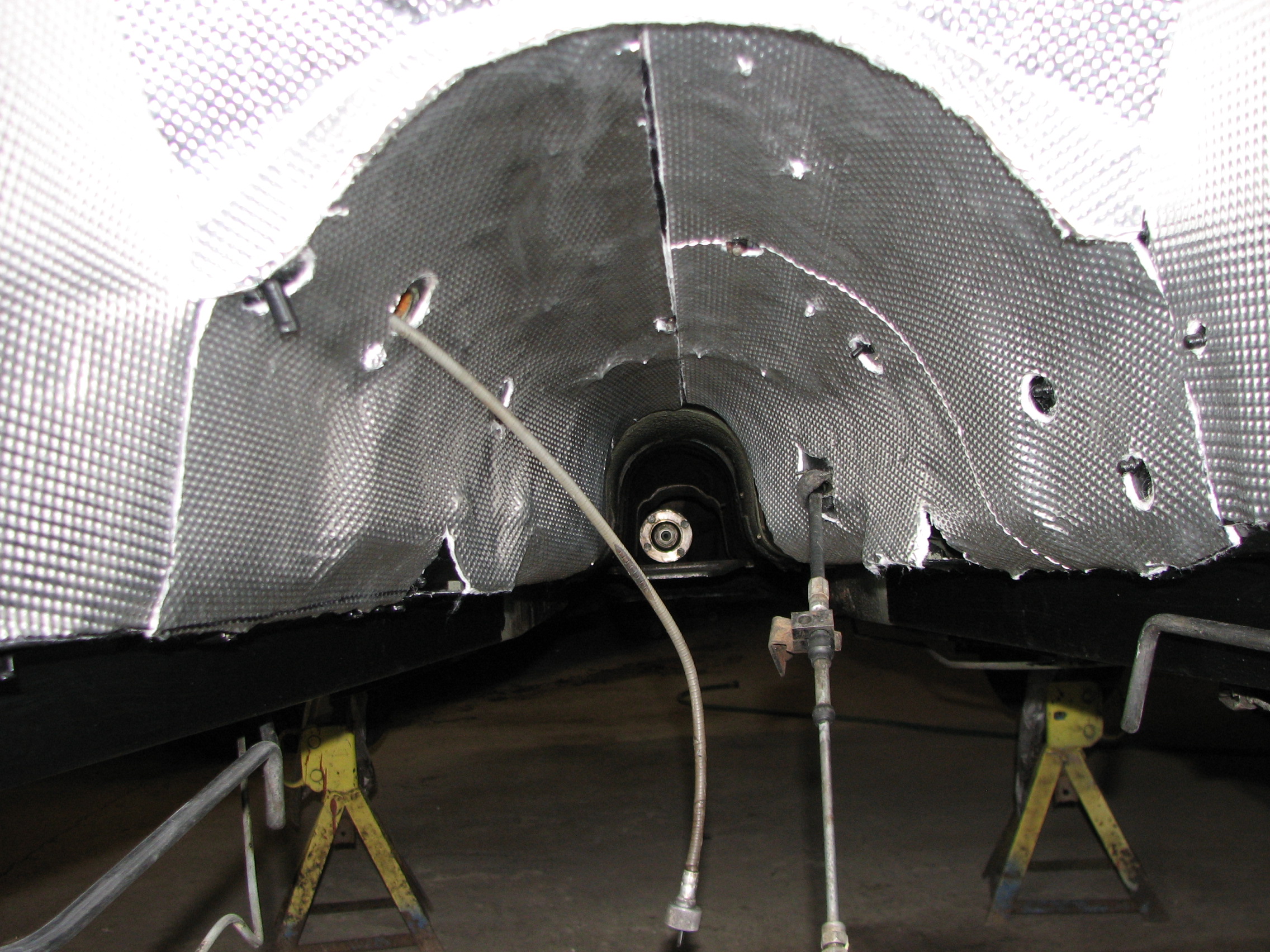

Paint stripper works nicely to remove the factory sound deadener. after the stripper is applied, cover the wet stripper with plastic wrap ( glad or saran), and leave it sit for longer than recommended on the stripper instructions. Keeping the air away from the stripper allows it to continue to softer the deadener.
Finished underhood is Lizzard Skin ceramic. The tunnel is a waffle high heat foil backed with fiberglass insulation. It came with a high heat adheasive backing.

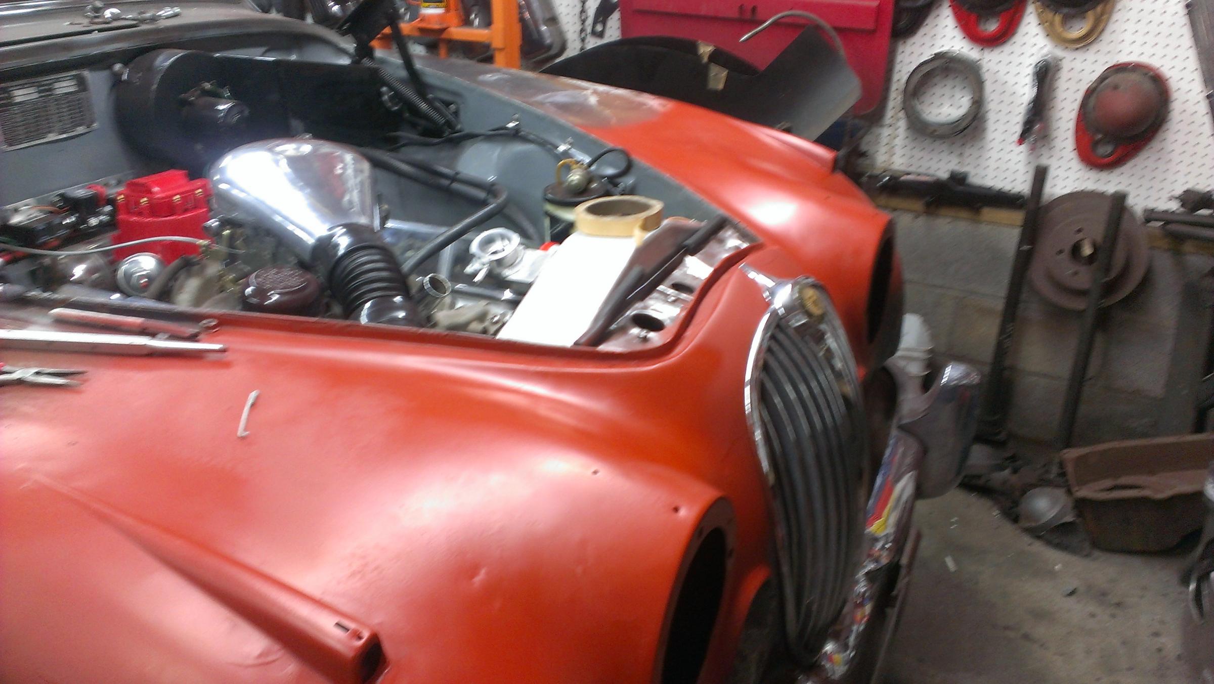

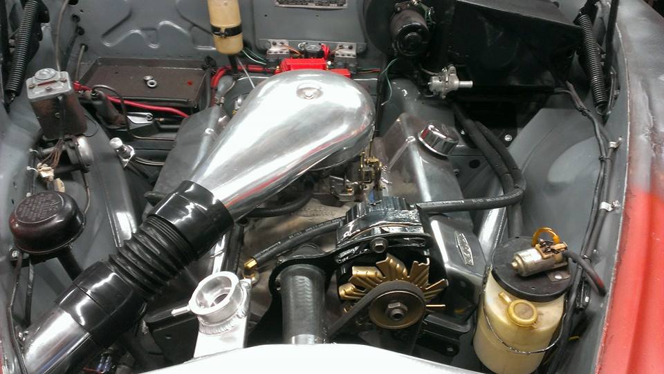

Transmission lines plumbed to radiator and cooler. Motor mounts finished and standard tight fit headers don't. I see Sanderson's in my future. Cold air intake fabricated($48). Shifter bracket and arm made for XJ6 shifter. Getting cold here now so I will have to pace these old bones!

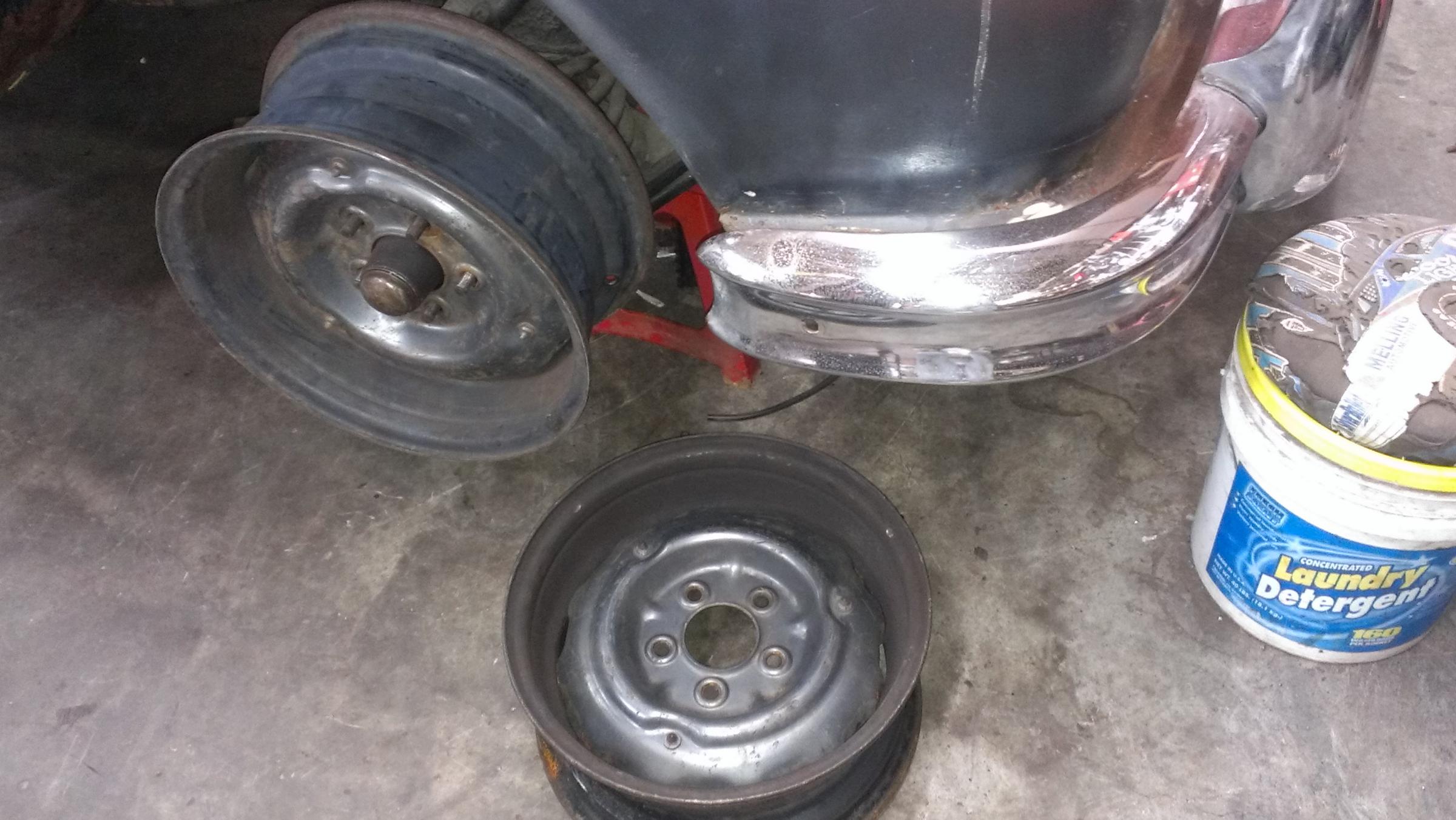

Engine all buttoned up and two of the road wheels almost ready, went with 6 1/2 wide.

finished alternator bracket and adjuster, had to get creative but it is done. Engine bay filling up fast now!
