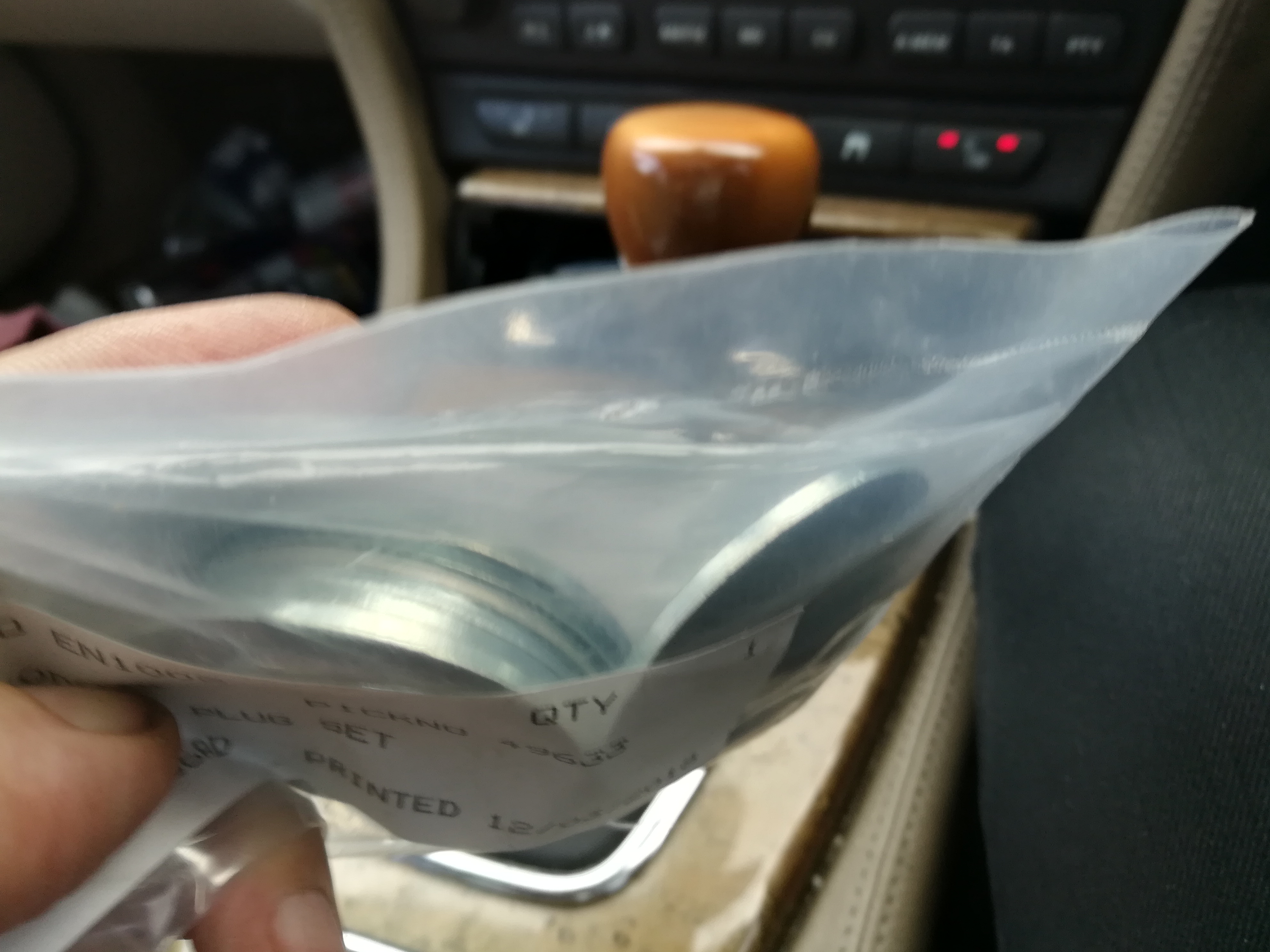

Here's a picture of the core plug set SNG sent me, are they meant to be like this? The core plugs I remember replacing in the past were like little cups, these ones look more like saucers...

That's completely correct Brent, these are known as Welch washers.

The core plugs or Welsh Plugs in your pic certainly look the real deal. You may be more familiar with the "skirted" style of plug on other engines, but Jaguar XKs used ones in the form of a domed disc . . . giving rise to a number of observations . . .
  • sealing is confined to edge lip only so a close fit is essential, aided by use of suitable sealant;
  • fit with domed face out, then use hammer and solid drift only slightly smaller diameter to flatten dome, thus expanding plug diameter to seal;
  • IIRC, number of plugs supplied seems right . . . beware ending with one left over!
Last point needs clarification. All but one of these are somewhat easy to get to . . . with manifolds away, they can be replaced with engine in situ. Too easy! However, the final one is in rear face of engine block, below engine mount and with no chance of replacing if engine is in situ . . . although few consider cutting a 6" access hole through middle of dashboard and firewall . . . sooo hard to patch it afterwards!
Time for the dreaded Murphy to make an appearance . . . if you replace all the other plugs with bright shiny new ones, guess which will start leaking exactly 29 days after you have buttoned up your shiny new engine? Oh . . . and ask me how I know.

Just a quick clarification.
The recess the Welch washer sits in should be clean and free from defects, so be careful when cleaning the recess to avoid scratches or gouges.
The plug should not be flattened completely, it should be flattened more than 30% of it's dome height but not completely.
If they are flattened completely they can leak, and you have to start again.

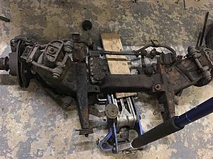

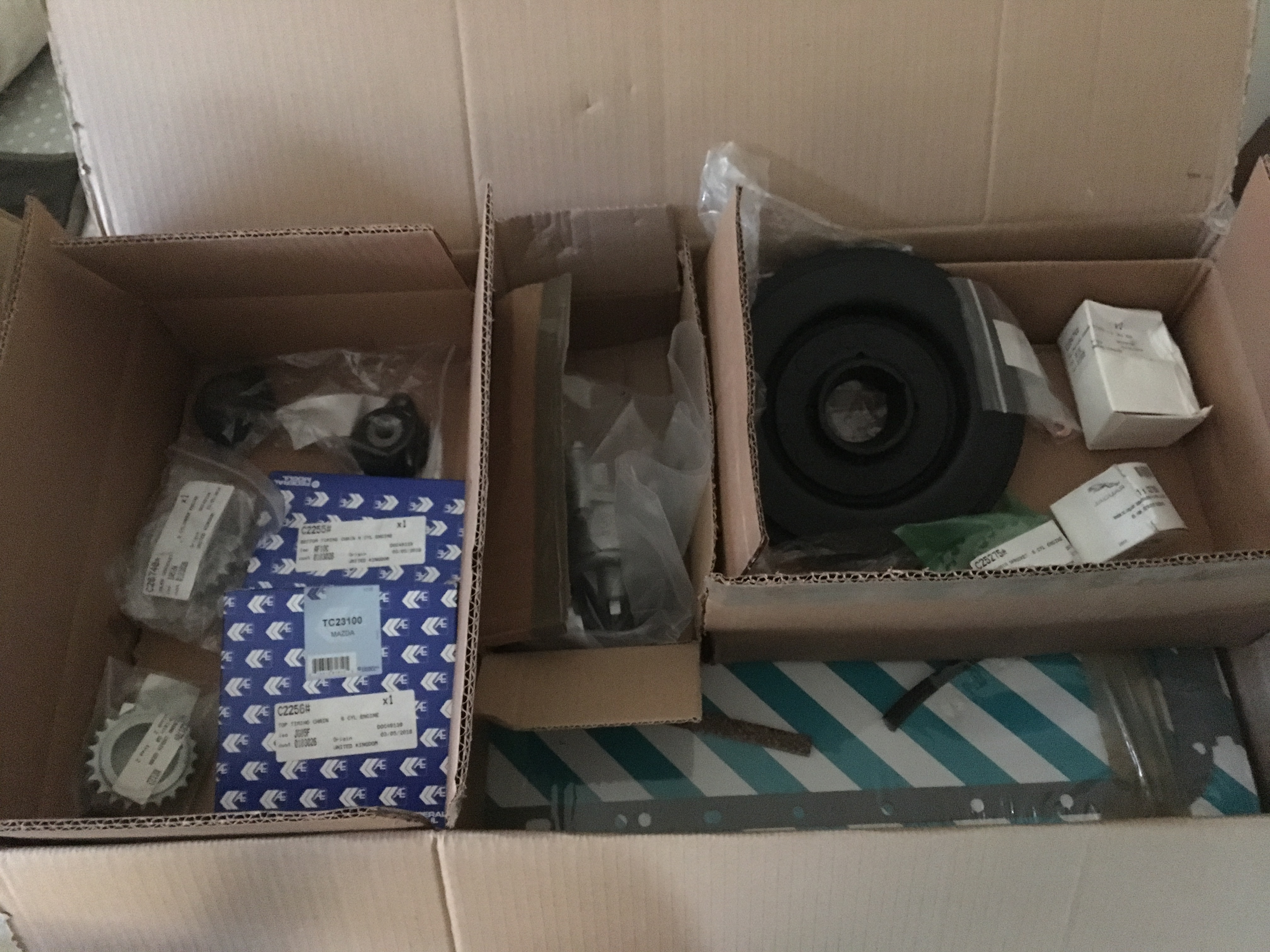

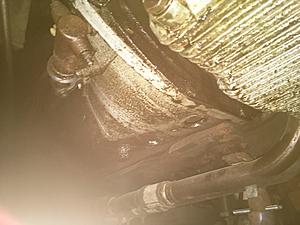

Thought I had better do an update, had a good look over the car, and a couple of issues came to light, timing sprockets are all worn and will be replaced, sump gasket, high capacity oil pump, timing chains all ordered, some were not in stock, so had to await back order.
Parts arrived last week but top sprockets still out of stock, but need to get the job going so into the workshop to drop the front suspension.
Found a couple of further issues, the drivers side Vee mount had let go and the front sandwich mount was also separated, so only the passenger side mounts, the anti roll bar and the steering column were holding the front suspension to the car !
Then found a nice increasing patch of oil on the floor, as the car is now up on an angle the rear crank seal is showing it's normal leaking !
So out with the engine next, will pop the crank out to replace or upgrade the oil seal and hopefully there are no surprises when I get the crank off.
Brent has a bunch of new parts that he had already got prior to the car coming to me, so the suspension will have a new set of bushes, new engine mounts as these were toast, core plugs, upgraded radiator, new hoses, crank seal, suspension mounts, and also the lower steering column bush as has been smashed by the bouncing front suspension, new timing gear, crank damper and a refurbished head.
Not sure if I have forgotten anything, and will update as work progresses.
Brent is coming up for the day to lend a hand and get oily on Friday, hopefully will get most of the work done by then so he can help putting stuff back together.
