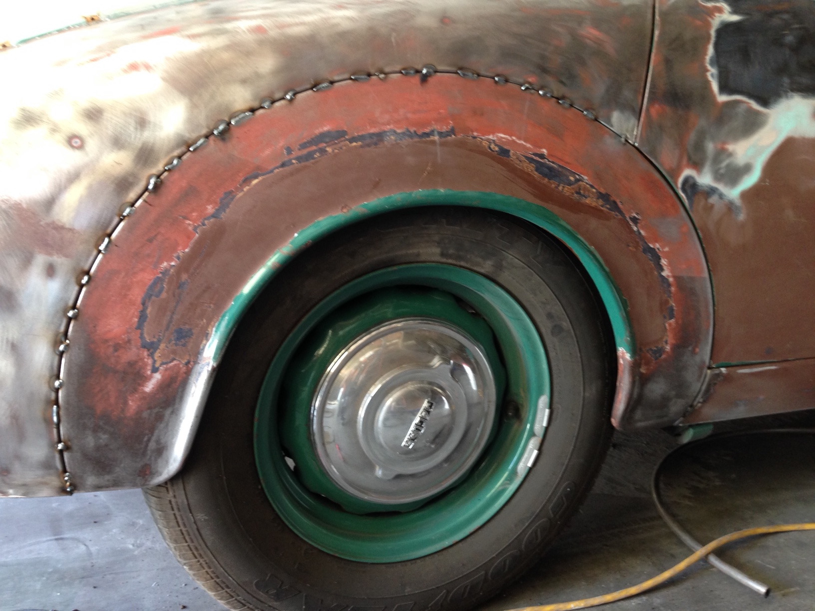

I decided to modify the rear wheel arches. Better balance with the front of the car I think.

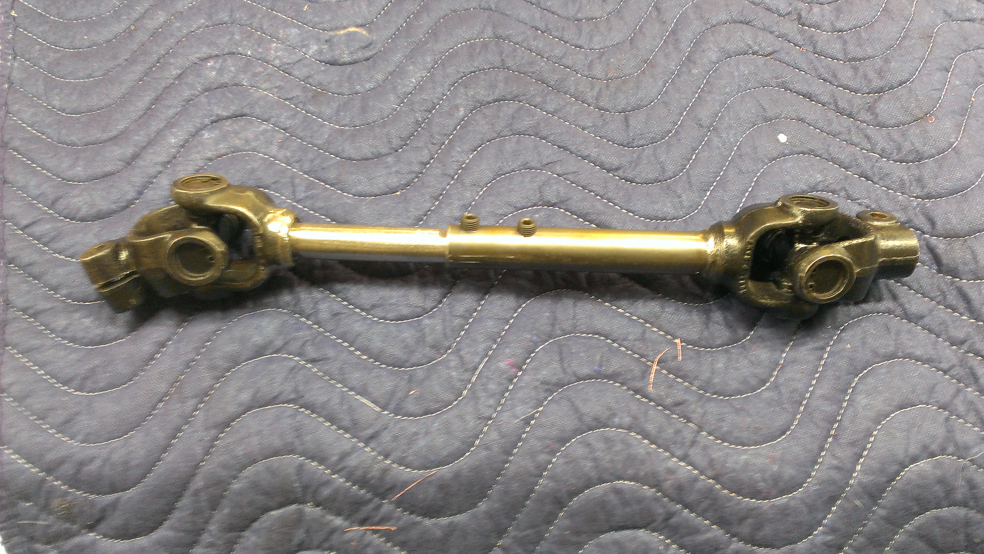

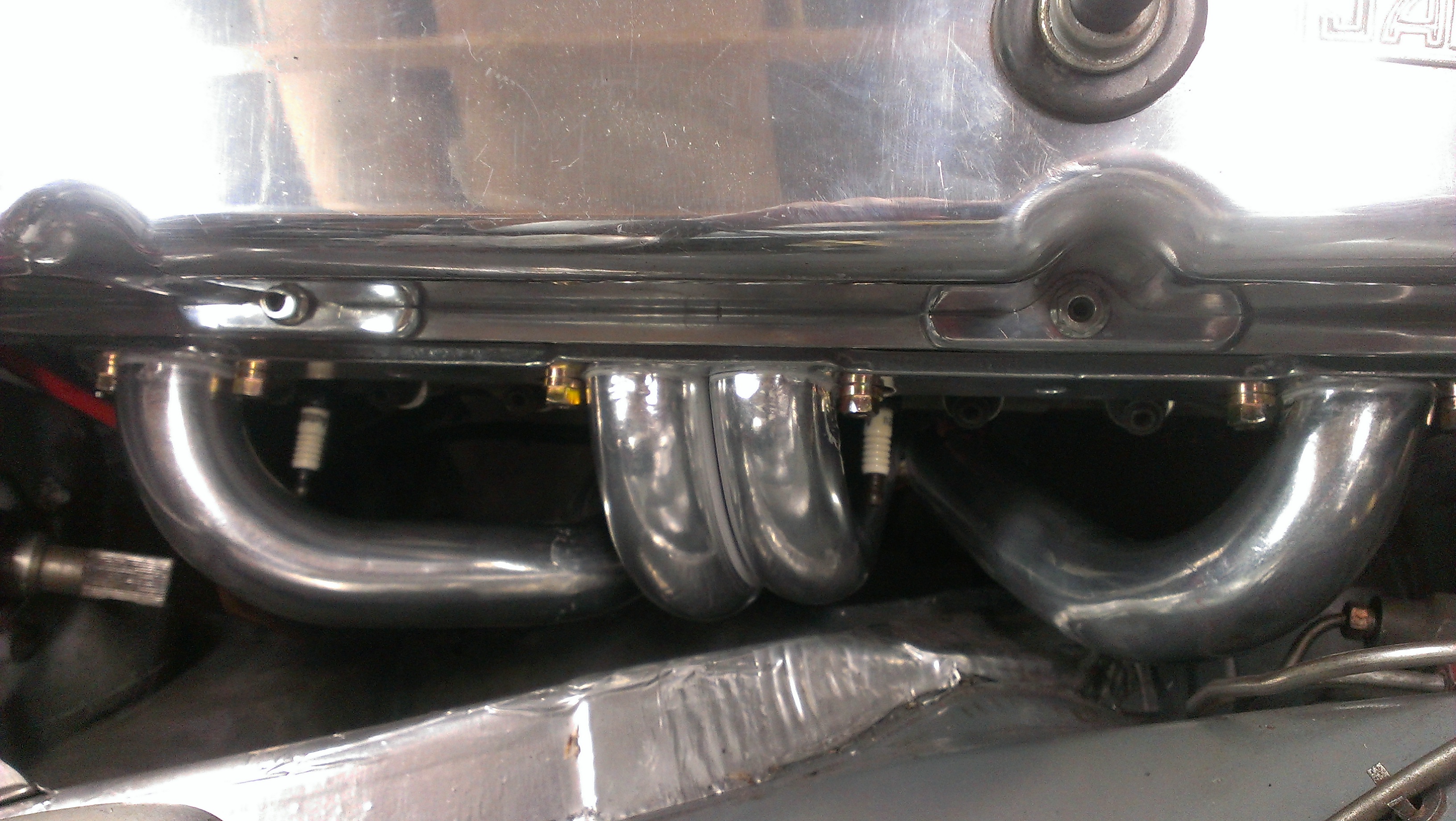

My gen I chevy (RHD) had to modify the steering shaft and built custom headers. sway bar dropped 2' and a shim at the steering box
Attached Thumbnails Help with Chevy V8 MK2-steering-1.jpg   Help with Chevy V8 MK2-headers-2.jpg   Help with Chevy V8 MK2-07-15-04.jpg

Thanks for the photos. On mine it looks like they just moved the steering column outboard by about an inch and a quarter. It seems to work OK. I haven't delved into it to see if I can make any improvement yet. I wondered if an exhaust manifold with a rear exit might make for a bit more clearance?

I have seen a few different way of doing this, but I decided to weld the wheel spats onto the car, then cut 80% back off again. I welded on a 5/8 diameter rolled tube to make the lip. I think the cars look better balanced like this. Not everyone will agree.
Attached Thumbnails Help with Chevy V8 MK2-arch-1.jpg   Help with Chevy V8 MK2-arch2.jpg

I would not worry about that as no matter what you will use will need to modify the steering linkage, etc. to fit any V8; you are not going to find one where you leave the steering linkage in the stock location, etc..
I am running a GM 5.3 liter LS1 and used Headman shorty headers after experimenting with two others to find one that will fit, meaning clear the frame. There is no header where you do not need to move the original location of the steering linkage. Every street rod, and most restomod cars always need to move the steering linkage, etc. to work around the headers.

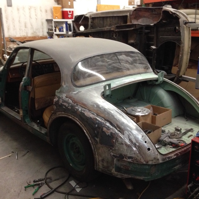

To strip the paint from the doors, I took each door off the car so I could work with it on the floor. An old piece of carpet helps here. My car had several layers of paint, the horrible two tone green being the most recent. Most of this came off of the flatter surfaces with a razor blade (the whole car actually). I then used paint stripper to get the rest of it loose and scraped that off. Around the edges (jambs) I just kept laying on more paint stripper then scrubbing it with a hand held wire brush. This gets it pretty clean. It also worked really well behind drip edges and other detail spots. I used a small (4 inch) electric orbital sander with 40 grit to get it the way it is in the photo. The nice thing about this method is that it is not too messy or noisy. I have used an 8 inch grinder with 40 grit on a foam pad that I bought at an automotive paint store. It is also really good at getting rid of layers of paint and bondo, but it is noisier and messy. The dust from that goes everywhere.
Looks good, planning on something similar myself, actually not similar, that exact thing!! Any tips?

I used a cheap tubing roller from Harbor Freight. The smallest dies are for 1 inch tubing, but you can use them to roll the smaller 5/8" diameter. Roll both sides so you can get them the same, then use them as a template to cut the arch.
Great, Thanks Trev. Did you just weld the tube to the outside? How did you finish it then, just fill with bodyfiller? Or did you somehow roll the edge of the spat around it? Looks really nice....
