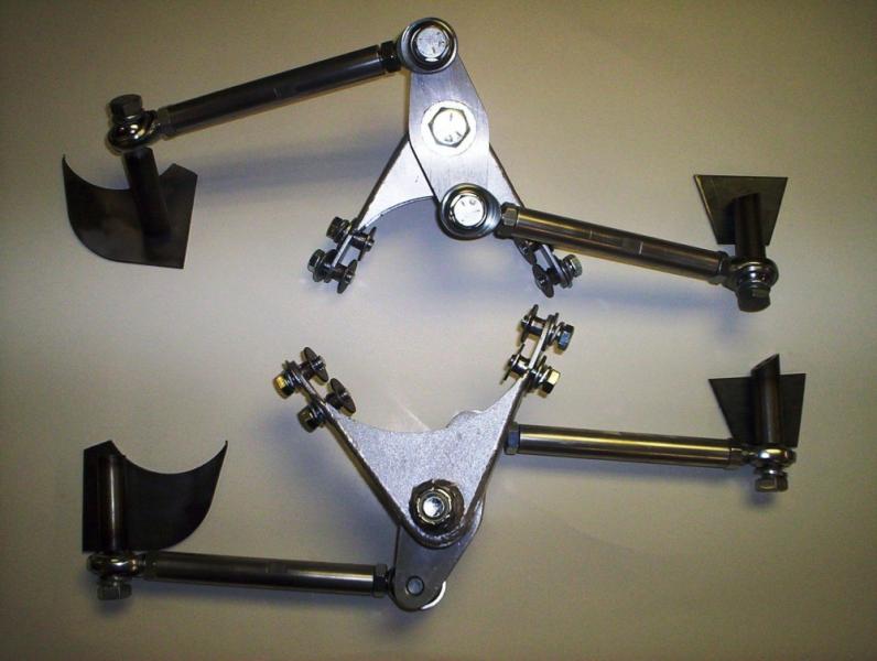

Fraser is mostly correct,
A V8 will easily fit but I did have to cut a small section of the passenger side and weld new metal which was not too difficult and did not impair leg room at all. You will also likely need to weld new motor mounts to hold the engine in place.
You should look at my older posting here on this forum for beefing up the rear suspension. The stock suspension is a great design but at a minimum I would get the "Watts Linkage" from Nick Acton
Acton Custom Enterprises, LLC as it fixes the key weak point of the hub not having support for bigger torque and horsepower. He is making my set right now so you might give him a call as it might be cheaper when he does a number of them at the same time? Many AC Cobra owners use our same independant rear end and add the Watts linkage and it holds up great to serious HP. It is a good retrofit for stock or V8 Jags as that is a major weak point.
33 Wildwood Drive
Holderness, NH 03245
(603) 279-0241 Home
(603) 254-4105 Cell
www.actoncustom.com
Also the hard part of any engine conversion with moden engines is the computer controls so good luck on that one. You might search to find a tuner whom can program your system for you or might have a computer harness/controller to incorporate to allow you to tune it. That is one reason among many others for me to us the light weight GM LS V8's as there are so many aftermarket computer/contollers and tuners and builders that will set up the engine management to what transmission, rear end gearing, wheels/tires, guages, type of performance, fuel efficiency, etc. Beacham sells MKII's with basically a similar Jaguar V8 but I am sure they will not share their computer set up with anyone as those cars sell between 90-100K turnkey.
