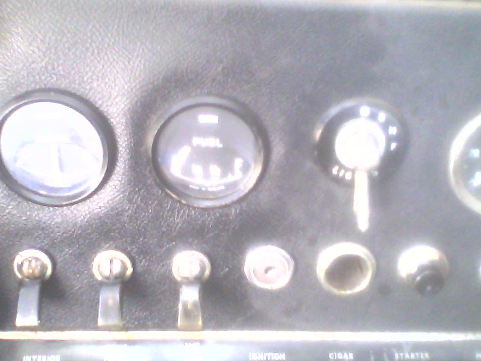

The electrical connections inside the instrument panel are finally getting a cleaning after 50 years, and the outer facia of the panel is being cleaned and moisturized.
The panel is pulled down, but the hinge is still rusty rough. I put a bit of penetrating spray on along the hinge, and it it helps a little. But still a rough pull.
I've started to clean each component terminals with a brass wire brush. After the metal shines a bit, I spray clean with electrical cleaner
( One needs to give ID to buy this type of spray locally, as idiots use the cold spray for narcotic highs...)
The panel exterior is being cleaned dial by dial with Marguerite's.
A bit of the difference can be seen in the picture.
And the best practices are?
What should I be careful to avoid doing?
TIA
