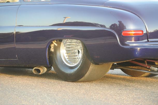

a 255 tyre is more than adequate, just something like this for the inner guards, as said, im just speculating for now
Attached Thumbnails Interesting article on an updated MKII-518206_110_full.jpg

For me I like the concept of a restomod but where the car is just upgraded and still is a good handling and all purpose car not just a quarter mile ride. I think you will be happy with a 245 or if you dare squeeze a 255 and that way the car will be great for handling and you keep the stock body exterior wise. Tubing the car to me would not make a difference with the IRS inboard brakes as that would not gain much if any tire width. There is a cool wide body MKII on Youtube and those wide flares are needed to get into the really big 285+ tire ranges. Remember these cars had decent handling with a dinky 175 tire so going to a 245 will be plenty for good handling and looks as well.
