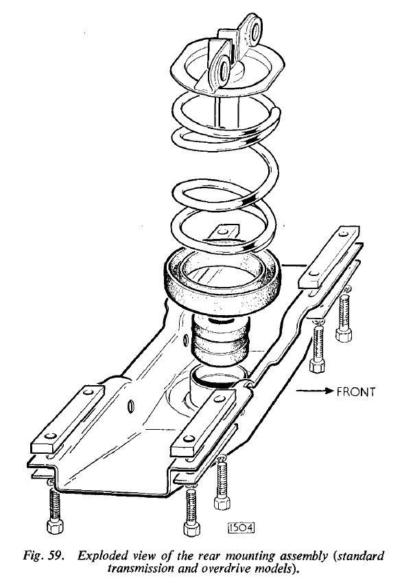

Front engine mounting.
Rear engine mount.
Older models:
Newer models:
Kit.

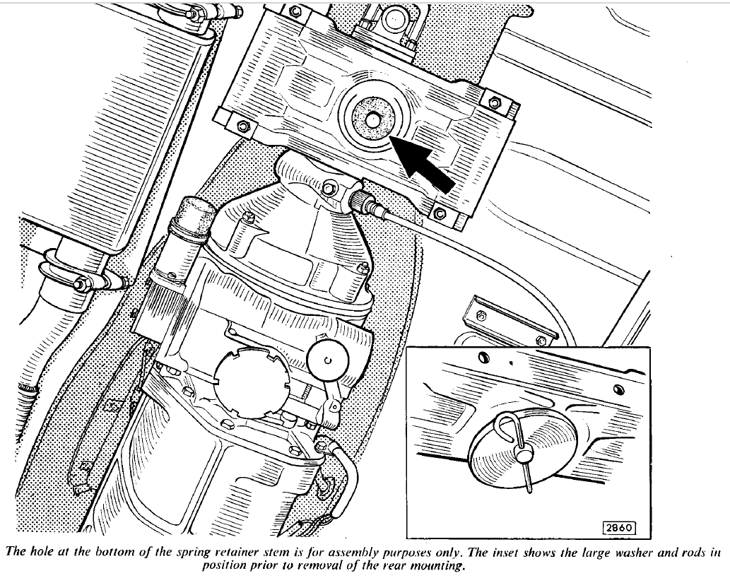

With springs available today I have found it trial & error to ensure no fouling of the tunnel. I have an Auto spring on a Manual/OD transmission. All works well. Counting coils is a disaster. Gear lever nicely centered in the console. No fouling anywhere. And don't leave the split pin in the shaft hole of the rear mount. It is for assembly ONLY.

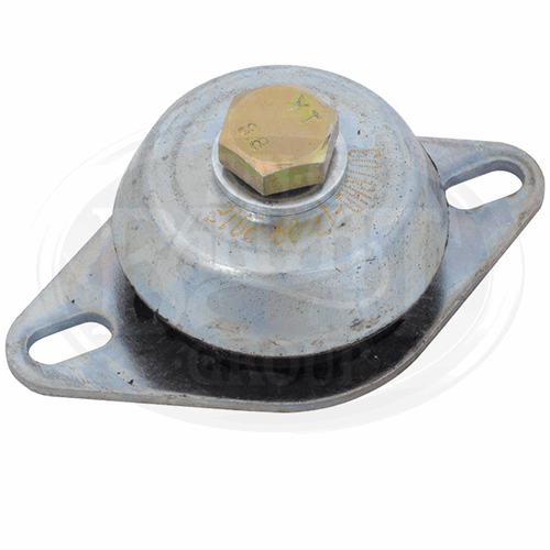

Front engine mounts have become one of the items where there's a lot of doubtful quality about. Rob Beere sells uprated mounts for road use that cost a bit more but don't fall apart.

Barratts also sells a decent up-rated mount: Refresh page for updates above. We make good mountings right here in Cape Town.
See Options for C18556

Please note that the split pin and washer are for assembly purposes only & should be removed once everything is in place. DO NOT LEAVE THEM THERE ~ REMOVE THEM OR THE REAR MOUNT DOES NOT OPERATE CORRECTLY.
