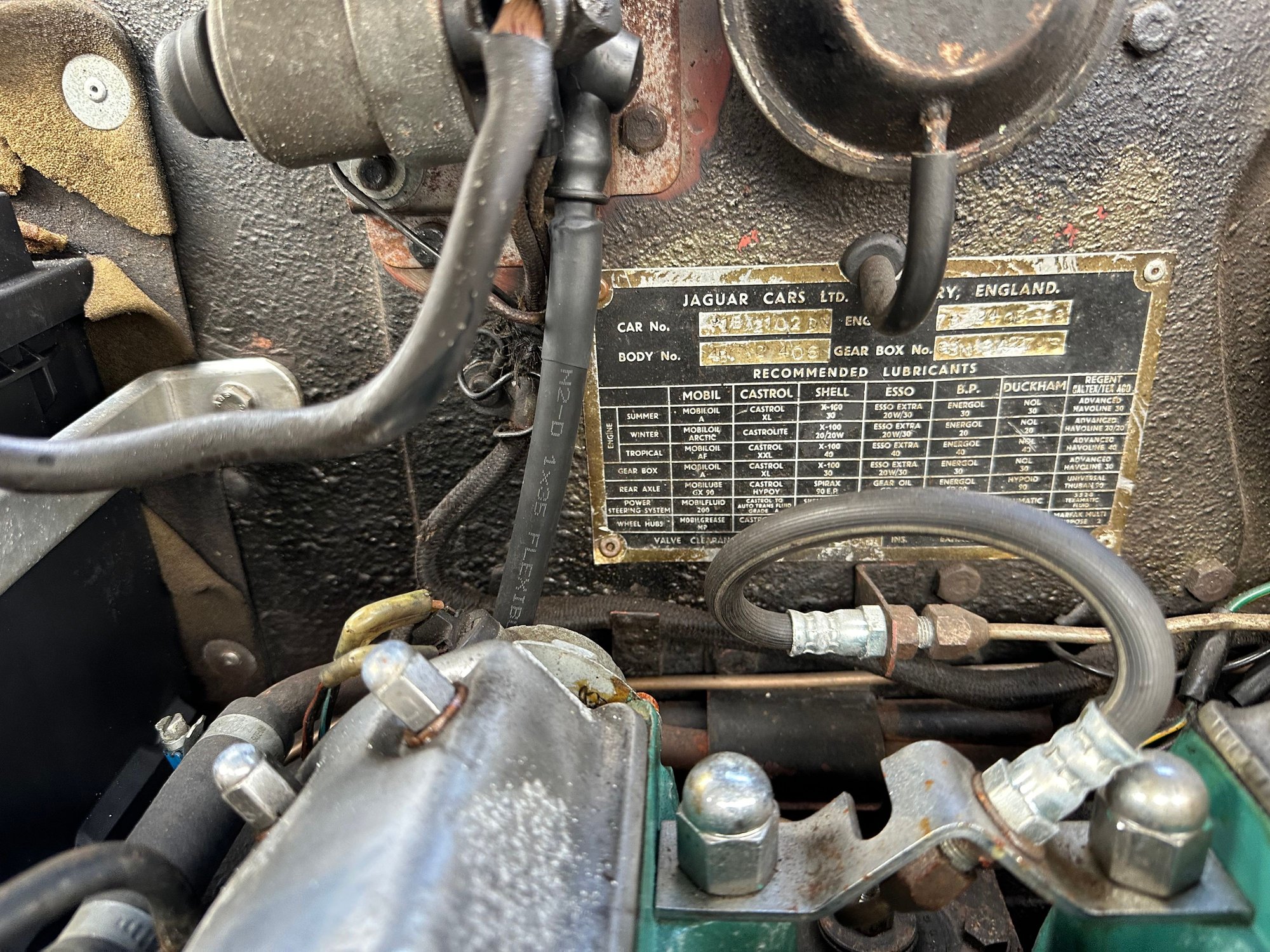

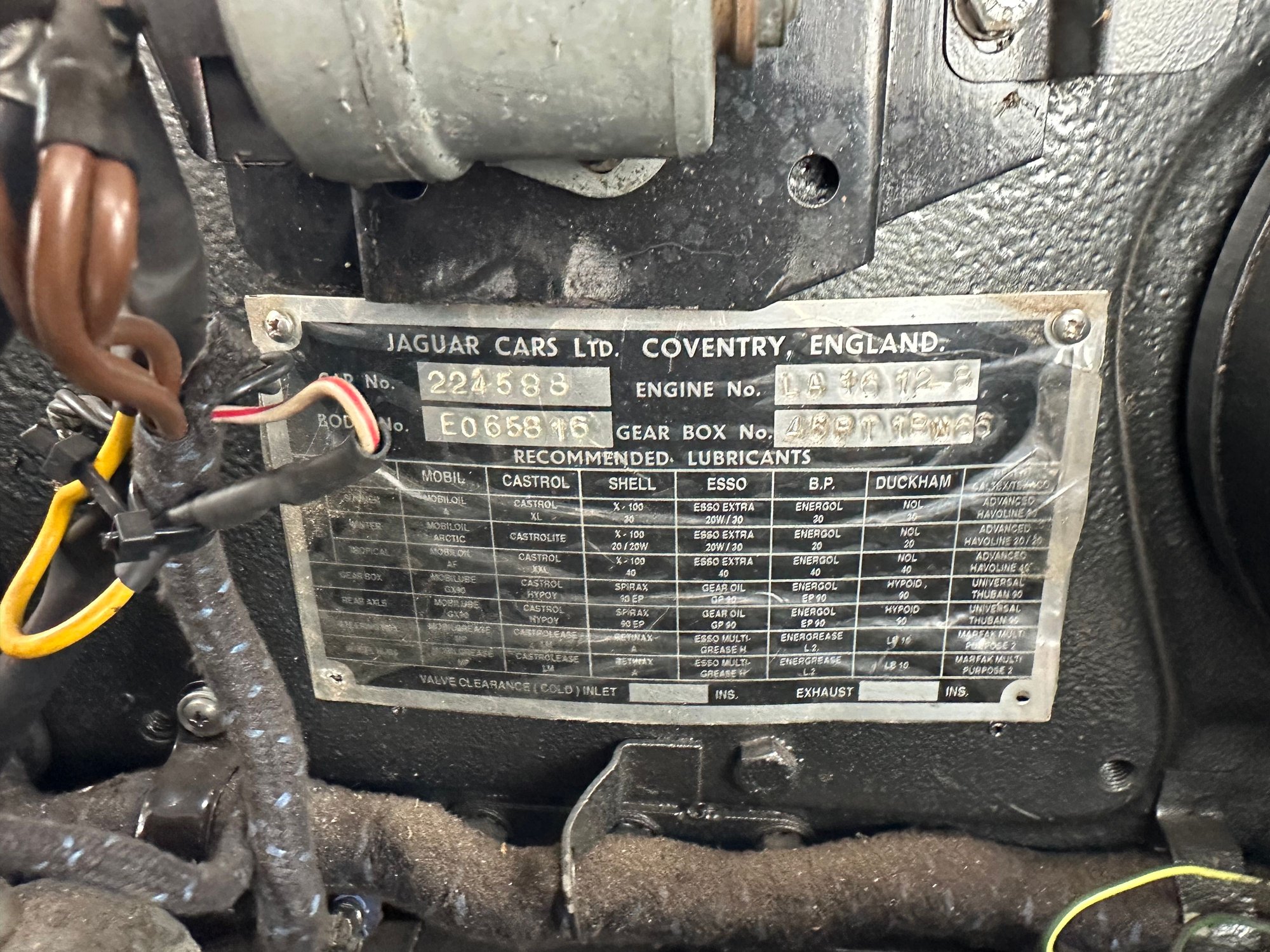

These plates can be found in the engine bay on the firewall or on the inside of the right wing. Maybe there are other locations too.

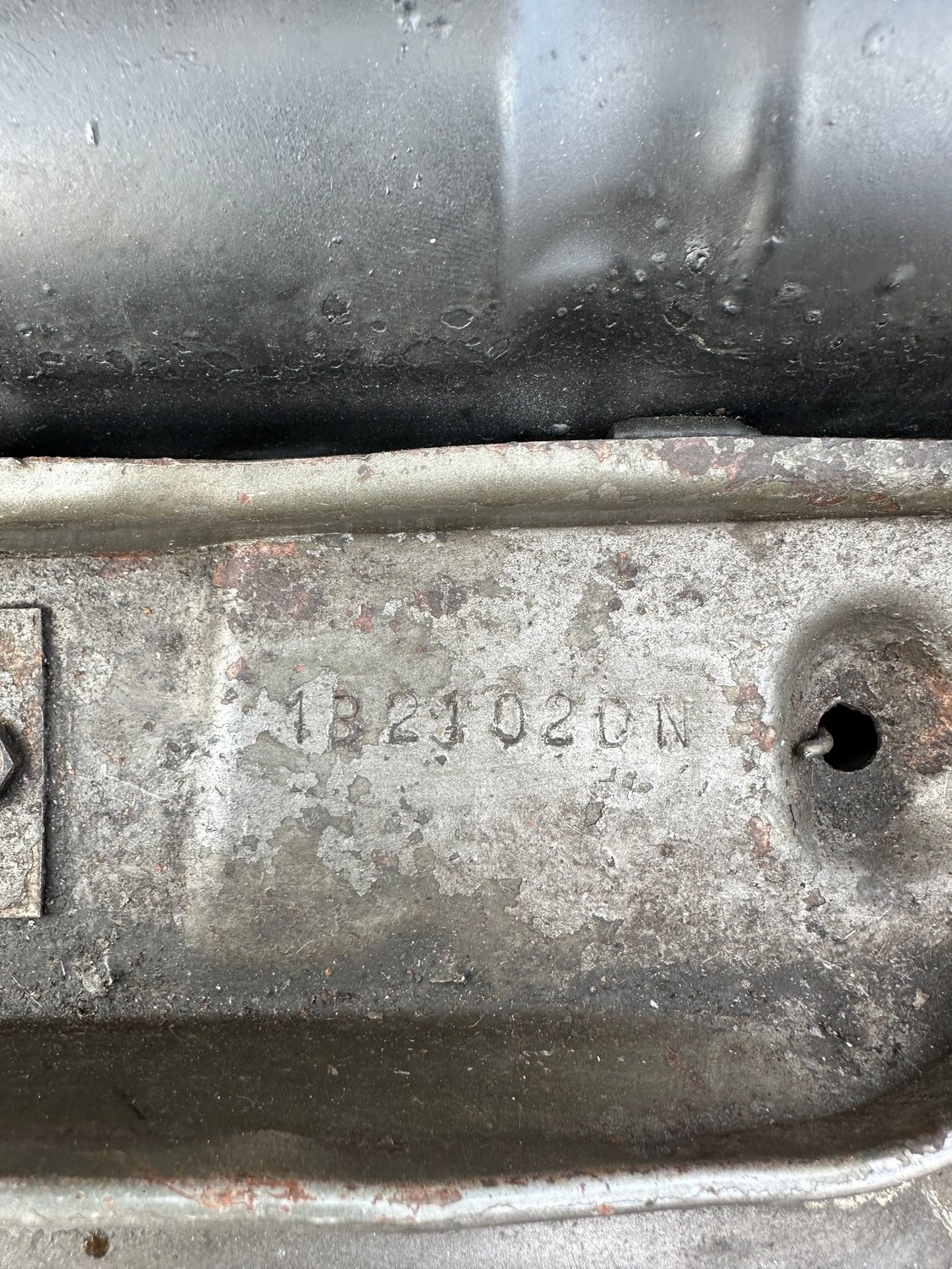

This is a “bad” number but it indicates the position of the number just in front on the radiator by the bonnet catch. Should match the number on the plate.

Further to Rishi's description, the plate on my car is on the inner wing a little forward of the heater box. It's upside down so that it's legible for someone leaning over the side of the car into the engine compartment.
