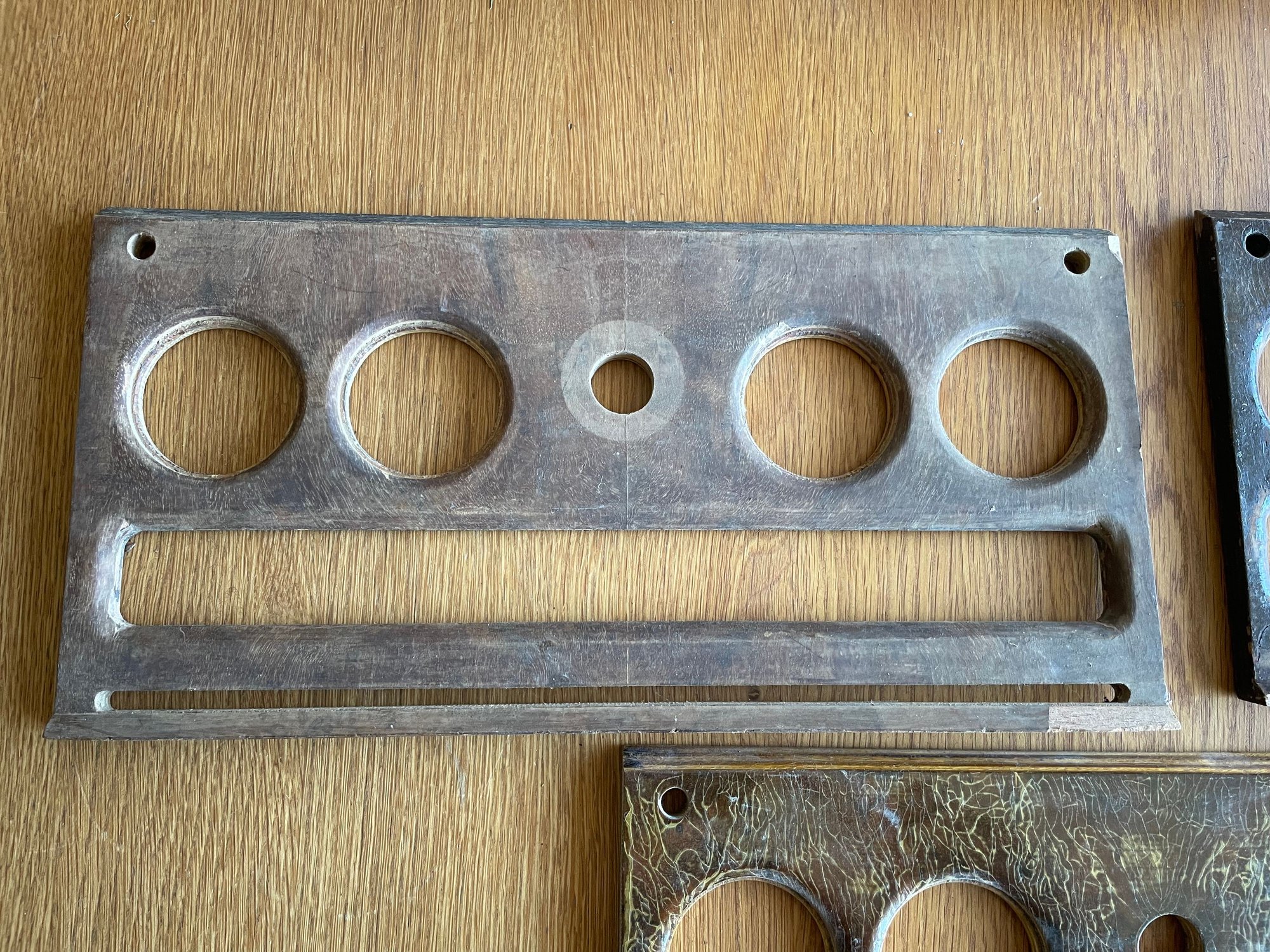

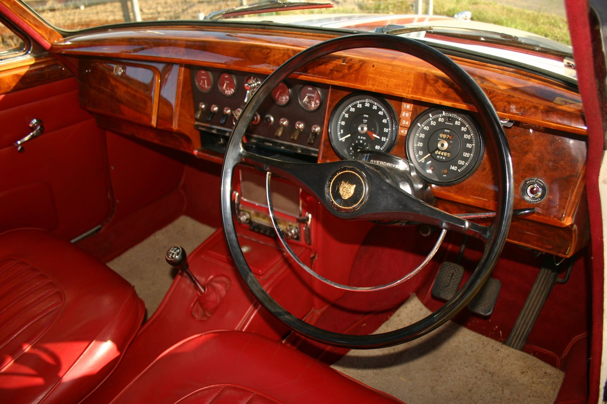

I have four facias all of differing conditions. The best is the one at the bottom of photo one and in photo two. There is no delamination of the veneer but it would need a light rubbing down and re lacquer as the lacquer is al cracked.

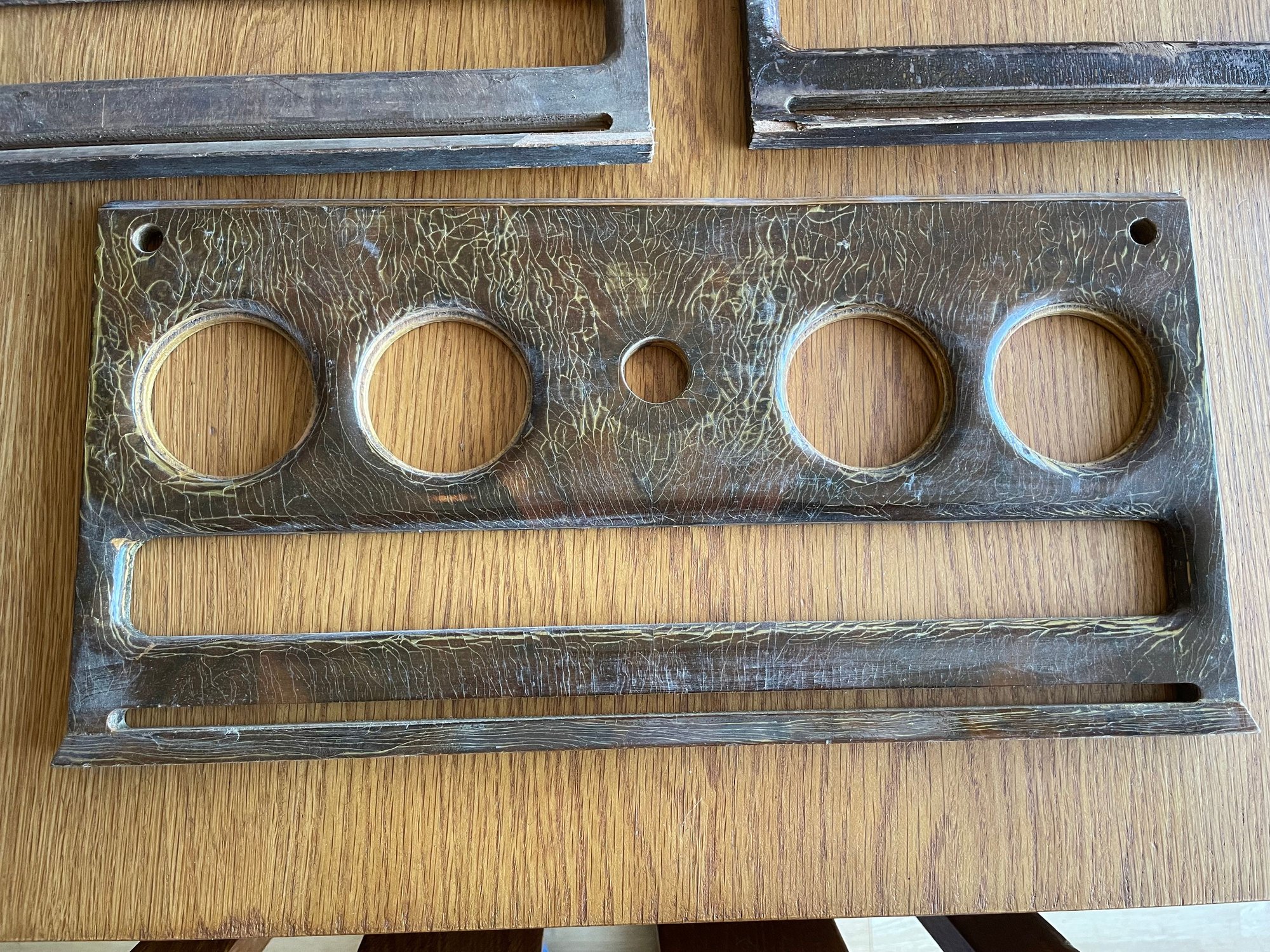

The one top left in photo one and in photo three looks like it has been sanded down but there is a small piece of veneer missing in the bottom right corner. This damage is almost covered by the legend for the switches when in place as you can see from the last photo.

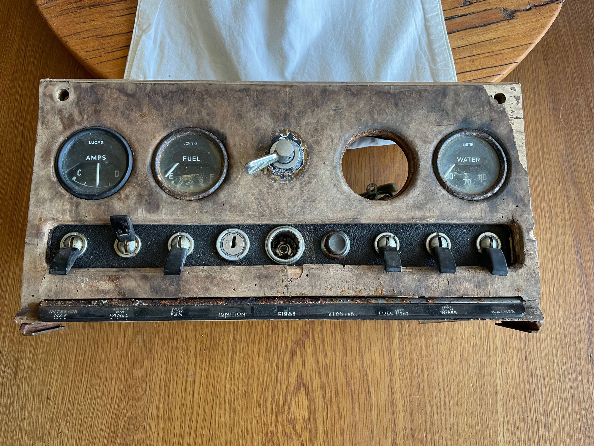

The one top right in photo one and in photo four has quite a bit of damage and would need a full refurb.
Lastly there is the one with the gauges which is in a similar condition to the one top right and photo four with several bits of veneer missing.
If you want any of them send me a PM with your details and for a small remuneration I can get the right one in the post to you.

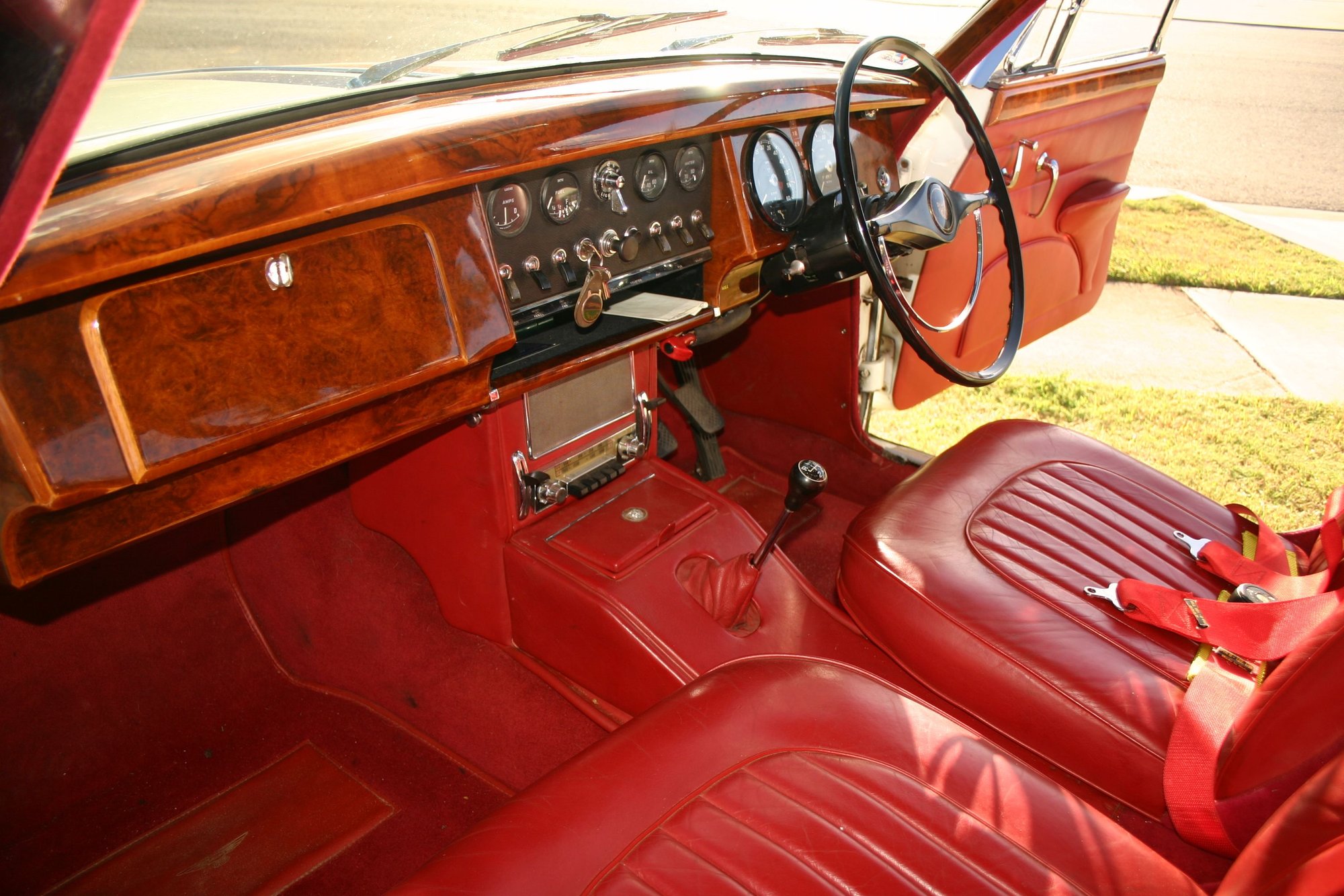

I thought it would be a good idea to post a picture of what the MK2 dash panel woodwork looks like.
As you can see the central switching panel is metal and does not incorporate any woodwork. I think some were painted and later ones had a vinyl finish
I think the upper cant rail is less "fussy' than the S type, but I don't have a handy S type to make a comparison.
The glove box is much deeper than the S type.
MK2 Woodwork
