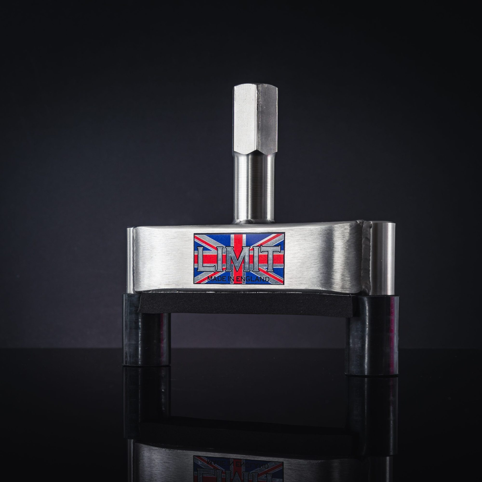

Does anyone have any experience with this product from Limit Fabrications in the UK? I've gone through a couple of the plywood spinner savers but they're difficult to use with my wide center laced wires. Also curious if there are any other recommendations out there, especially anything available in the US. Thanks.

Thanks everyone for the suggestions. Shipping cost was my main reason for seeking a U.S. supplier - the Limit tool (which looks heavy) is $106 USD plus $53 shipping. I've emailed Lionel for availability and cost - should be a bit less given the aluminum construction. Both tools appear to be really nice design concepts. I hesitate with the lever tool as it seems to concentrate the load on a very small area so I'd be concerned about damage to the knock off. And yes, with my wheel offsets the wooden tools are hard against my tires and not centered on the spinner ears so they break up in pretty short order. If I don't hear from Lionel I'll probably copy the Limit design and weld something up (thanks for the suggestion).
