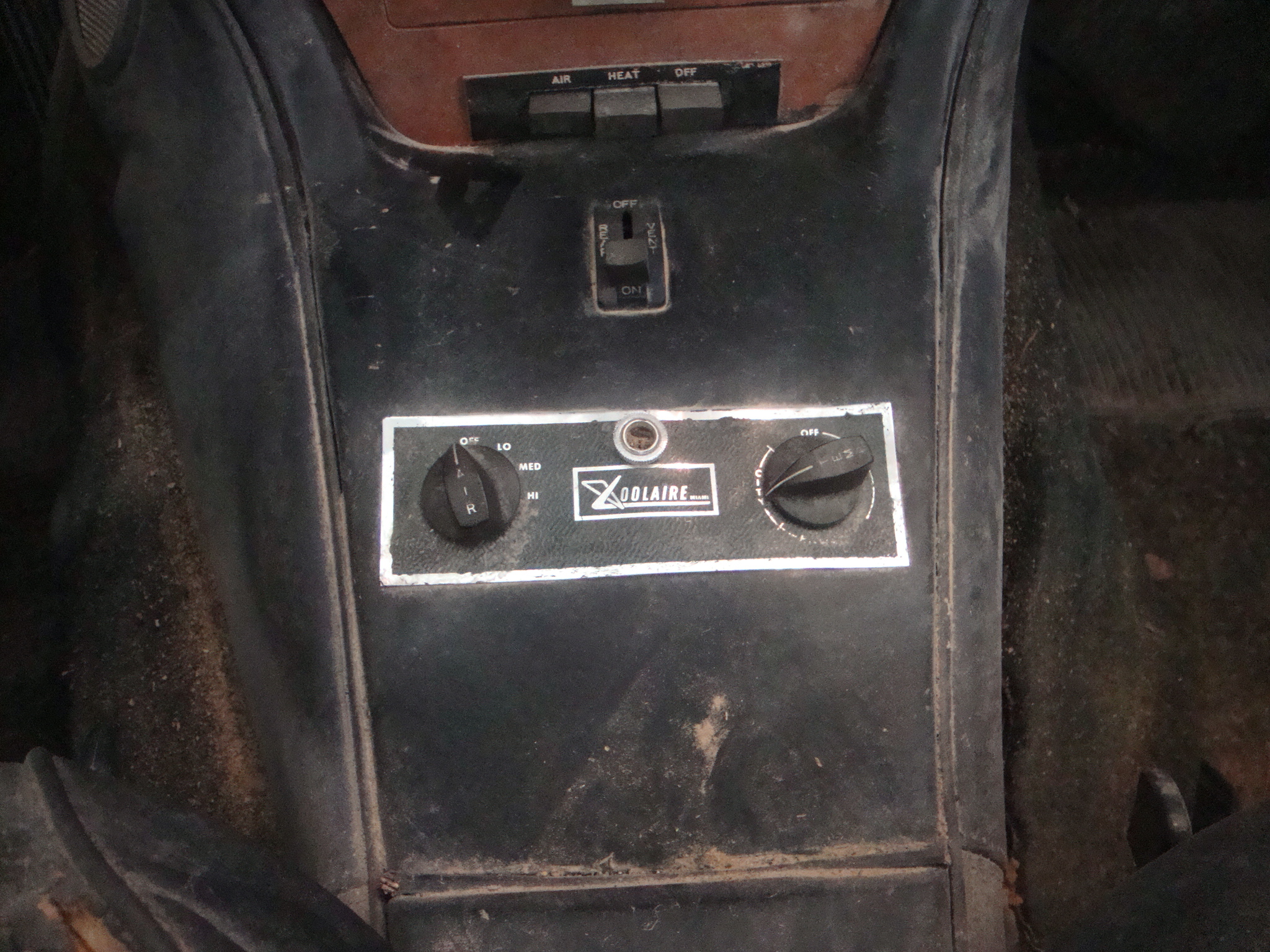

I just dropped out the two long AC hoses so as to order modern barrier hose replacment. The evaporator in the boot seems to be made up of TWO seperate evaporators with T's and hoses interconnecting. Also got a good pic of a pristine Coolaire serial number plate. If anyone cares...
But in the process I found the capillary tube temp control cut in half about midway so who knows what effect that had on the AC.
I'm about to order a laser etched duplicate of the foil Coolaire control plate stuck onto the center console. I'm 50-50 about putting it back in the same spot. With a nice plate it could work but the crap mylar decal does not!

Just placed an order to have the original AC control plaque redone in 1/8" alloy. The original is a thin foil piece glued to the leather console. Pretty cheesy when new but the 40 years have really hurt it. Can't wait to see the result. If the piece is as nice as I expect I'm thinking to put it back in the same spot. Opinions Please....
