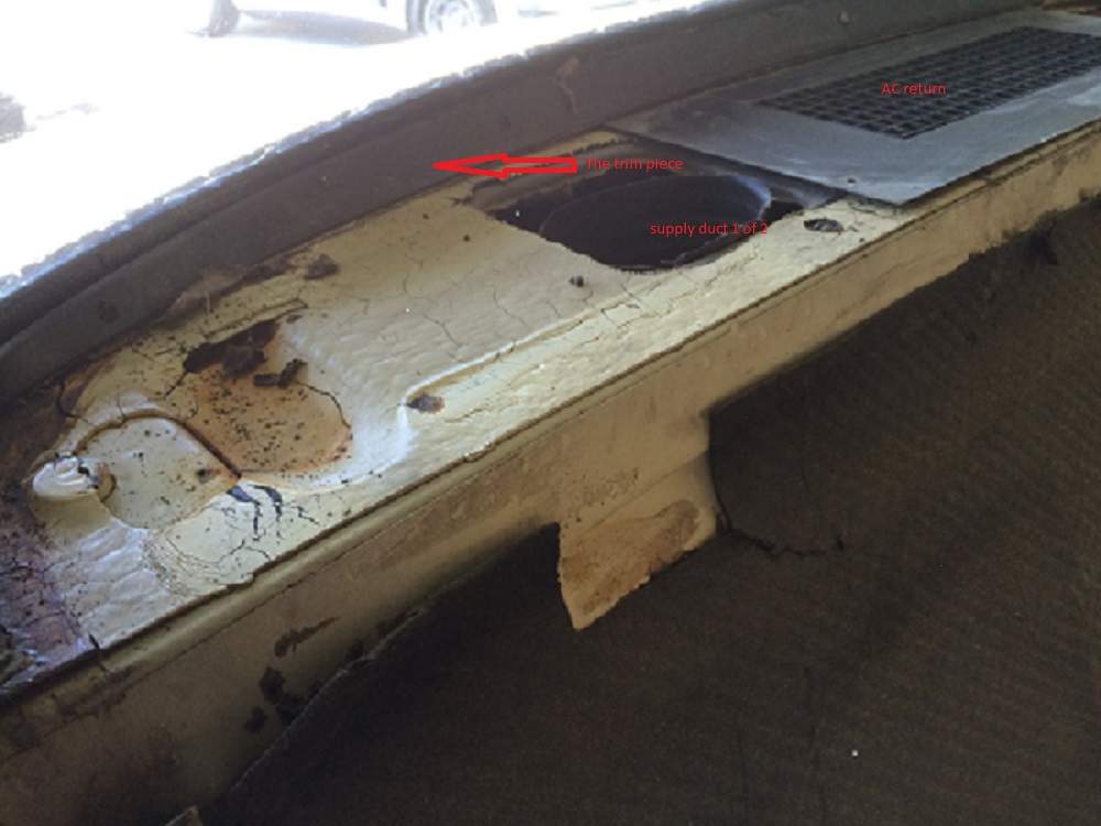

Can anyone describe how the trim piece below the rear window on the 3.8S is secured? The parts manual identifies the piece on plate 81 as part number 16.
It seems there were some kind of attachments to the rear deck covering but mine was discarded when they converted to the Kool-Aire AC.
I'm thinking I could bend up some steel tabs and use the door card clips before putting in the rear AC vents.

Hi, have a look at this thread as it might help S-Type Rear Seat Belts

Oh Yes, that is a very nice pic of it thru the rear window. I've gotten some pics and details that explain the union cloth covered trim piece was simply pinched to the rear of the parcel shelt with press on U clips.
When my parcel shelf was scrapped for the AC vent installs that piece seems to be simply left adrift. I will fabricate some bent tabs and attach them before recovering. Then when attached to the rear deck area the AC stuff will cover them. Or at least that's the current plan, some modification may be required

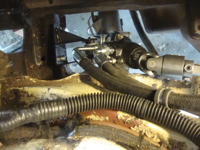

Haven't seen you here in a while so I don't know if you are watching the Forum or not. I am close to being ready to plumb the M&C Wilkinson steering rack. I have all of the fittings for the upper end. Just need the two ninety degree -6 fittings for the hose mountings to the rack. You could save me a little time researching if you recall the part numbers for these two fittings. Do you happen to know? One is a longer reach to go around the other.
Thanks so much!
