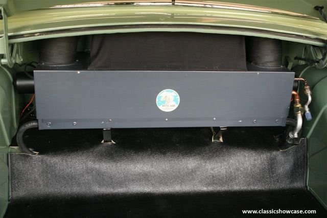

I am looking for a trunk mount MK2 A/C. Prefer an Arctic Kar unit but any will suffice. I am located in the U.S.. Picture follows. Thanks.

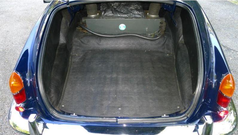

I have purchased an "Arctic Kar" evaporator. My rotary compressor is mounted to the engine. I will fit and remove the unit before the car goes to paint.
I have seen identical units installed in a MK2 and the evaporator is on a "bracket stand" elevating the unit above the trunk ledge. Does anyone have these "brackets"

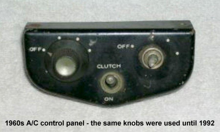

Here's a picture of an original controls panel for a Jaguar a/c:

Artic Kar Controls, vents, compressor, evapourator etc. as fitted by many US Dealers.
