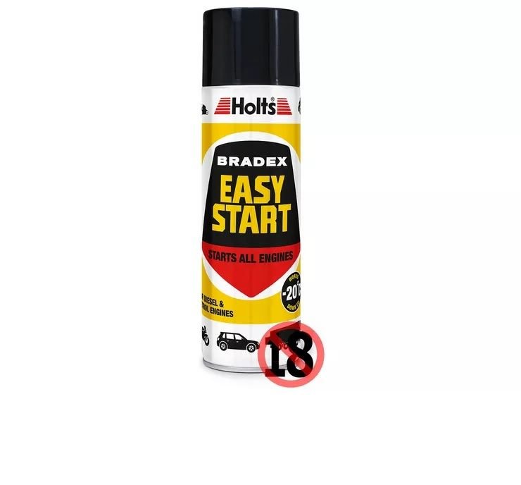

If you have all four then you should have a running engine. How it runs is a different matter. Easy start might be your friend in diagnosing the initial problem.

I’ve just ordered some easy start so thanks for that. Is carb cleaner worth a go too or should this suffice please? Can I just squirt it into the one that’s not moving up and down?

Thanks for the reply guys. There’s some good news, the 250 purred to life yesterday after an hour cleaning points, checking connections and with some easy start! I was over the moon!
