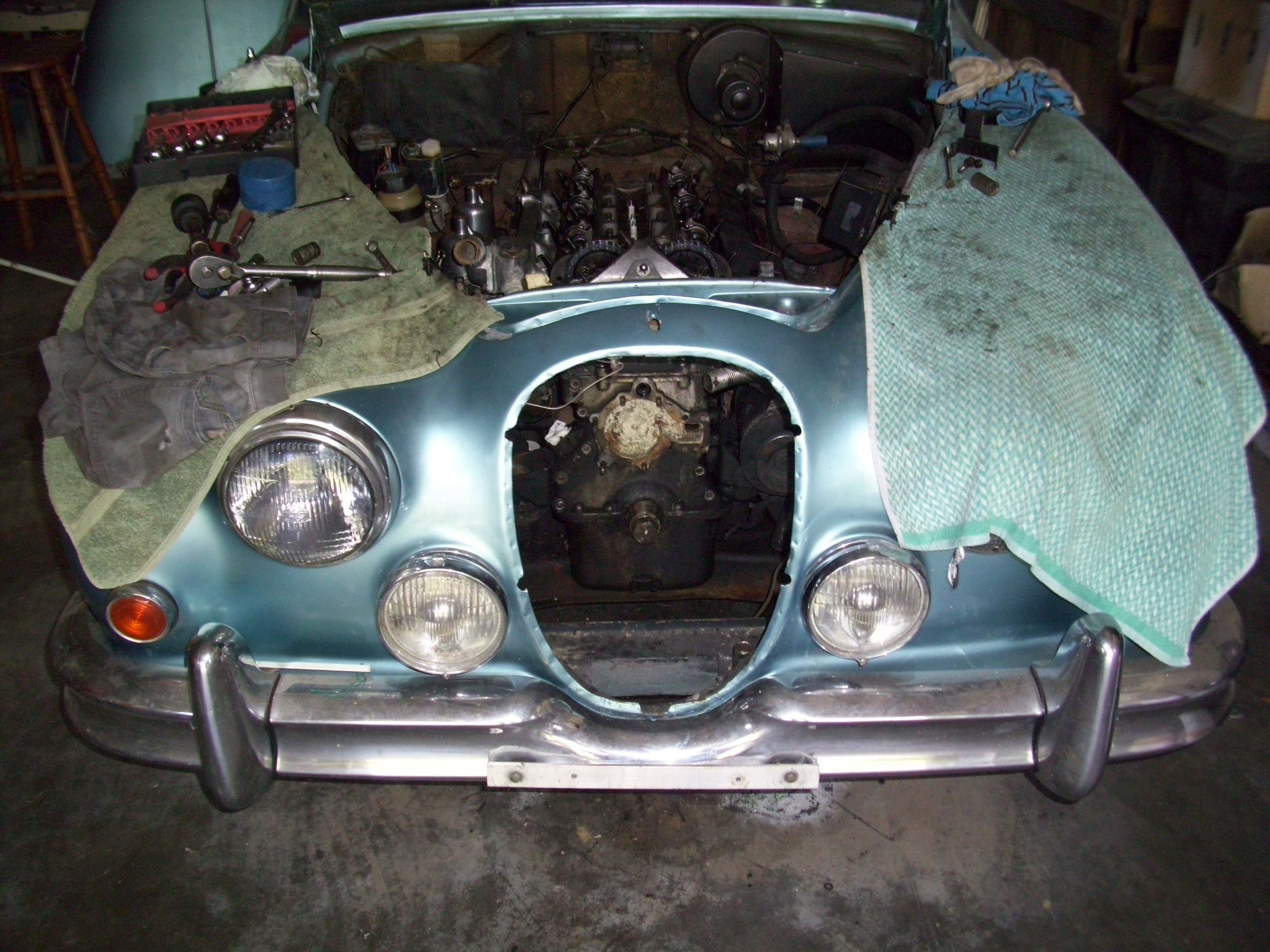

Attached is the current state of the MK2 2.4 in bits.
The fan belt that was on it was too short and at the limits of adjustment (or beyond!)
I simply need the size/length as V belts are readily available locally.
And another thing is the sheer transport cost of getting stuff from the USA and GB. Bloody unbelievable!!
I guess I will have to get the engine back together and measure it myself.
Pulling it apart to replace primary(lower) timing chain

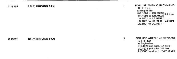

Depending on the engine number there are two fan belts for the 2.4 engine as there are also two for the 3.8 / 3.4.
Below are the pages from the parts book showing the engine numbers relating to the part numbers.There are no dimensions in the parts book.
2.4 engine part numbers.
3.8 / 3.4 engine part numbers.

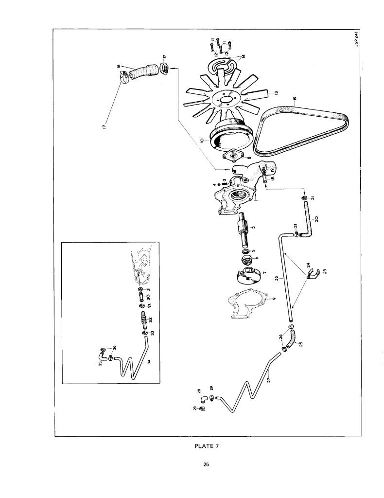

Schematic diagram of the fan belt which is the same diagram used for the 2.4 and 3.4 / 3.8

The engine number is BG 5519-8.
That part number C14723/2 would be the correct part.
The fan belt which was on it was a Gates 915 and I had to undo the adjustment bar completely and push the generator right in against the block and even then, it was a struggle to get the belt off
That 925 mm sounds closer to the mark.
