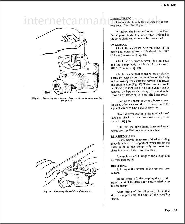

I simply restored my oil pump same as Cass (page B53 of WS Manual) ~ all clearances to spec & have oil pressure slightly on the high side ~ checked with multiple gauges. They can fib. Don't know spares situation. I Plastigauged all my bearing clearances. (probably excessive ~ old racing habit)
Did you have oil pressure between 35 & 45 psi hot at 3000rpm? I doubt your oil pump was the issue.
Your choice as it might affect the guarantee he gives you on his work.
Good news re pistons.

I was told that the tolerances on my old original Oil pump were still tighter than on the new replacement oil pump so the old was cleaned, refurbished and reused.
as I recall it was around 30 to 40 depending on rpm.
when the sump was removed I was impressed with how clean the interior of the engine was, no sludge or anything obviously wrong other than the milky stuff at the lowest part of sump. Sure, when the rod caps were removed then the journal and bearing damage was obvious.
when the oil pump assembly was removed there was no obvious problem either. It was clean and oily shiny everywhere, no clogs.
So there is a procedure to get it cleaned? I will study the manual. Thanks.

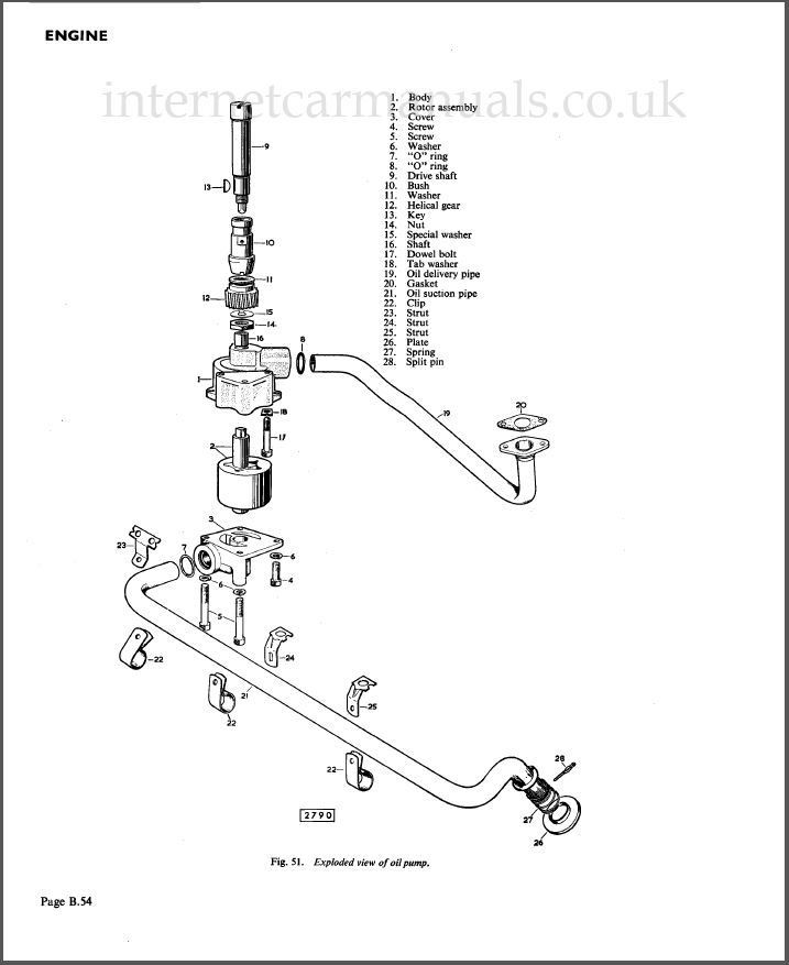

Old Jul 10, 2021 | 10:44 AM
Glyn M Ruck's Avatar
Posts: 5,546
Likes: 1,493
Default Oil Pump
