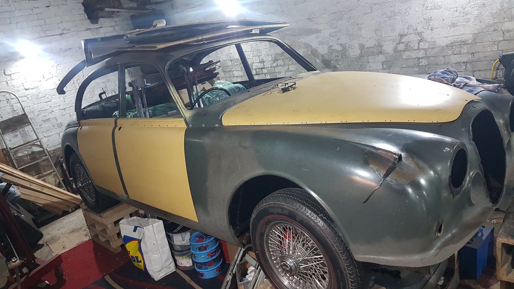

Ok guys, I give up. Ive been here all morning trying to refit the front doors. They gave a struggle coming off, but with restoration required I wasn't that careful and got them off eventually. Now, they're in good shape, I don't want to damage them. I can't seem to fit with the hinges on the doors or with the hinges fitted to the body. The manual is far from helpful. I dread to think how it's going to be when they are freshly painted. So, what's the trick that you guys have not let me know about?

Thank you all for your advice. I did manage it in the end (on my own), but it was a struggle to be honest, and there's no way I'll tackle it alone when the paint is on. I learned a lot from today, but I still have a couple of hinge-to-door bolts yet to fit, so I need to practice a bit before the doors are painted. There are enough to hold secure for the paint prep though. The door were bare Jeff, and I think if they were fitted with the windows and door furniture, I would have failed. It would have been far too much of a handful. Thanks for the links Glyn. I do have Lin's website bookmarked, but I always forget about it. It's a massive reference and more useful than the workshop manual on most occasions. So, time for a beer and relax now. Project is starting to look a bit more car-like again which is encouraging and makes me want to crack on.
