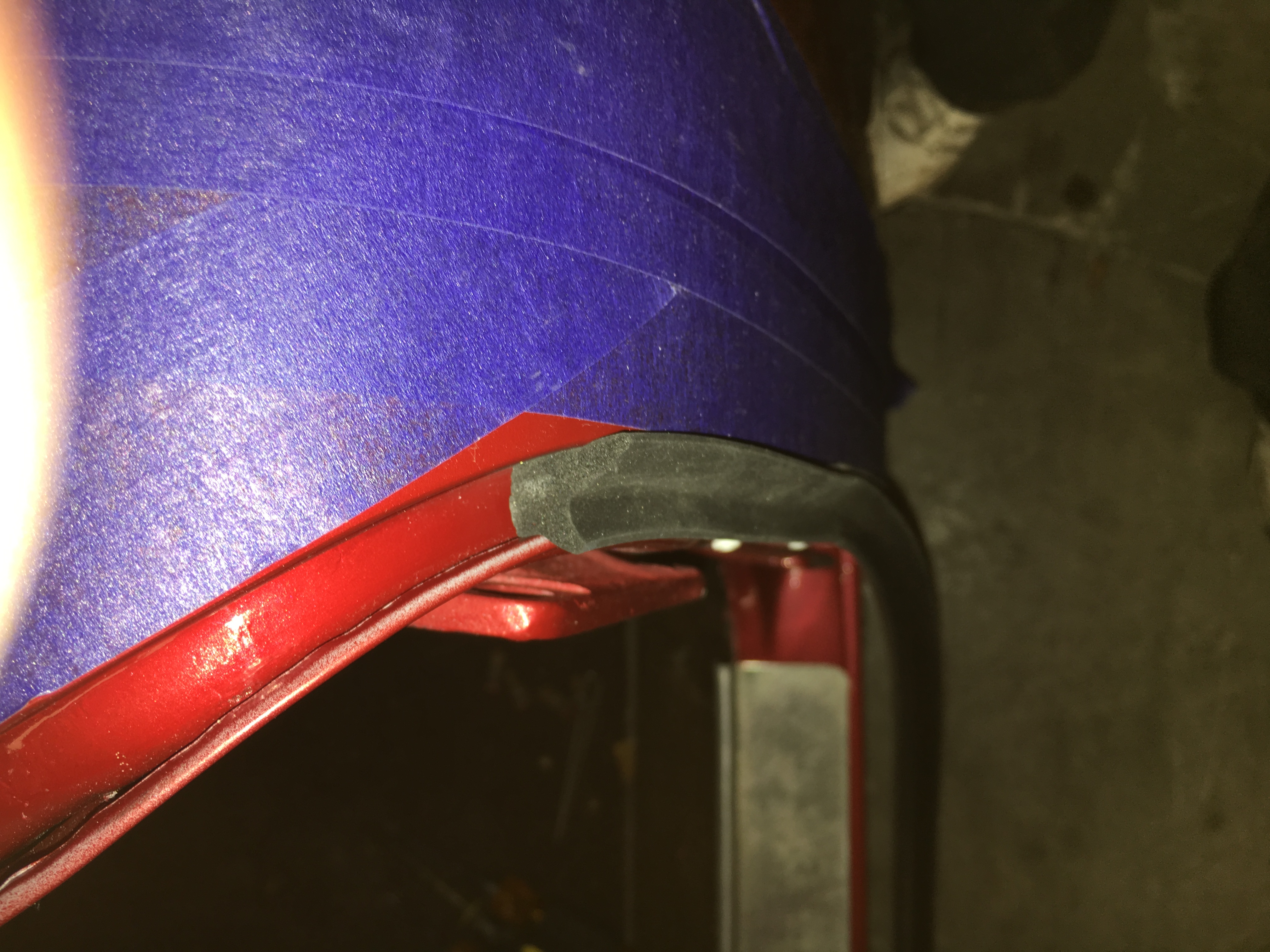

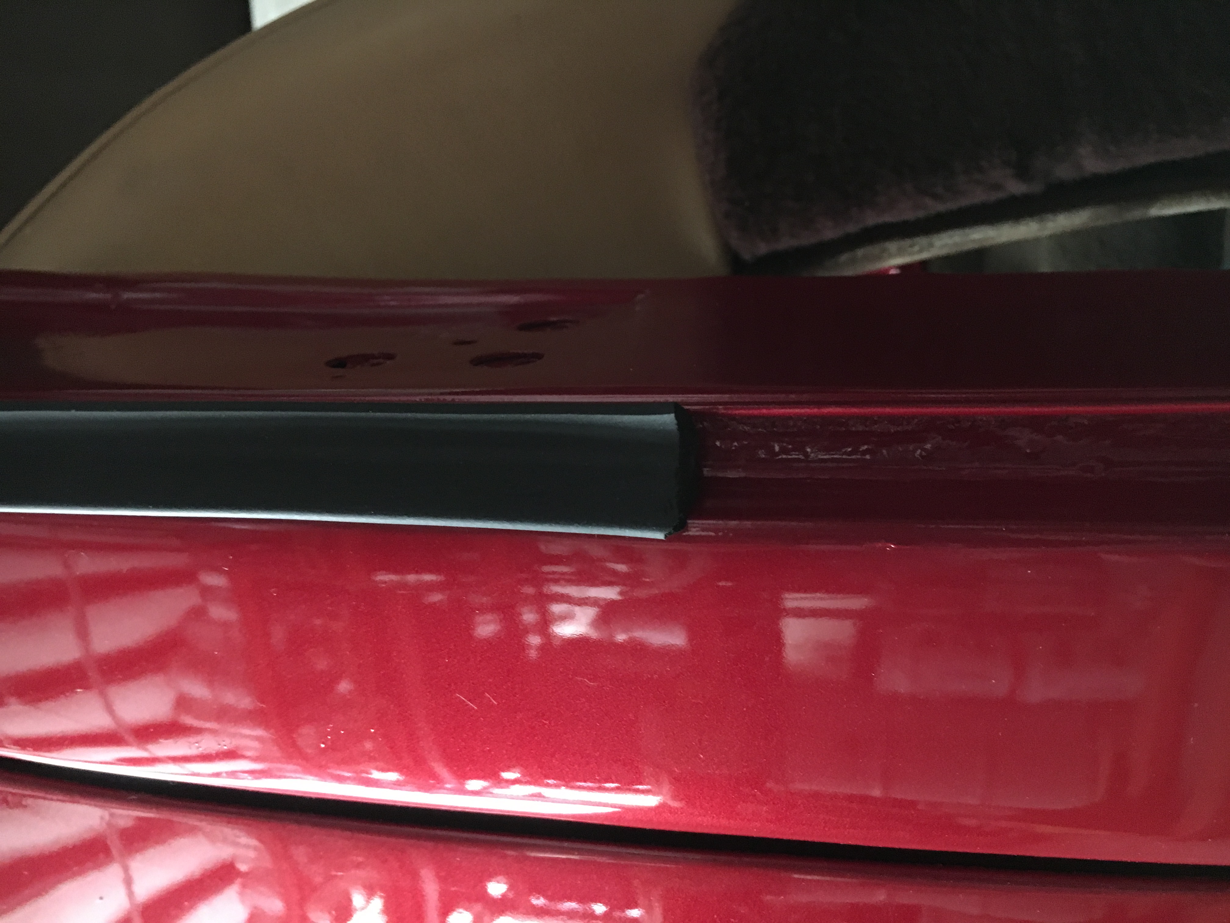

So hear is one of my dilemmas with my MK2. I bought a full rubber kit from Welsh Jaguar. A long piece of weatherstripping is supplied for the doors. Bu I cannot fathom how it is supposed to fit. It is a bit like a U shape with one long leg, and one short leg. The logic says it goes in the groove with the legs facing out. But if I try to put it at the front or rear of the door jamb, then the long leg will stick out up to 3/8" and will look ridiculous when I shut the door. The photos might show what I mean. The only place I think it will fit properly is the rear door jamb behind the chrome window surround. Anyone have any experience they could share?

Just to clarify. Photo 1 is under the door sill tread plate. It sticks out about 3/16" beyond the rocker panel. Photo 2 is the front door jamb behind the riveted on strip. It sticks out here too. Photo 3 is the B pillar. I think this is the only place it will work. Photos 4 & 5 are the rear door jamb (lower B pillar) sticking out a good 1/4 inch.

Looks like it's the sill seal rubber. The longer arm of the 'U' needs to be at the top, but the last time I fitted door seals it was the mid-80s so my memory may have failed me.

Fraser is correct (again). The longer side of the seal should be opposite to what is shown in photo 1. I used the Barratt seals and they work as well as can be expected. In saying that, I have yet to see reproduction seals that fit perfectly on any car I have restored!
