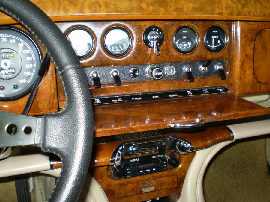

I understand your concern but the reason that replacement switches have the hex nut is that you can never tighten the key switch enough with the notched round nut, even with the proper tool, so that after a certain number of key insertions and key movements, it becomes loose again.
my S type came with the hex nut and I used a properly-sized socket to tighten it; it has never come loose again.

Your dash is beautiful, but I would prefer to stick with the original look. Thanks.
