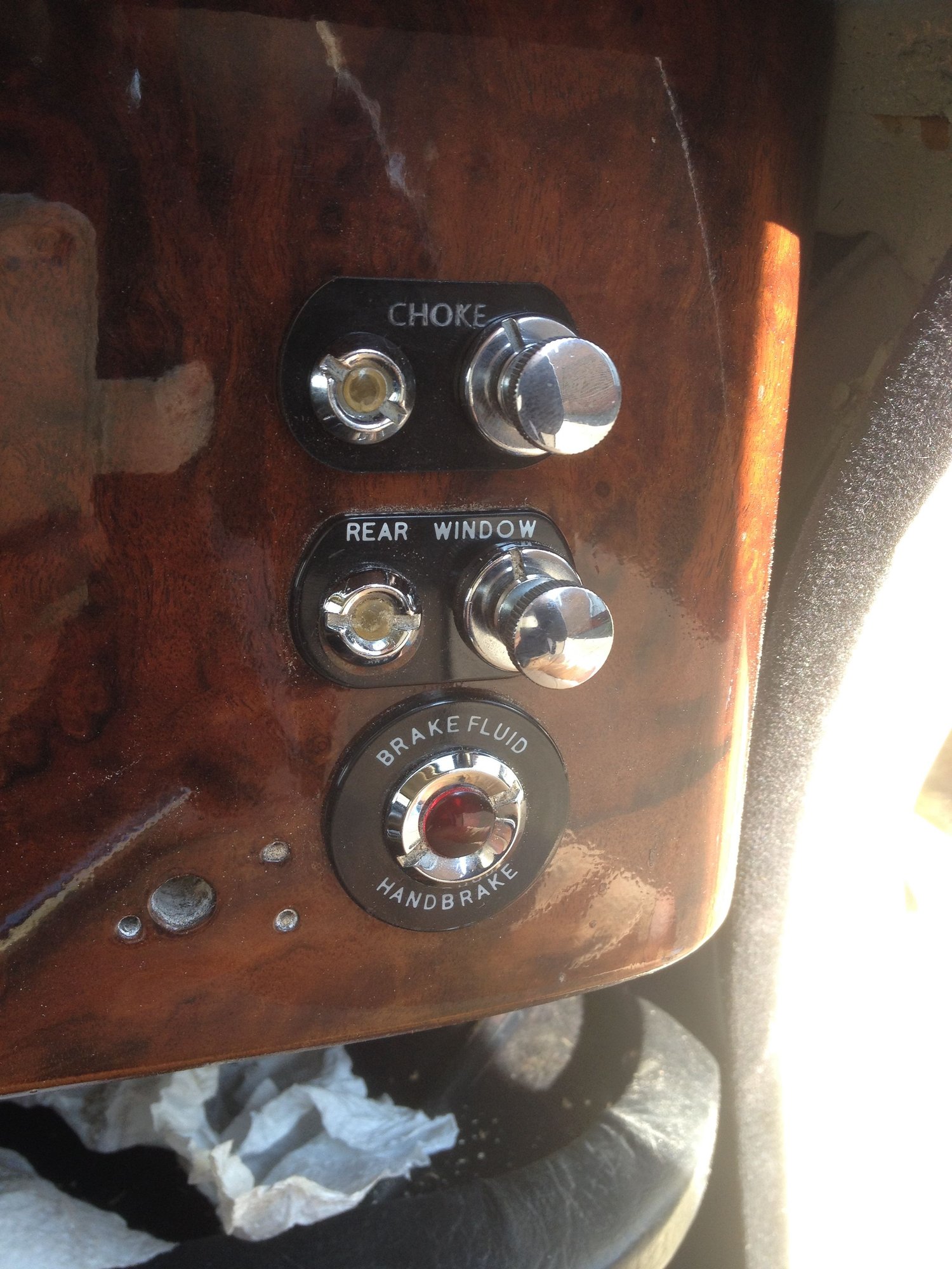

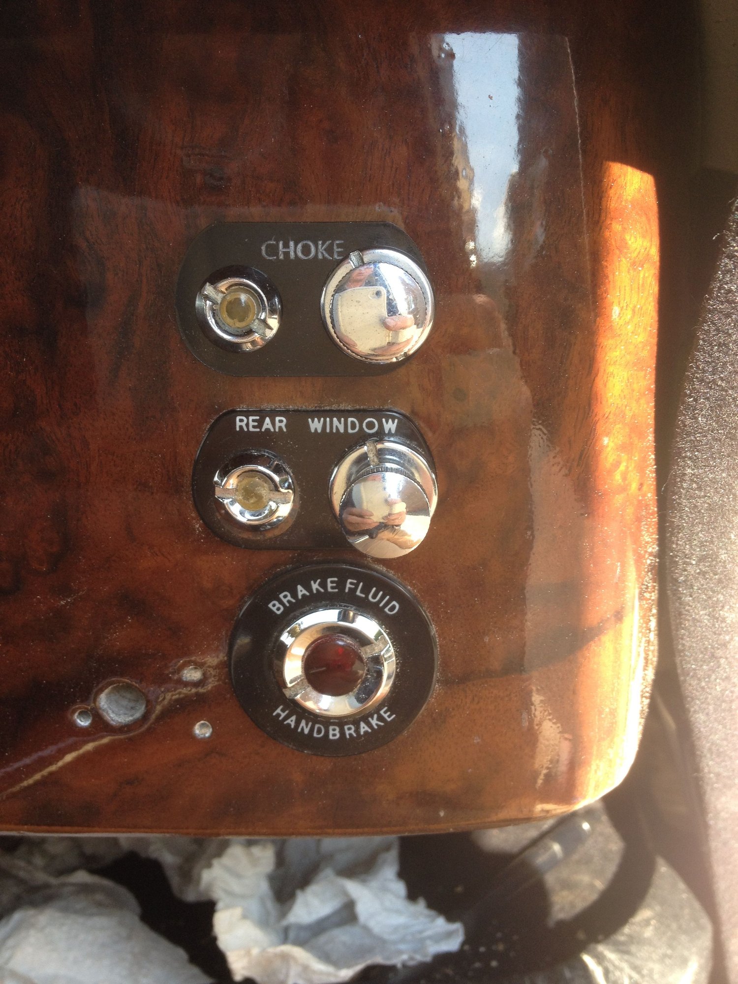

When I did my choke over ride switch I bought a second rear window heater switch, fitted this just above the original rear window heater switch and then had a new backing sign made with choke on it. Once wired up the light on the switch works when the choke is on and it looks period being a genuine Jaguar part.

good idea Cass. And I happen to have one of those switches. Who made the escutcheon?
Old Aug 3, 2022 | 12:01 PM
Cass3958's Avatar
Joined: Feb 2019
Posts: 1,599
Likes: 1,224
From: Torquay Devon England
I had them made up locally and it was as cheap to have a dozen made than just one so I have 11 left in a small plastic bag somewhere in my garage.
