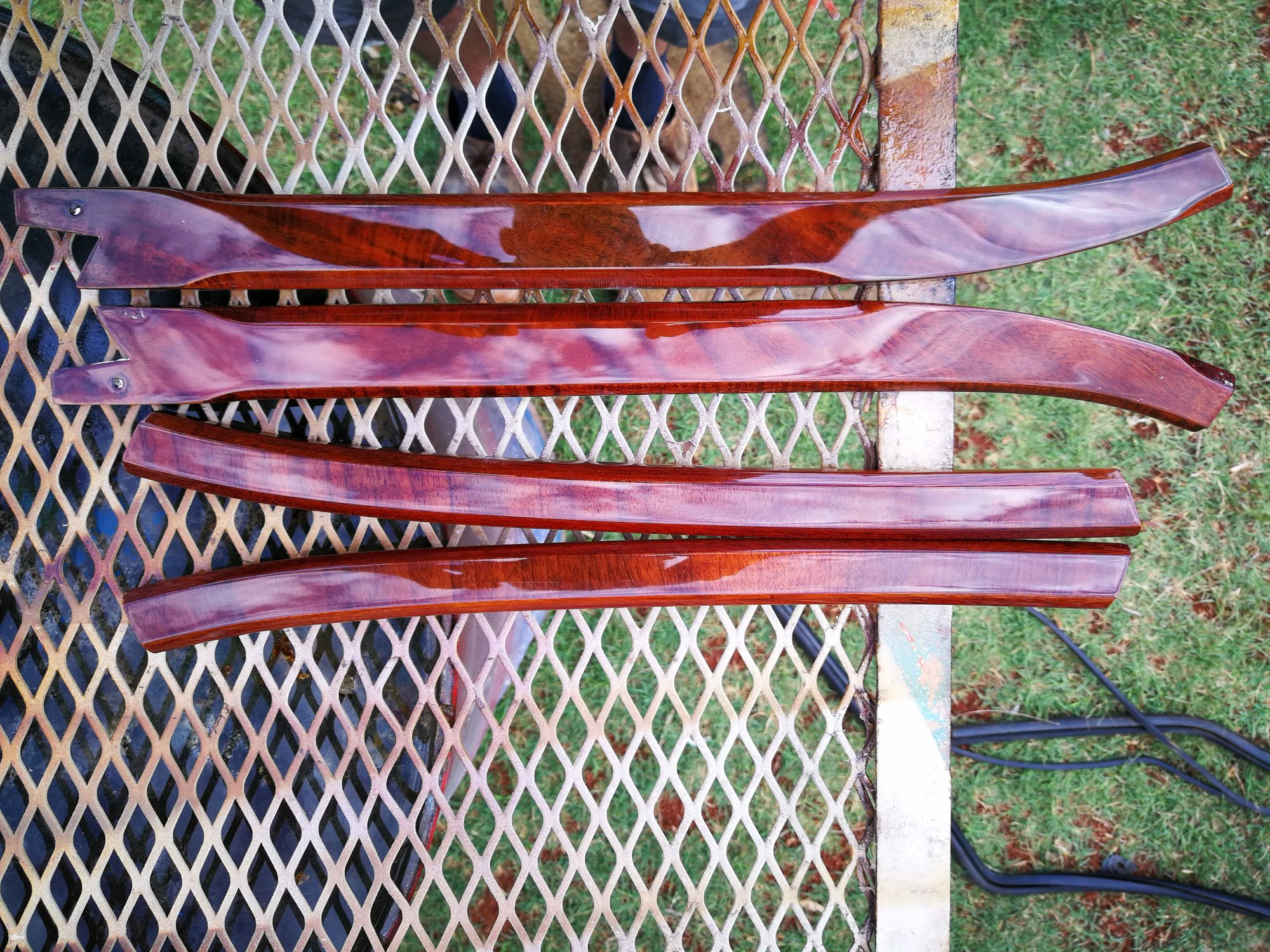

Correct Cass. Single screw from behind door seal at top in channel. Single screw at base. Don't think the dash ends get in the way but not sure. Dash top definitely does. See hole in wood for base attachment on tongue which is totally hidden.

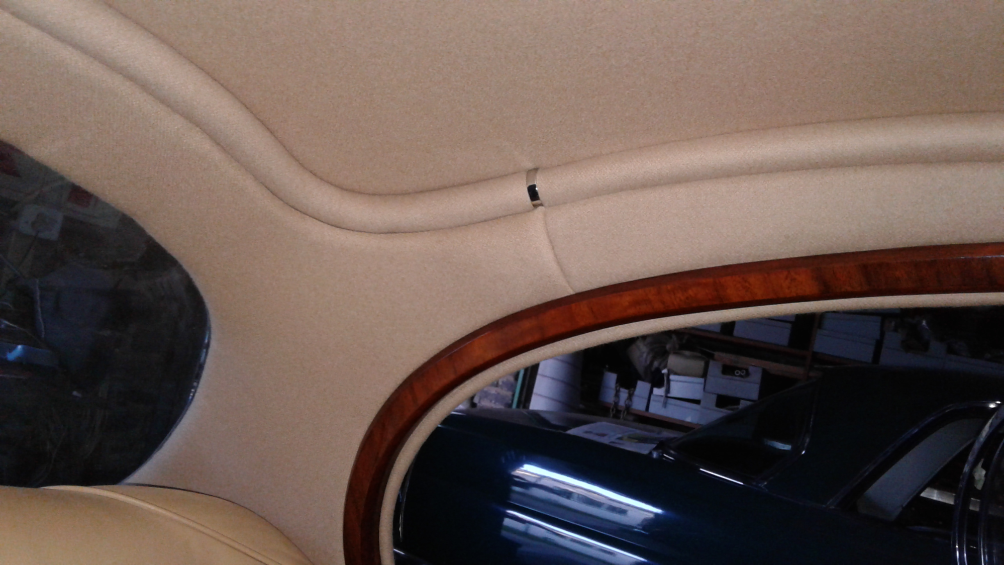

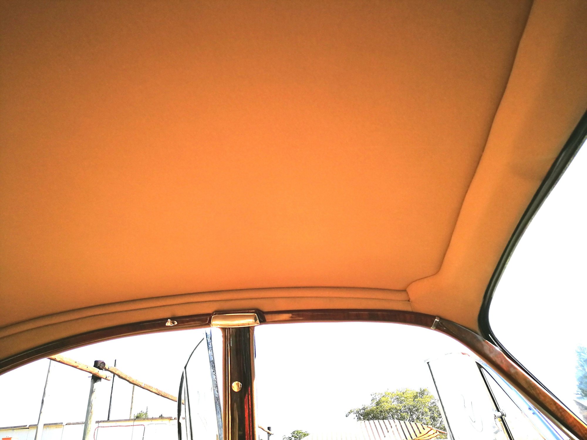

I replaced all my screws that hold on woodwork from under the external door seals with Stainless Steel. The originals rust like hell. Strongly recommend. Had a great time finding all the correct lengths so they don't come right through the wood trim but worthwhile.
