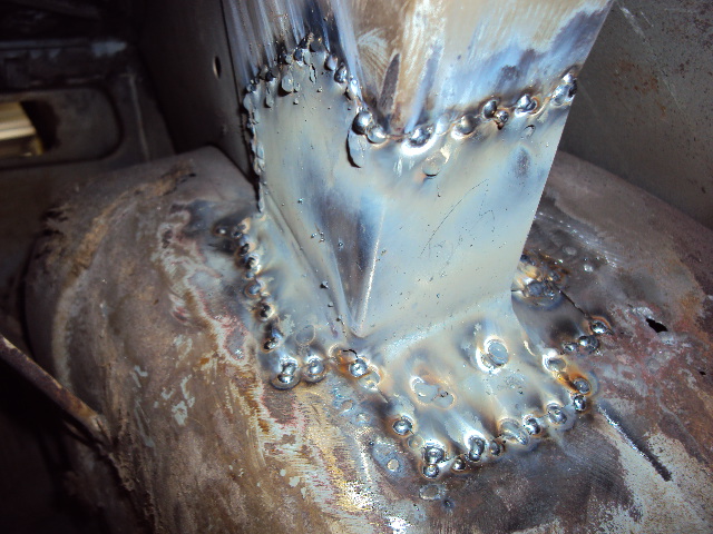

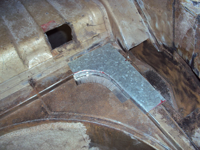

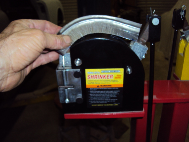

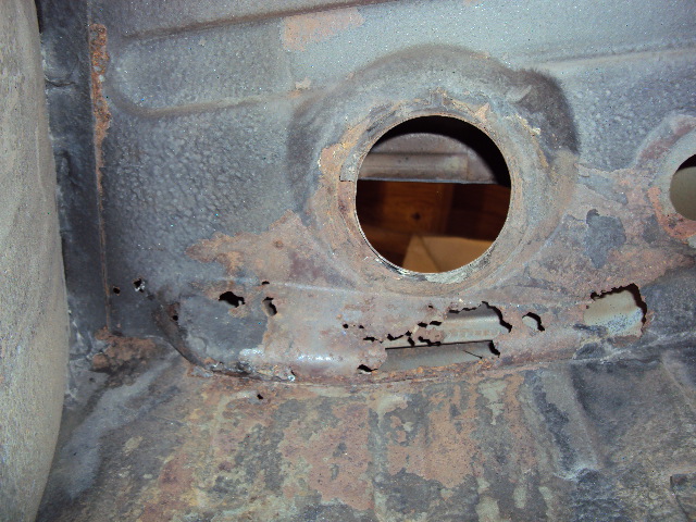

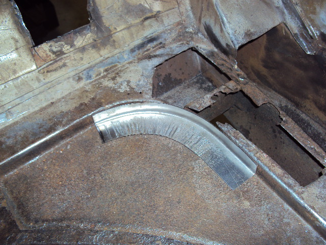

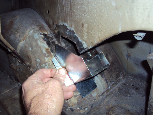

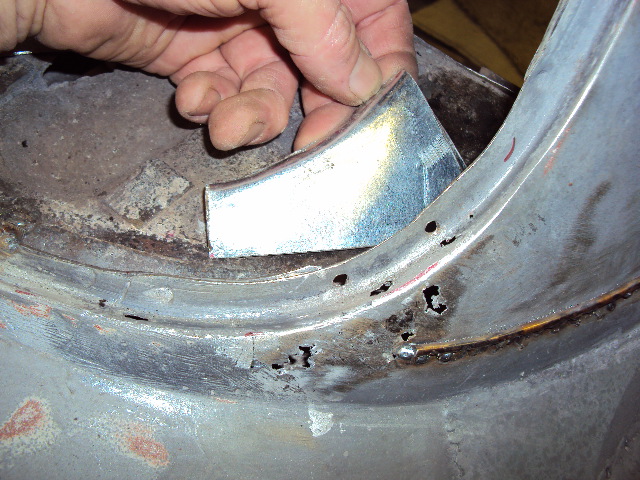

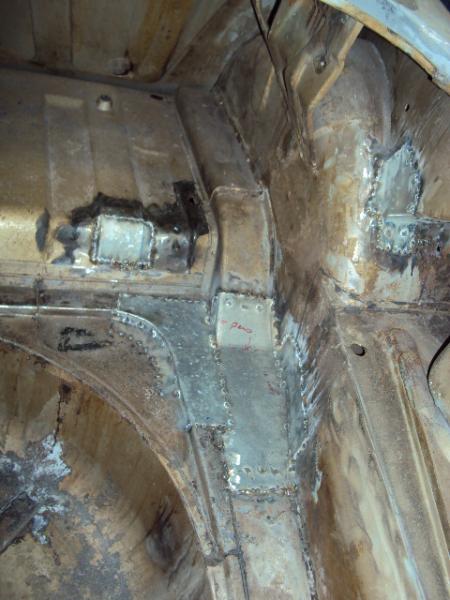

No XJ40 tunnel. (Trans tunnel?) My floors are shot so when I mount the engine/trans then I will get to that part. Still lots of rust to repair yet.
I did get the rear end brace plate from one that I may use..aka as did FiBoy in his Mark II conversion. I have been thinking of getting the XJ40 pedal box with power brake booster, but it won't leave room for a clutch mc..haven't figured that out yet. Thanks for your interest.
Making more progress fixing rusted out areas. Last photo..tomorrow's task, area underneath where gas tank goes. All this due to small holes at back window lip!
Attached Thumbnails My S-Types-dsc01421.jpg   My S-Types-dsc01422.jpg   My S-Types-dsc01435.jpg   My S-Types-dsc01436.jpg   My S-Types-dsc01434.jpg
My S-Types-dsc01429.jpg   My S-Types-dsc01430.jpg   My S-Types-dsc01438.jpg   My S-Types-dsc01426.jpg   My S-Types-dsc01427.jpg

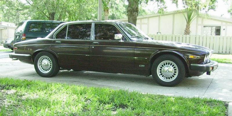

here's a picture of my '65 S type and '84 XJ-6.
I'm new in this forum but I've owned Jags for the last 23 years. My S type is a San Francisco car, totally original except for a respray in 1984, (have the receipt from the first owner) no rust. I've improved it with XJ-6 electric mirrors, headreasts, high-mounted stop lamp, and other mods.
I'm impressed by this S type Coupé bodywork you are doing. Are you going to cut / round the rear wheel openings as some other owners have done? What I would do is keep the original engine & suspension and just improve it with a better transmission and a/c. I'm in Oakland/Winter Garden.
