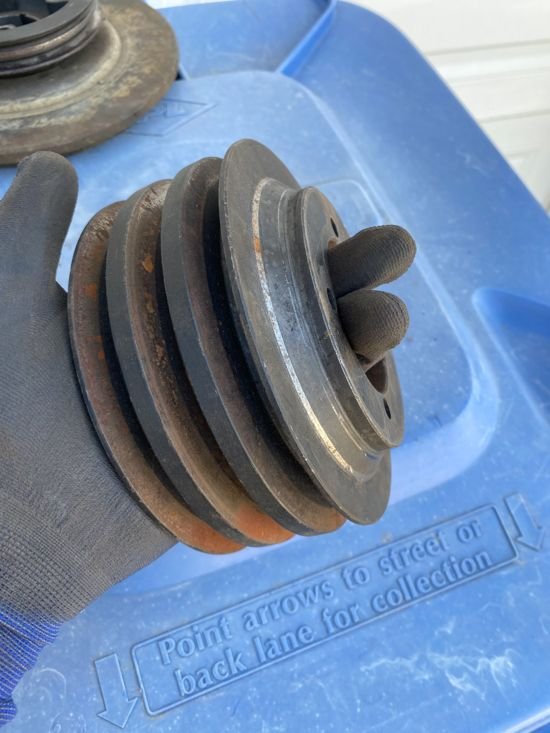

A photo of a 3.8 damper, 3.8 double groove pulley and the V12 triple pulley.

The diameter of the centre hole is 60.4mm and the bolt circle is 72.9mm. The 3.8 and 4.2 have different bolt circles ( the 4.2 is 79.05mm), however the 3.8 and the HE V12 have the same bolt circle. What you could do is buy the front pulley from a V12 and machine off two grooves and then you have a single groove pulley that is factory fit. Part number is C37892

With regard to the triple pulley C37892, why could I just machine off one of the pulleys on the triple and I would have the double of what I need?

You could only machine off one groove, whatever you need to make it work.
